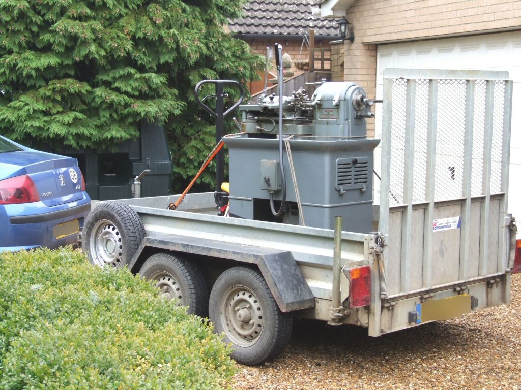

      The day started early (for me) with a trip to collect a hire trailer. First hiccup was that the lights on the trailer didn't work, and the number plate wouldn't stay in place. Both problems eventually got fixed by the company I was hiring from. So then back home, by a different route to avoid the A14 morning rush nightmare, to pick up a pallet truck. Then onto the collection point, in a village about 10 miles away, up a series of rather narrow Victorian streets.
      It took about 3 hours to get the lathe onto the trailer. The move wasn't far, but it was up a step, through a narrow door and over a sloping gravel drive. I then drove home, slowly as the trailer towed badly. It seemed to hunt quite a bit and the fuel consumption was awful; much worse than my bigger and heavier glider trailer. Here's a picture back home, and mighty relieved I was too to get there:

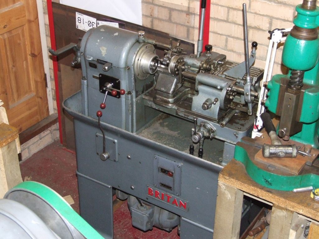

      Here's the lathe in more or less it's final resting place, off the pallet truck, but still on rollers, as I need to insert the coolant tank and wire up the three phase electrics on the back before finally setting the lathe in position:

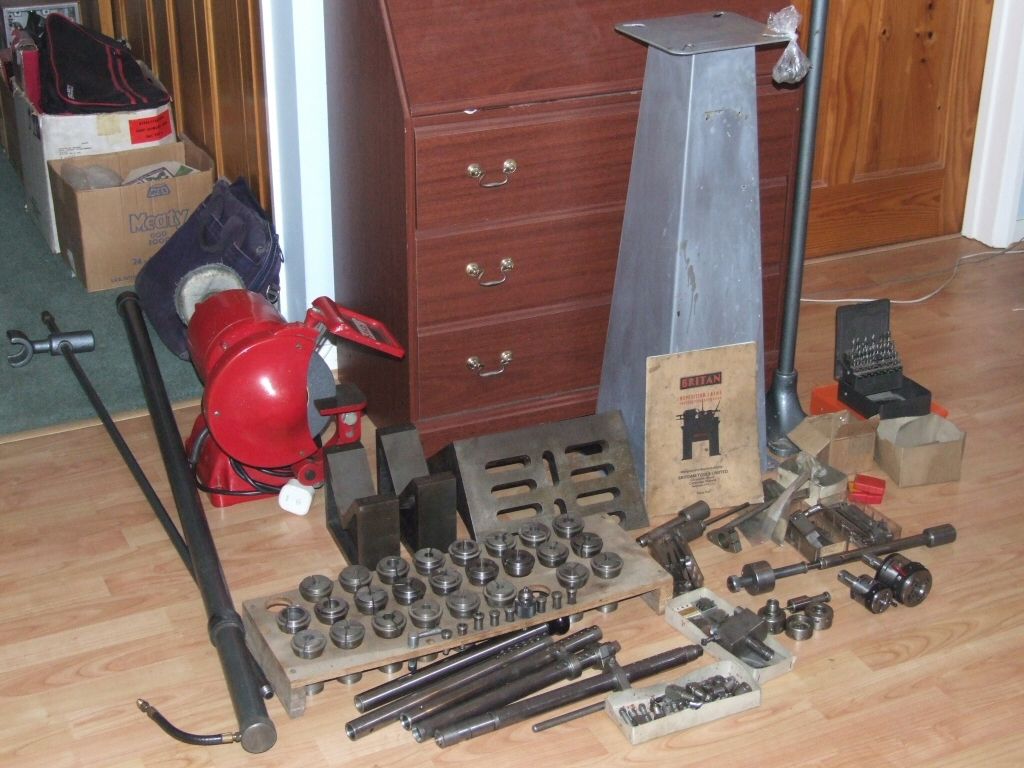

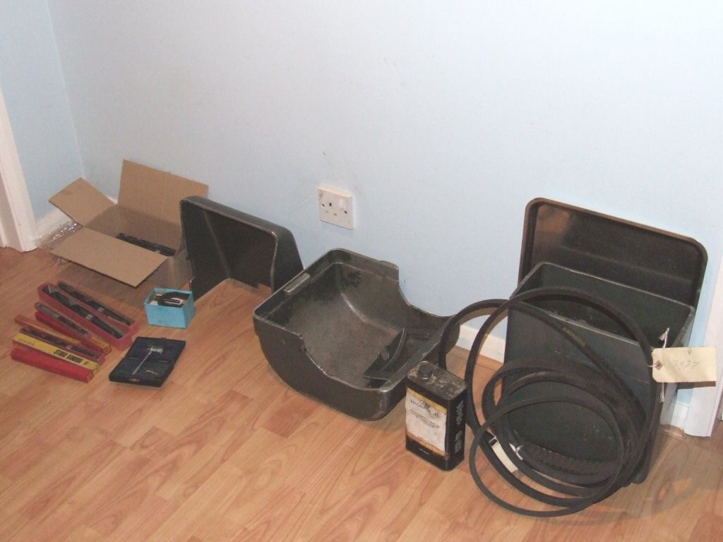

      The lathe is a Britan repetition lathe, and came with lots of accessories, including round, square and hex collets, a knurling tool, die and tap holders, lots of left hand drills and a couple of nice Coventry dieheads. A lot of the tooling is special to the Britan, so the lathe wouldn't be much use without it. Here's the tooling, the pneumatic bar feeder and a Wolf grinder, angle plate and big V-blocks that I also collected:
      I also collected a few Morse taper drills, some small V-blocks and a dinky internal micrometer, as shown here plus some more bits for the Britan, including spare belts, which is good, as I expect that they're now unobtanium:

              Nice lathe
              It looks like a 1 1/4" one.
              Re: belts. These are changed in matched sets.
              Re: tooling. Looks like you have a complete set. I can see what looks like a 'through the spindle' back stop. We also made up some collet back stops as well.
              Re: barfeed. It looks like the bar feed has been shortened. I would have expected to see one around 6' long. The air pressure in these pnuematic bar feeds is very low. Do not expect the on board air pump to have any more pressure than a can of coke. It works fine on very low pressure.
              Re: weight. A lot of the weight is in the man size electric motor underneath.

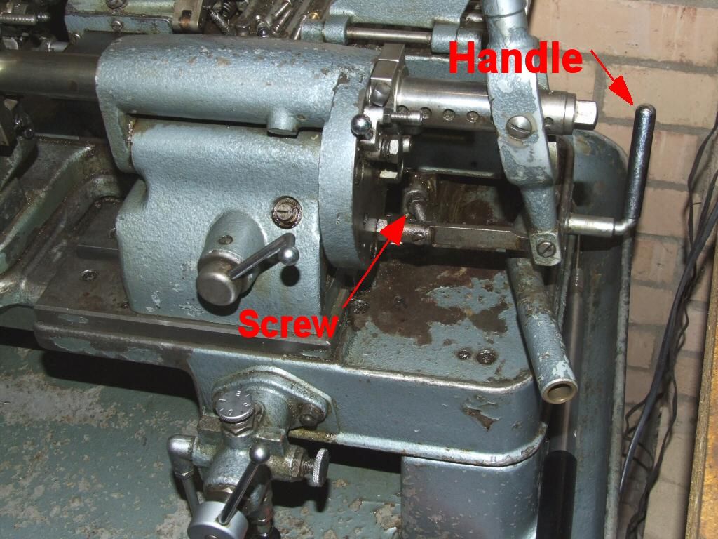

                            I now have another operating question. The manual states that the turning tool capstan unit can be set to turn either two different tapers, or one taper and parallel. Here's a picture of what I think are the relevant controls:
                            I see how the item labelled 'screw' can be used to swivel the capstan unit to enable a taper to be cut. There's also an indentical screw on the back of the capstan unit. What isn't clear to me is how you get two tapers, or one taper and parallel. All I can think of is the the front and back screws are set differently and the item marked 'handle' is used to change between the two limits. Is this correct?

                                  Re: Tapers. Yes you are correct. The one on the rear is normally used for parallel turning and the front one for taper turning. The rear one will allow a little taper backwards but the front is far greater. I used to set mine up with the handle 'pointing' in the direction of the stop being used. Helpfull, if the taper is a slow one and it's not obvious. Helps to prevent scrapping the part.
                                  You can set both up as tapers if required. If it's only a short taper, it's far quicker to knock up a form tool and of course much faster to use if you need a couple of hundred items. On Stainless steel (and the like) you would (if you had spare tool spaces) use a roughing tool first. As I would on hex bar, to knock off the corners first.

                                    Dave: Thank you for confirming that I've understood the taper setting mechanism, and the advice on using it. I feel confident that I can experiment with it now without fear of breaking something. It's going to be an interesting challenge to work out the best way of machining parts. Even a quick look at the manual shows that one correctly shaped tool can form several features at once. It clearly requires a different way of thinking.
