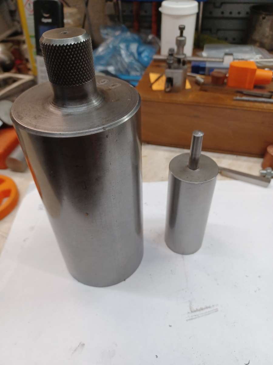

                        Unfortunately I don’t own a granite square and I have not heard of a bottle square, what is one of them?
                        I will check with the square that i do have which is about 6″ which is about the best I can do. Although don’t think it would make sense at this moment as the ways on the knee which would be the reference surface are worn.

                                  This is my Bottle square and a smaller one as well. useful to check squarnes by sitting it on the base and with some engineers blue on a section of the diamier to touch onto the side face and feeler gauges to check any gap. yo can also use it  to clock with a dial indicator on the bed.
                                  20240620_175943
                                  David

                                    looks like a handy bit of kit. Cheers for the info
