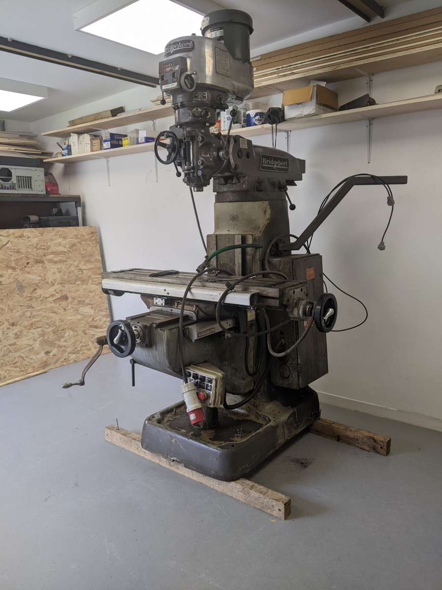

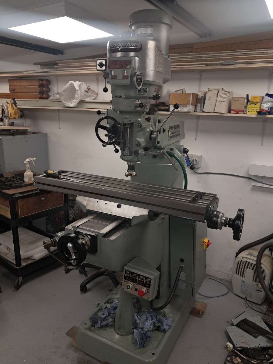

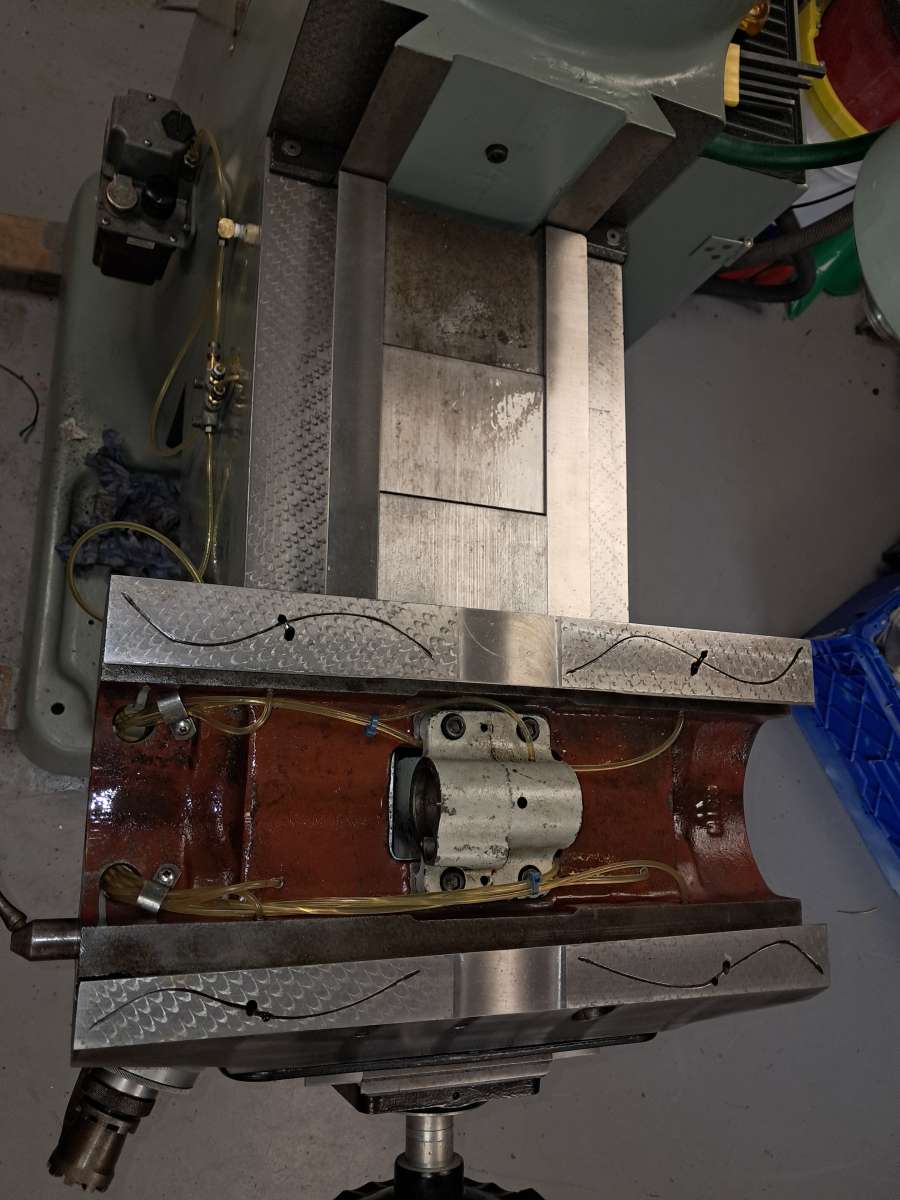

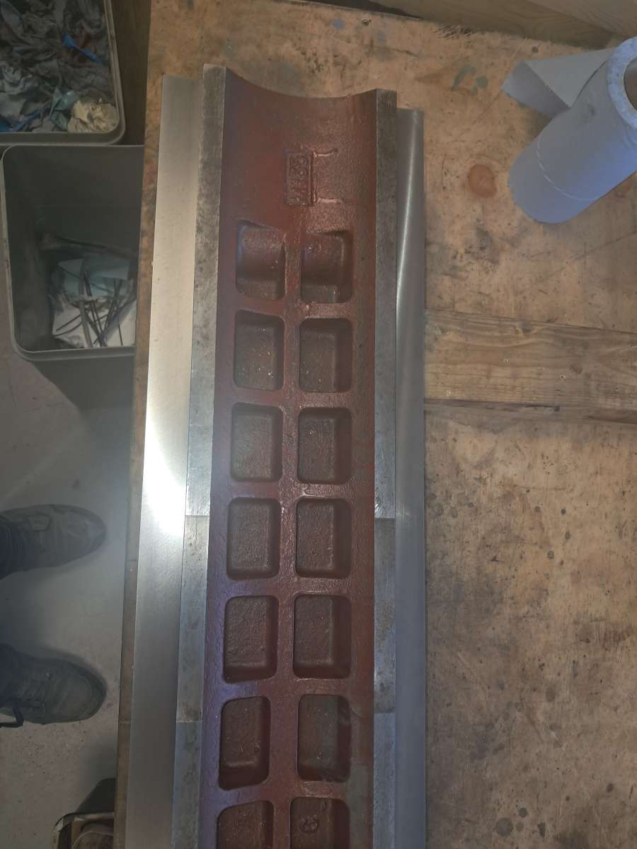

        Hi just a quick update, got all the castings back (knee, saddle and table) and they all look spot on. He charged me £900+vat for grinding all they ways except the column ways. Turcite on the gibs that needed building up, fit and scape/flake the gibs and ways. Fill some holes in the table done before i bought the machine and regrind top and sides.
        Nearly all back together now, all fits are good and putting a clock and measuring the rock between each mating surface getting in-between 0.00 and 0.01mm on the clock. Don’t have a clock that reads lower. Used this method of measuring, more of a idea of what is happening than a measurement.
        No complaints about the work or service i received, only downside was he was very busy so i had to wait a while but he was upfront about that from the beginning.
        Also when I picked the castings up I spent a couple of hours with a list of bits i needed and searching for them with him in his spare parts collection. Quite enjoyed looking for stuff and chatting tbh.
        please find some pics, included the machine when first purchased.
        PXL_20240517_12220905620250925_14173520250925_16135220251003_155638Cheers, Ian

          A very nice job of the scraping/flaking.  I hope you flushed out the oil galleries. Keep oiling every 2 hours or before each use and it will last a lifetime.

            Yeah all flushed out, also changed the oil, lube lines, metering units, cleaned the filter and new way wipers made from TPU with a bit of a squish fit. Don’t want to ever have to do it again. The lube tank will be pumped before every use and it also has an electric motor to automatically pump oil every hour or so. Tested on the bench but I’ve not wired it in yet.
