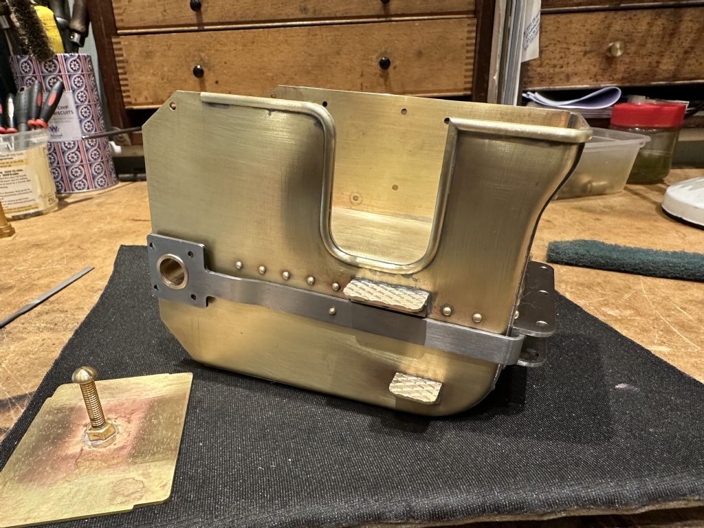

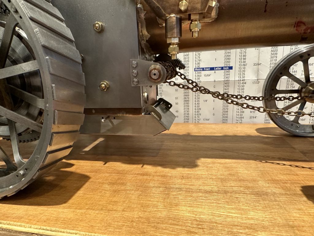

          Ash pan and damper sort of complete, need to make the linkage and a few other bits but its nearly there,
          Going to move onto the tender for a while, need to solder this up and make water tight, then add the beading.

              Good evening all.
              Need some help regarding this one.
              Beading the tender on the Minnie, left-hand side the beading needs forming around the driver entry/exit cut out.
              Tried forming it by hand but it's not working, wondered how others managed it.
              Thanks
              Brian
              #644350
                You just need to keep bending a bit, flatten, bend a bit more and so on.
                If you can't manage that then turn a short "ring" on the end of some bar, round the end over to match the beading profile and part off. You can then cut two corners out if the ring and just run straight lengths upto them

                  As purchased, half-round beading is quite hard. I'm fairly sure that I would have annealed the beading for my Allchin tender. Heating towards dull red makes it much more amenable.

                      Brian Abbott
                        @brianabbott67793
                        Thanks Jason and Clive
                        Turned a couple of diameters to help form the beading,
                        that with lots of annealing seemed to do the trick.
                        To answer Django, i only have a few hours a week, that together with all
                        the messing about is why it’s taken so long, i would have thought if you set your mind to it then you could build one in a fraction of the time.

                          That looks good Brian.

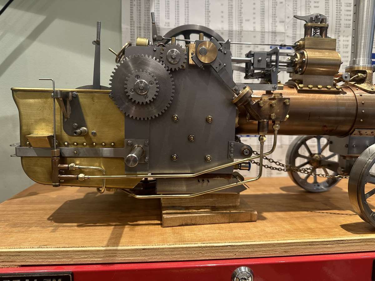

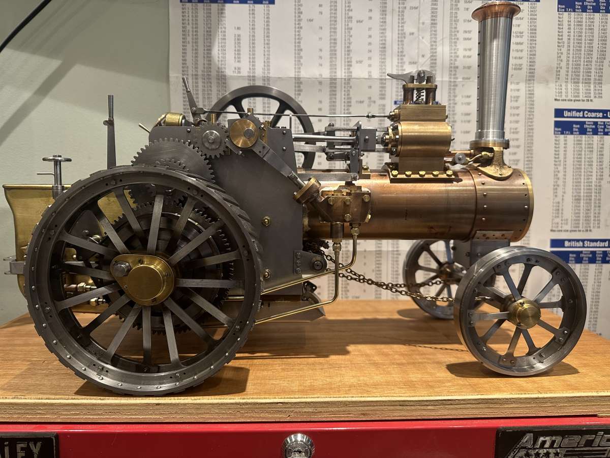

                                          Brian Abbott
                                            @brianabbott67793
                                            Just completed the pipe work feeding the water pump from the tender.
                                            Looks neat, but not sure if it looks right?
                                            What do you think?
                                            IMG_5566
                                            #729513
                                              A lot gets hidden by the final drive. With the two connections at pump and bypass being in line you will always have to kick one pipe sideways to miss the other.
                                              Mine run closer together, though if I were doing it now they would be horizontal and parallel to each other forward of the wheel and I would do tighter bends, but I did not know any better at the time.
                                              DSC00164
                                              #729545
                                              Brian Abbott
                                                @brianabbott67793
                                                Thanks Jason,
                                                As you say, once the wheels fitted there’s not much to see so may just leave well alone..
                                                IMG_5568
