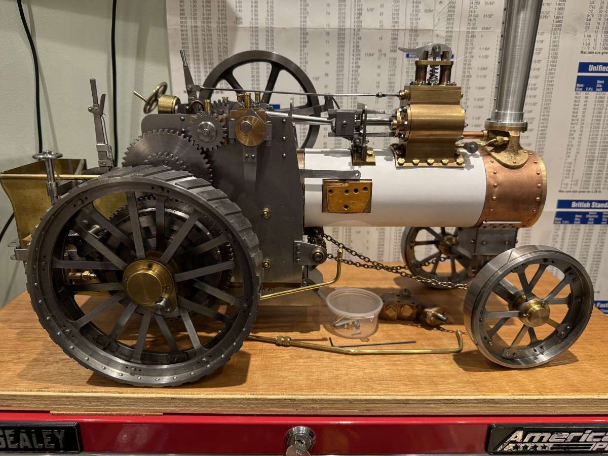

    Brian Abbott
      @brianabbott67793
      Thank you both for the reply’s
      IMG_7086

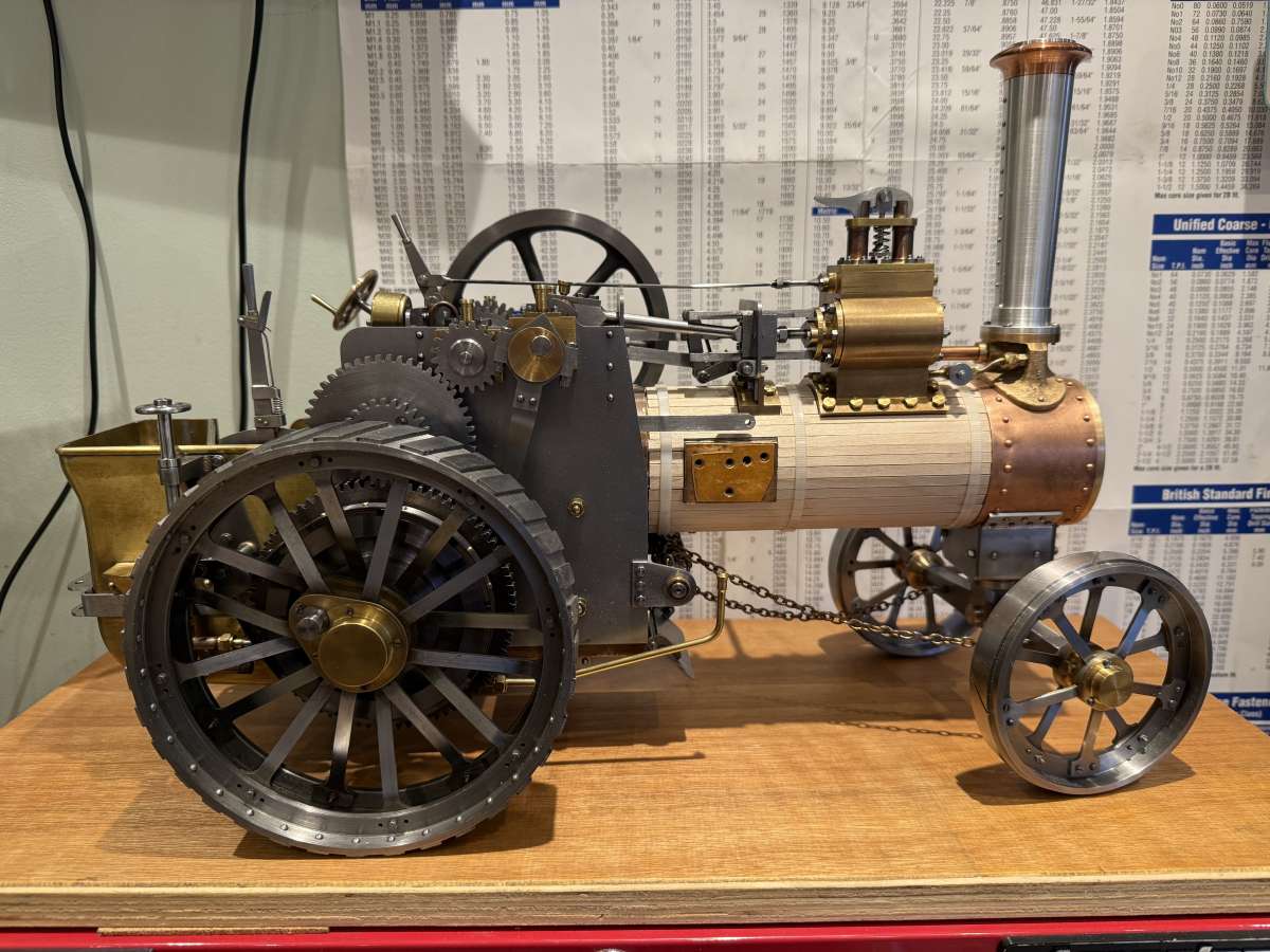

      Plasma
        @plasma
        Brian,
        I’m new to this thread but I think that looks amazing my friend!
        The piping to the tender looks fine to me the way you did it.
        Things takes as long as they take, I know Django is concerned about having enough time to complete a mini.  But if you have to put in full shifts every day the hobby will soon start to feel like a job.
        I’m building a kit model which could be completed from box to unpainted built in 24 hours. But I’m modifying and making new parts so it’s going to take me at least a couple of years of hobby tinkering to finish it off.
        You’re doing a fantastic job, can’t wait to see her finished.

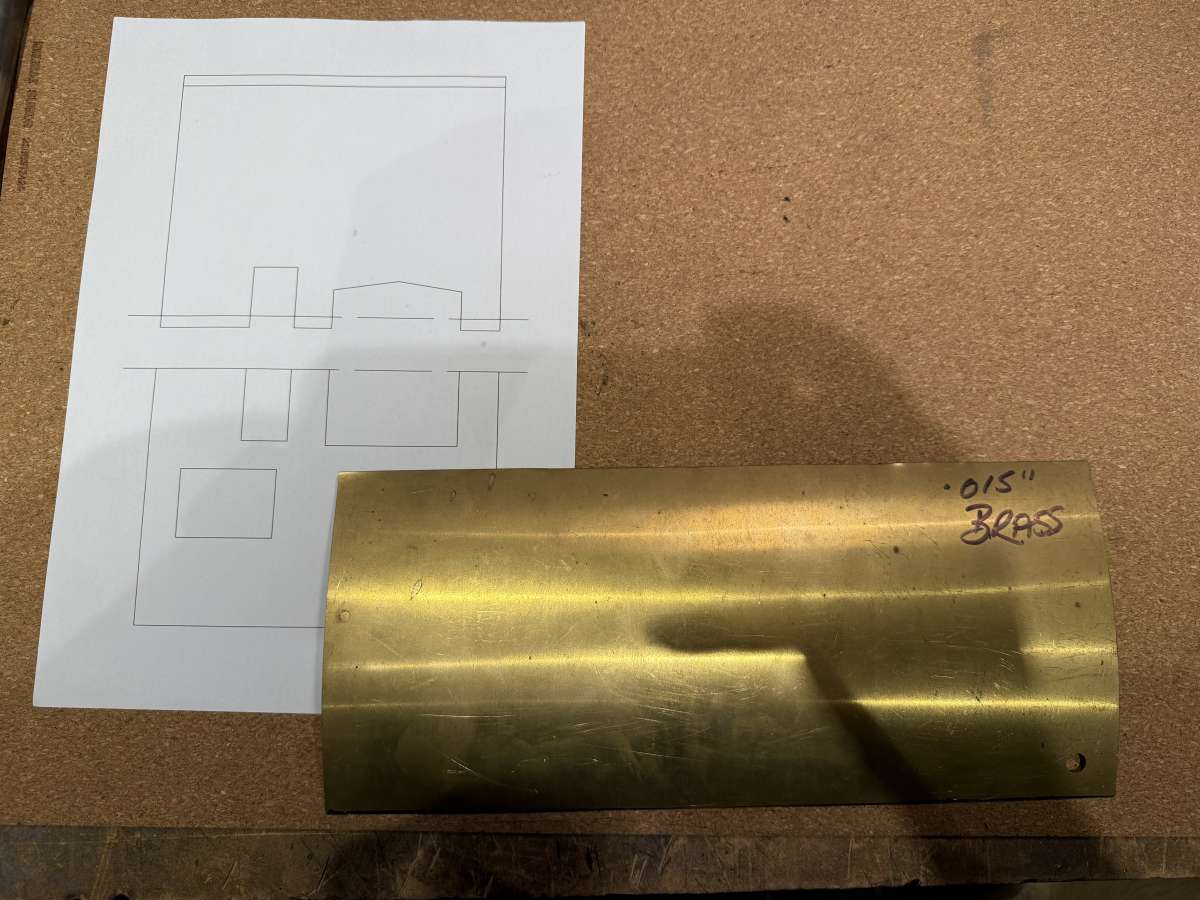

        Brian Abbott
          @brianabbott67793
          Thank you Mick
          Paper template made for the cladding, need to transfer onto the brass.

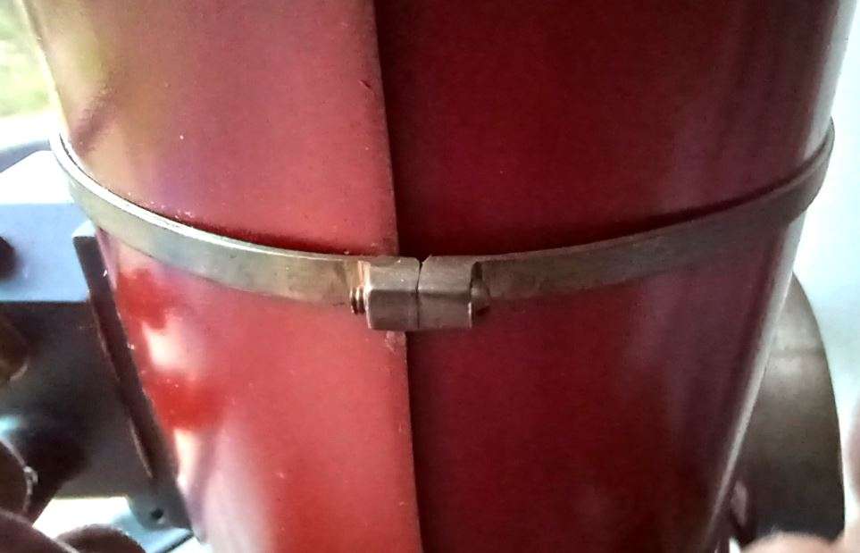

                  Could i ask how you clamped the boiler banding on your engine?
                  Did you drill and bend the ends ?
                  Thanks
                  #781947
                    looks like I soldered a couple of 1/8″ square blocks to the ends of the banding.
                    banding

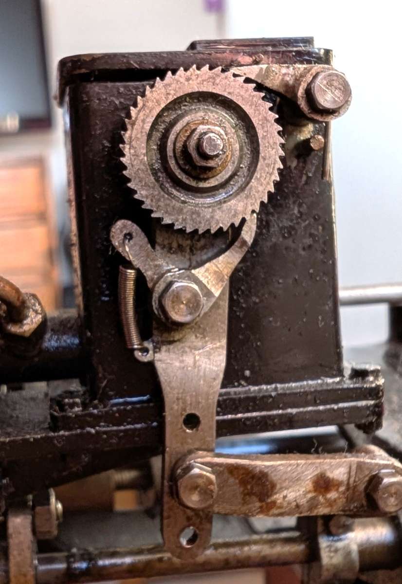

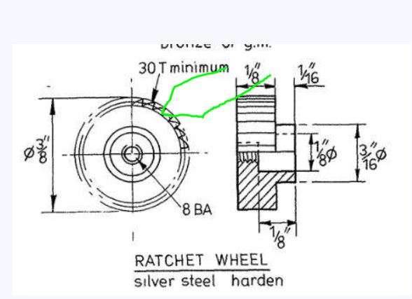

                      Brian Abbott
                        @brianabbott67793
                        Hello All,
                        Anyone any tips on how to make the ratchet wheel on the Minnie Lubricator ?
                        Thank you.

                        #799097
                          Make a small flycutter/single point tool with an acute end and proceed as if you were gear cutting.
                          ratchet
                          #799103
                          bernard towers
                            @bernardtowers37738
                            Can also be done with a standard end mill, just change the shape of the pawl
                            #799107
                            Andy Stopford
                              @andystopford50521
                              I think I used a dovetail cutter on the centre line
                              #799112
                              Clive Brown 1
                                @clivebrown1
                                Here’s my 40t Allchin wheel, 1/2″ dia. Cut by grinding an angle on a 1/4″ square hss toolbit which is held in the lathe toolpost and using the carriage as a shaper. The lathe spindle was indexed using a changewheel. Quick and done in one chuck setting.
                                Ratchet
                                #799125
                                Andy Stopford
                                  @andystopford50521
                                  Having had a look at it, I think I set the edge of the dovetail cutter a bit below the wheel centre line to give a slightly hooked effect to the teeth.

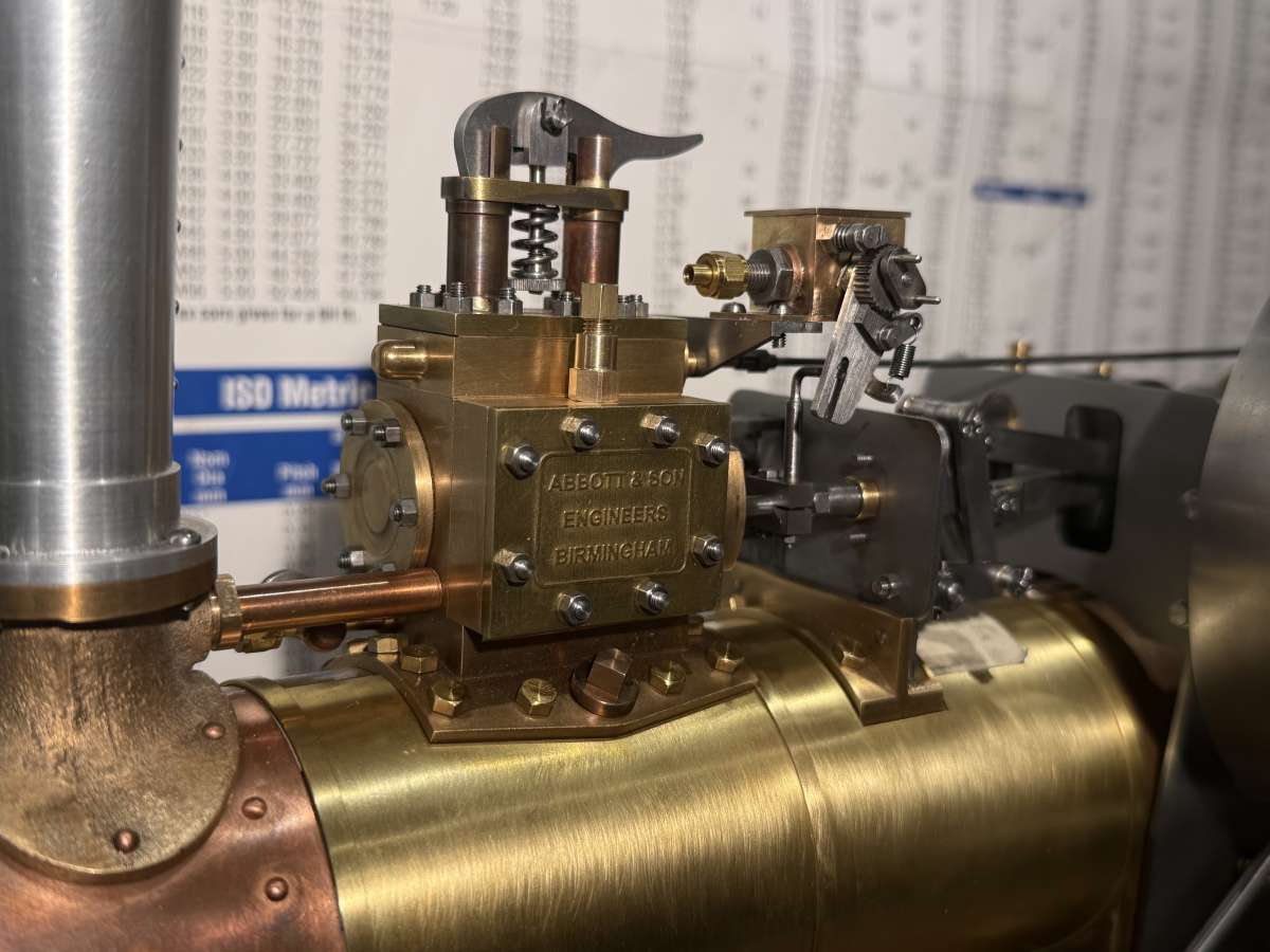

                                      Hello everyone,
                                      So i have completed the lubricator,
                                      Decided on a 33 tooth ratchet wheel bit doesnt seem to ‘click in’ on a short stroke so need to make a new wheel with more teeth.
                                      What have other people used ?
                                      Thanks
                                      IMG_8405

                                          Before making a new wheel, it may be worth unbolting the lubricator from its mounting and moving it back and forth slightly while running the engine on air to see if there’s a position where it will work. Then either slot the pump mounting holes or move the actuating arm on the valve rod.
                                          #818951
                                            The main problem is the top pawl has so little weight that it can just ride up and not engage the ratchet so the moving pawl’s spring just keeps it engaged in the same tooth rather than moving to the next. The top pawl really needs an extension towards the rear to give it a bit more weight.
                                            Try it fully notched up to get the most arm movement with light finger pressure on the top pawl and see if it works then.
                                            Easier than making a new gear is to extend the slot in the arm closer to the pivot and make a longer bent arm, that way you will get mor erotation for the same amount of valve rod movement when not fully notched up.

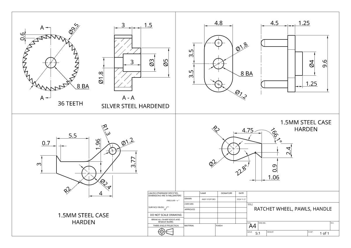

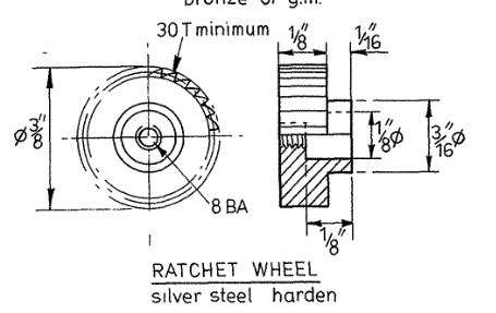

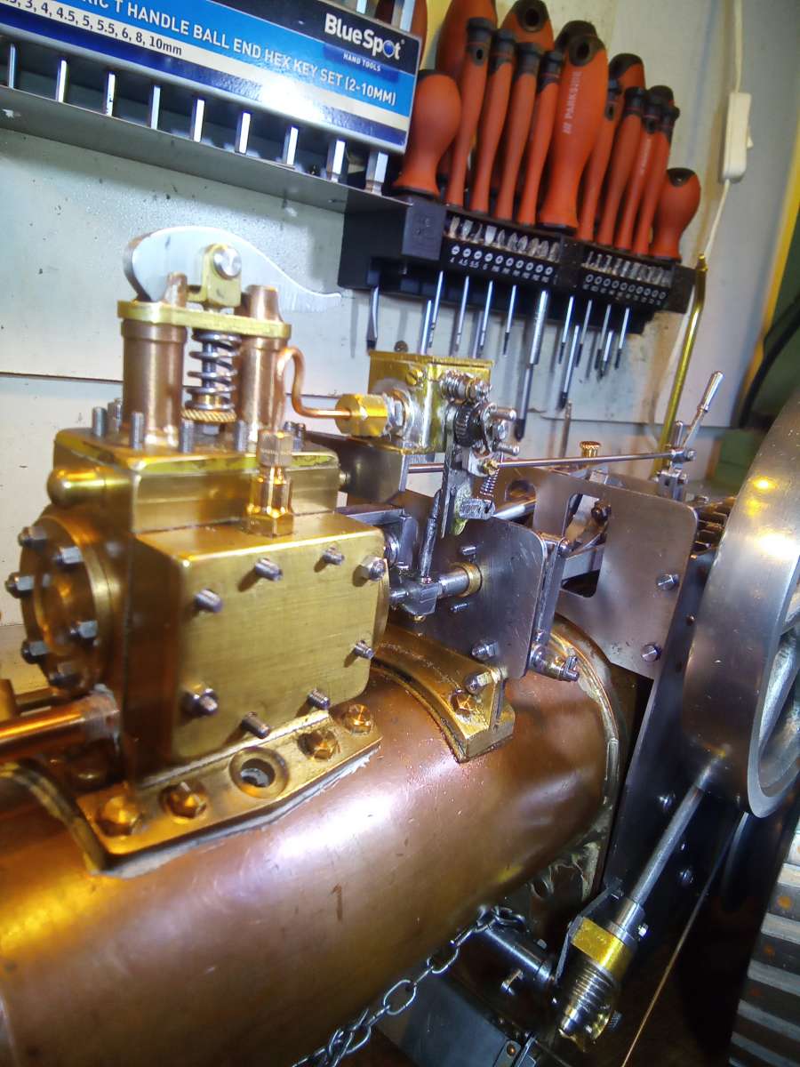

                                            Andy Stopford
                                              @andystopford50521
                                              As Jason says; in the photo below I’ve fitted a spacer to raise the bent arm, and given it a fore and aft bend to get the best possible action and as you can see this brings it up to the top of the slot, and it still doesn’t reliably deliver at all cut-offs.
                                              I’m going to extend the slot as far as possible and make a new bent arm after a bit of test running to confirm the best dimensions.
                                              20251006_122041
                                              For what it’s worth, the ratchet wheel has 36 teeth; here’s the drawing:
                                              RATCHET WHEEL Drawing 1
