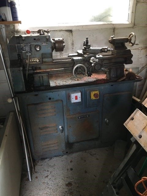

                Here is the picture of the lathe, I think its a BUD but I am not 100% sure

                  What may be handy to know about – and someone had to point them out to me – are the two pairs of holes at each end of the cabinet through which you can pass some stout metal bars or pipe for lifting. You can just see the front ones in your picture, more or less directly below the lathe feet and virtually up against the underside of the cabinet top. Then if you have a hoist or some sort of lifting gear it becomes a doddle.
                  If you do decide to remove the headstock (and I was advised this was OK, and would not destroy the alignment) then you'll need to shorten a spanner to get at the bolt at the chuck end – it's a fiddly job as you only get about 10 or so degrees of turn before having to flip the spanner over.
                  Two of us got the cabinet (minus motor) into the back of a Landrover, similarly two of us could lift the lathe in after it. When I came to get the lathe back onto the cabinet, I only had my wife to assist, so removed the headstock to make it manageable.

                    As mentioned above the whole lot can be lifted as one with an engine hoist or similar using the lifting holes in the cabinet. When I collected mine I didn't have a hoist so seperated the lathe from the cabinet (you have to disconnect some limit switches, uncouple the linked drive belt and undo the bolts) then 2 of us lifted the lathe into my van and slid the cabinet up some ramps and into the back

                      Thanks for all the info. This is a really good forum. I think I will look to hire an engine hoist for the day as I am not too confident in disassembling so would like to avoid if possible. But it is good to know how to do it if I can't get it out as a one piece.
                      Does anyone recognise the specific model of Boxford?
                      Is it a BUD mk I or II?

                        Lathes.co.uk is your friend for identifying. But it looks like a Mk 2, maybe 3 – it's not a Mk 1

                          I have doubts that the average engine hoist is going to lift the whole caboodle high enough to load it on your trailer. Lifting from below the centre of mass can be tricky!
                          For heavy objects, I generally used an inclined plane to load/unload if lifting equipment was not available. Usually had the use of a winch but have heaved them up with ratchet straps on occasions.
                          Raglan lathes (175-185kg) without a stand have often been shifted single handed in a small hatchback (Pogo 205 or Citroen Saxo). Motor, carriage, tailstock, gear cover and chuck removal makes life so much easier.🙂

                              I lifted one recently using an 2T engine hoist in the 500 kg position (to give it more lift). It lifted high enough to get the lathe onto the bed of my trailer that is 24" high. The lifting straps did have to be very short to help it achieve the lift height required.

                                Boxfords are only about 400lb. The bed has a gap between the shears so you can put a strap through that below the chuck, round a bit of 2×4 and back up to a hook where the chuck was before you took it off, Then put a rope through the spidle to pull the strap close in to stop it sliding down the bed. Then put a rachet strap from the hook to the tailstock end to pull up that end. Make sure the taistock is firmly locked. wind the saddle along to balance the load.
                                If the trailer is wide enough I'd lay it on its back as not many trailers have decent tie downs to hold it vertical. If you do have it vertical i suggest some 2×4 to make lots of side brace triangles. Dont strap it to a pallet – they flex like crazy under this sort of load.

                                      I put mine on a trailer with a standard 1 ton engine hoist that the seller had. Tied it down to the trailer standing up with 2 lorry ratchet straps over the cabinet. When I got it home 2 of us slid it down the trailer ramp quite easily.
