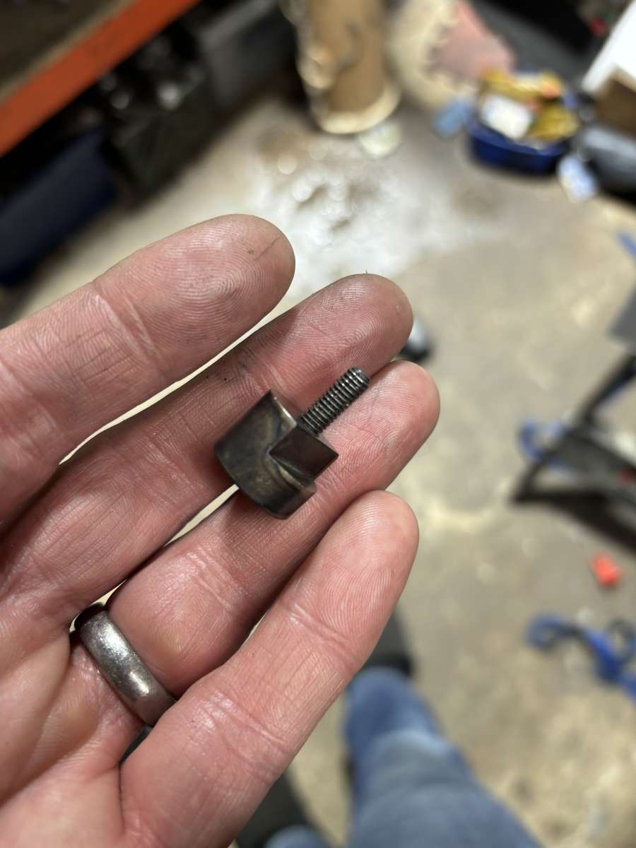

      I recently got hold of a filthy 1963 Boxford BUD mki which I’ve stripped, cleaned and put back together and is working well. However I noticed the saddle tries to lift at the front under load and so it occurred to me that I probably missed a piece when reassembling; namely a saddle clamp of some description. However I have no recollection whatsoever of removing this and so what it would look like. I did however find this:
      IMG_6426
      Would that be the right bit? The cutout fits under the edge of the way and the hole seems to line up with the hole in the saddle next to the right hand apron bolt. However the boxford parts diagram is vague and shows a piece which looks nothing like this. If it is the correct part, how the hell is it adjusted? Is there some adjusting mechanism I’ve lost? Or do you just crudely shove a bolt through it and tighten it so there’s just enough torque to take prevent it lifting but still allow it to slide?

        That’s not the saddle clamp, looks more like the clamp for the tailstock barrel (although I think that step should be more rounded. The saddle clamp is a rectangular cast piece with a threaded hole and a couple of odd lumps (number 140 on the parts list here). Adjusted by a square-headed bolt coming down from above. However, I don’t think you should be getting any lifting at the front when cutting normally, even with no saddle clamp fitted, as cutting forces should be pushing the front of the saddle down onto the prismatic ways. One thing to check is that the saddle gib (number 27 on the list) at the rear is properly adjusted.

          Not standard part. The normal clamp is held by a socket head set screw from the top going into a rectangular cast iron rectangular plate. So if it is undone too much  the plate drops off and maybe gets chucked with some swarf so the owner rigs up something else.
          The saddle shouldn’t lift at the front under load – this is a clamp not a sliding retention piece like you have along the rear shear.

            The Boxford does have a saddle clamp on the front shear but its purpose is to lock the saddle to prevent longitudinal movement, not to prevent lift under load. It is located on the front right-hand corner of the saddle. There is a plate to prevent saddle lift under the rear shear adjusted by a couple of bolts with spring wahers.
            I can’t suggest a reason for the front of the saddle lifting as you describe when the load is downwards.

              Thanks for all the replies. In that case I’m pretty sure the cast piece you all spoke of didn’t come with it so I’ll try source one from ostia tools. With regards the gib at the back – I only vaguely set this when I put it all back together so I’ll revisit that

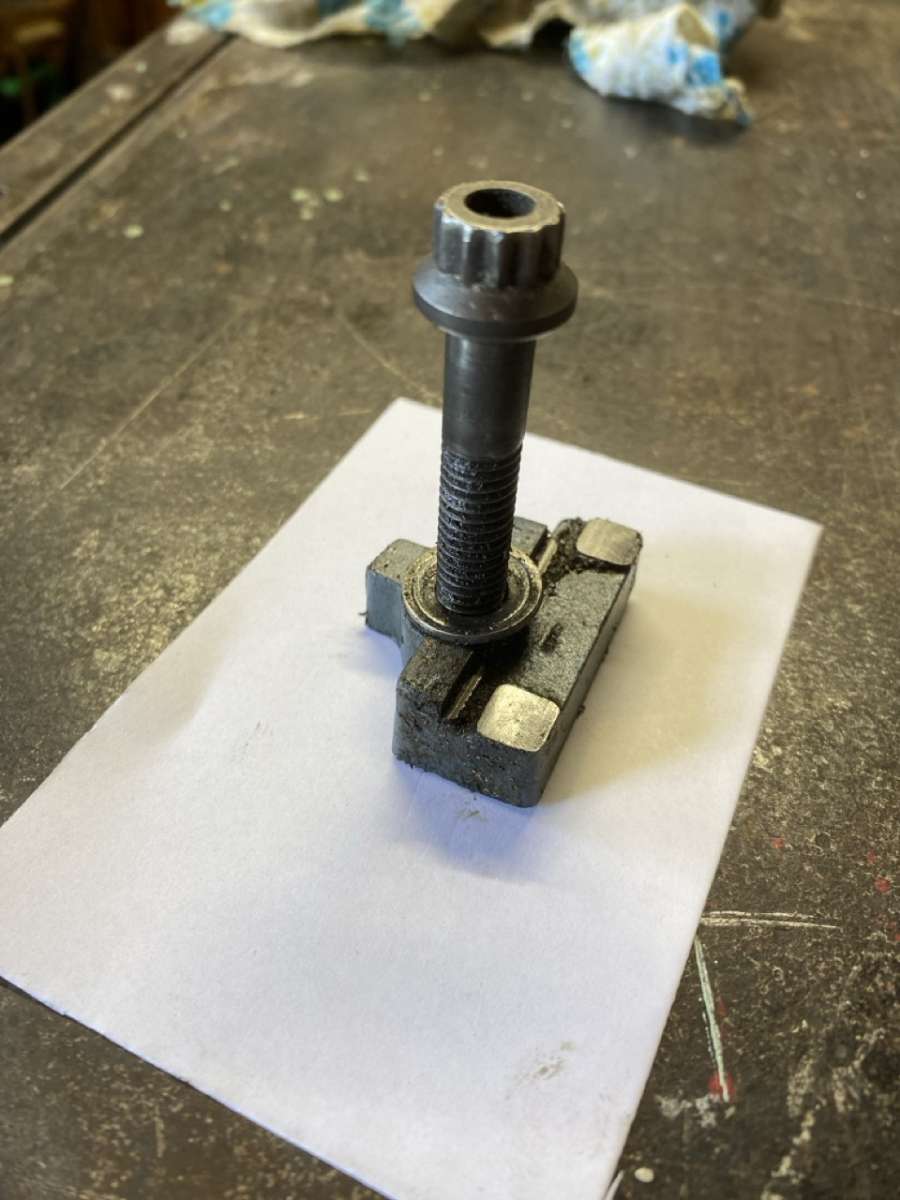

                      This is what it should look like.
                      Saddle Clamp

                          This is exactly what I needed @speedy builder 5. Thank you. With regard to the other questions about my lift issues – I noticed it primarily when boring and taking a little too much off at a time. The pressure of the tool and the leverage from the length of it, caused that end of the saddle to twist round and ride up the v way slightly. I then investigated and was able to lift the front of the saddle by hand. I will check the rear gib/clamp this afternoon and report back

                            On the rear clamp all you probably need to do is flip the plate over to put the unworn side into use.
                            If you snug the front carriage clamp it stops the twisting effect from the handwheel (on mine anyway.)
