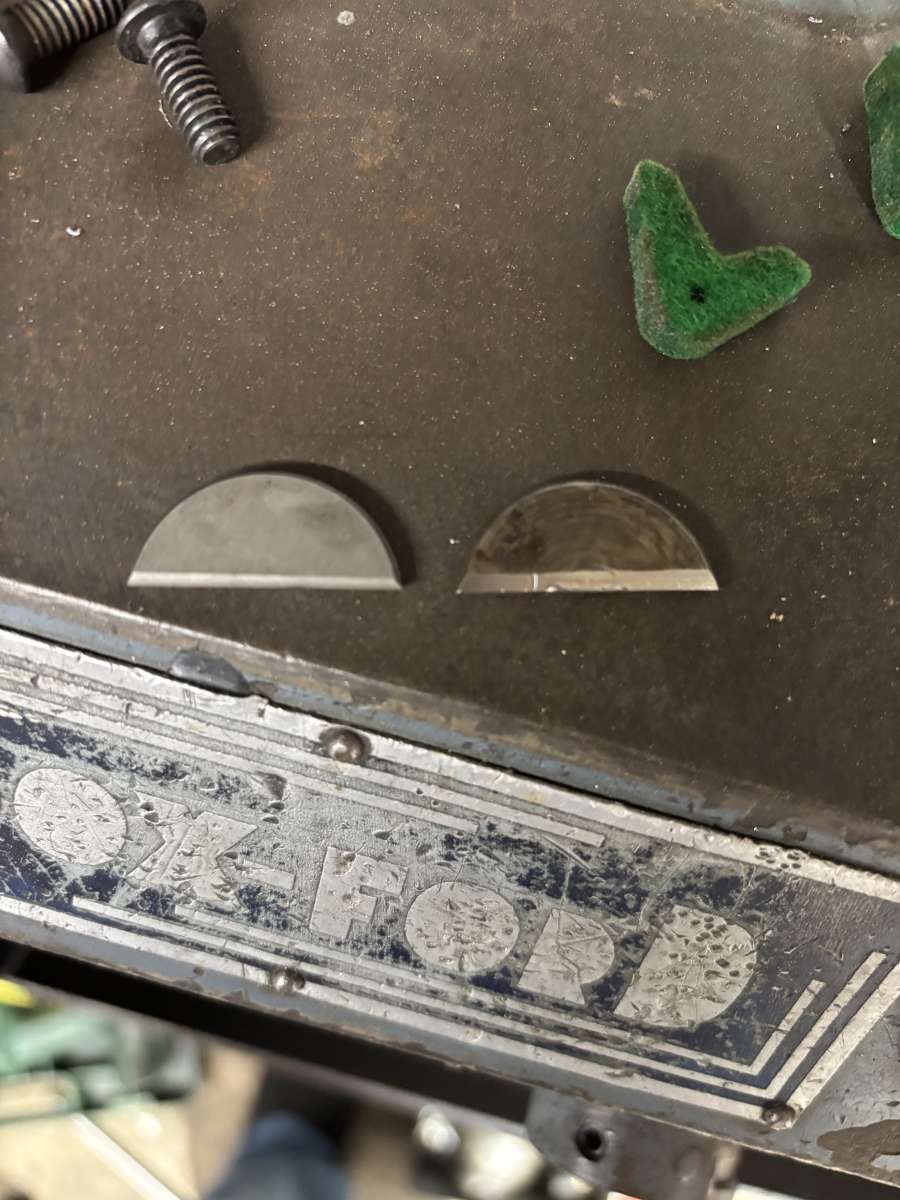

                On the topic of the 2 moons – one of them has a machined flat face on the straight edge. Is this supposed to go up or down? Not sure if you can see it from the picture but the one on the right has that flat face but only on one side
                IMG_6439
                #840757
                Bazyle
                  @bazyle
                  Twenty years since I had mine apart so can’t remember but think it would work best with the chamfer towards the back of the lathe.
