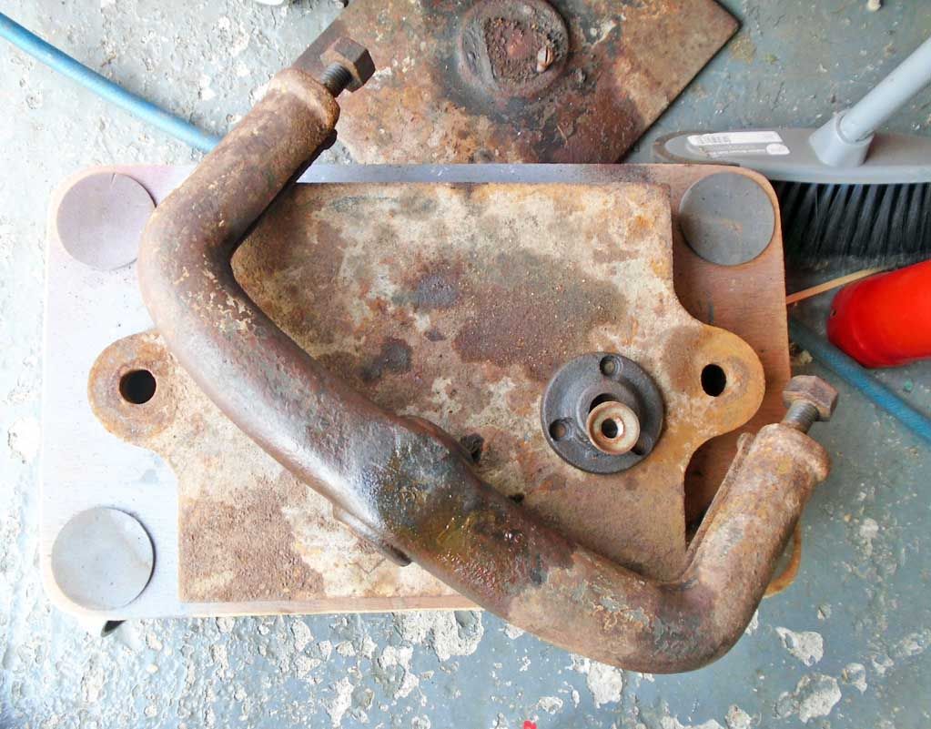

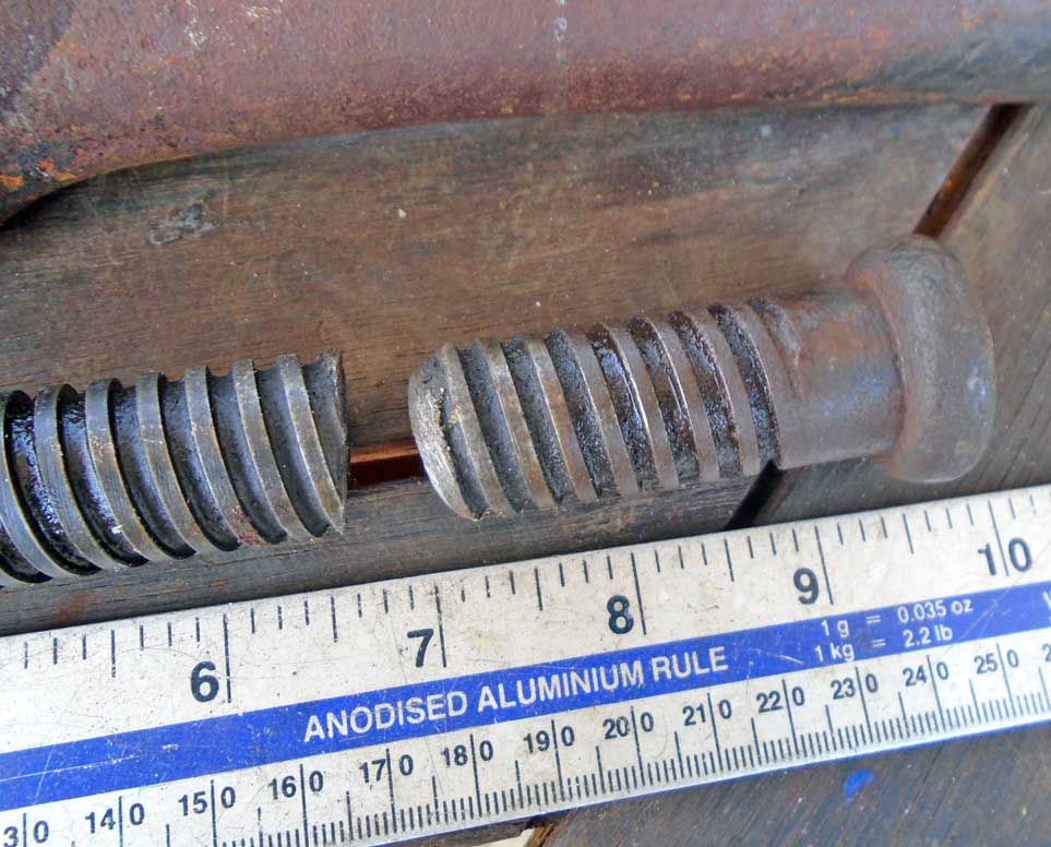

      Just got this old but knackered bookbinders nipping press in need of a new spindle.
      We get a lot of these and they are usually trouble free to restore but this one was seized solid as the spindle was bent and rusted up VERY badly.
      Used lots of heat, WD40 etc and short scaffold pole levers to at least get it turning. Cut off the screws to the bottom retainer and finally cut the spindle to remove it. The usual hassle of the very large securing nuts for the 'arch' being seized was for some reason not a problem, they came off easily.
      Removing the longer stub of the spindle from the handle proved beyond me as it has a driven in pin locling the thread. Fortunately a pal used his large flypress and it came of like putting a finger in butter!

      I have salvaged the end piece of the short stub for reuse, turned the stub down to 1/2" and will bore the end of the new spindle to take it, then loctite and a pin.
      I will do all the other work apart from the main thread first.
      I have a nice piece of bronze bar for the new spindle that is just the right diameter but have never cut a square profile thread and am very wary of how to go about this.

          Has the look of a double start to me.
          Grind up a tool like a parting tool but with clearance so it does not rub on the helix of the thread. First thread I ever screwcut was a 1/4" x 16 sq

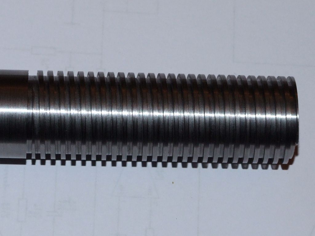

                      Here's one I made earlier:
                      It's 8 tpi and about 1" diameter, cut as an exercise before I made the proper brake screw shafts.
                      The (HSS) cutting tool was simply a square parting off shape with the leading edge relieved to account for the helix angle. I made my tool a couple of thou less than the nominal 1/16" width. The thread is square, so you need to plunge straight in as the flanks are perpendicular to the shaft. Leave the top slide parallel to the lathe axis.
                      A square thread can bind on the crest, on the root and on the flanks. These are independent; fixing one has no effect on the others. Assuming you already have the matching internal thread the crest and root interference can be sorted by calculation, ie, select the correct OD for the blank and cut deep enough to provide some clearance at the root. That just leaves the flanks. That's why I made my tool slightly narrower. Having cut the thread you can advance the tool a known distance (a few thou) with the top slide and shave that amount off one flank. Try the nut for fit and repeat as required.
                      I can't help with the lathe settings (my lathe will cut 5 tpi) but you might be able to select 10 tpi and fudge the drive train by a factor of 2?

                                Also, helix angle does not look great enough for a double start thread with a 2.5tpi lead. But it's always tricky to tell details from photos.
                                #410699
                                Simon Williams 3
                                  @simonwilliams3
                                  So, (at risk of teaching my grandmother) to bottom out the one start/two start debate:
                                  With a Sharpie follow the crest of the thread around the undamaged bit for one full turn. As you come back round it will be completely obvious whether you are one thread or two threads (or more!) along the work.
                                  HTH Simon

                                    As to whether the thread is single start or double, look at the broken one end on, the difference is obvious. I agree with Andrew Johnson here, it is more likely to be single start to get maximum pressure on the book plattern

                                      Had a very nice chat with Brian Wood today and the spindle is certainly a twin start job as proved by the "Simon Method" with a Sharpie.
                                      This is not really viable on my Myford and cannot use a single start as the "nut" in ths case is the very large chunk of cast iron 'arch' to the press. No way I can rework that.
