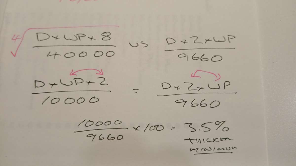

                            #801186
                              Yes that Factor of 4 that you mention Martin is really what makes the two so very similar.
                              Writing out the two formulas side by side with the Evans one on the left and the proposed on on the right.
                              You can then divide top and bottom of the Evans by 4, rearrange the order and the only difference is one is divided by 10,000 and the other by 9660. Which is a constant 3.5% higher number for the minimum thickness before other allowances.
                              As has been said in the article and on here that number at the bottom can vary so play with that and the percentage could just a seasily go the other way.
                              20250603_153913

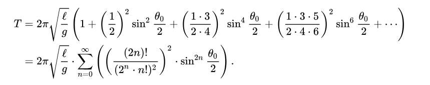

                                                    My request earlier for someone to estimate the accuracy of these these formula fell on stony ground!  Paul’s post identifies one of the problems, when he correctly says “each time you apply a stress cycle even below the yield point with copper there will be a degree of work hardening so each time you re-apply load you are starting with a material with slightly different properties to the fully annealed sample you started with. ”
                                                    Now, the YPS and UTS formula both assume Copper has fixed mechanical properties, and it doesn’t!  Rather, the exact value varies along the curve of a graph, and on the purity of the Copper, and on temperature, and on age hardening!   That means both formula are approximations.
                                                    That the formula are somewhat inaccurate is unlikely to matter when building a model boiler because a safety factor has been added to the formula.  A safety factor that multiplies the calculated thickness swamps the approximation error, and adds enough meat to cover up fatigue, age hardening, and many constructional problems.
                                                    Rather than debating YP versus UTS, what’s the minimum safety factor that could be applied to a model boiler?   A pessimist might insist on more than times 10.  An optimist might risk x1·5.   As boilers age, the safety factor drops due to wear and tear, so how high it is set at the design stage should depend partly on how long the boiler is expected to last.  As far as I know the expected life of a model boiler in kilograms of steam output at working pressure isn’t considered.  Not the end of the world; rule of thumb works well enough, is often derived from a professional code, accidents are rare, and model steam is great fun.
                                                    Many engineering formula are approximations, and which is applied depends on the accuracy needed.  The usual formula for a simple pendulum (swinging no more than 1 degree) is:
                                                    simplependulum
                                                    but it might be necessary to go for:
                                                    polypendulum
                                                    Which, unfortunately, is only accurate at constant temperature in a vacuum …
