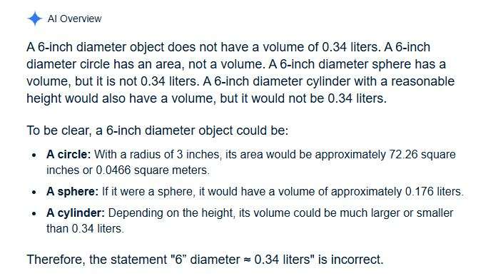

      Well if proof were needed that AI does not get things wrong, have a look at the latest GROK of S**t it has come up with posted on MEinT hialand’s forum.
      How anyone can post something containing the statement “e.g., 6” diameter ≈ 0.34 liters” as a way to discredit Mark De Barr’s reply is hard to understand. Even if the 6″ diameter were used to work out an area without the missing length there is no way it could even approximately equal a volume. And you don’t need to be an engineer or have letters after your name to spot that GWOK has got it wrong 😉
      Even AI itself s\ys the statement is incorrect, or should I not believe that either😂😂😂
      AI boiler
      Hi, doesn’t even get the area of a 6″ circle correct by the look of it.

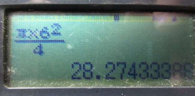

      001

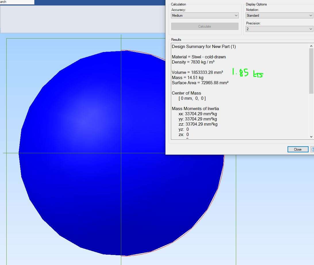

      #811191
        Did not do very well with the Sphere either as a 6″ sphere would be 1.85lts
        sphere

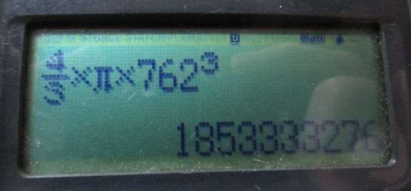

          Hi JasonB, long long while since I learnt how to work out sphere volumes, but I did find a calculator online, which gave the answer by just putting the parameters in, but I then found a formula to work it out, although it took a little time to understand it, which is shown in Cu. mm. I did think the one shown in the post was wrong though.
          002

                  Hi, I don’t class myself a Luddite either, and we all make mistakes. The area of the circle was not only wrong, but not anywhere near close to being correct, and I learnt how to calculate the area of a circle in primary school with pencil and paper, no electronic calculators were around back then with the convenience of the symbol for Pi or other things like the 2 to denote and calculate the squaring etc. Makes one wonder if todays school children can learn anything to be correct.
