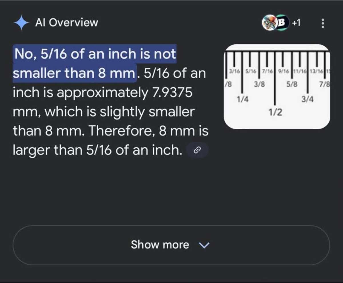

                                                  Well if proof were needed that AI does not get things wrong, have a look at the latest GROK of S**t it has come up with posted on MEinT hialand’s forum.
                                                  How anyone can post something containing the statement “e.g., 6” diameter ≈ 0.34 liters” as a way to discredit Mark De Barr’s reply is hard to understand. Even if the 6″ diameter were used to work out an area without the missing length there is no way it could even approximately equal a volume. And you don’t need to be an engineer or have letters after your name to spot that GWOK has got it wrong 😉
                                                  Even AI itself s\ys the statement is incorrect, or should I not believe that either😂😂😂

                                                    1. FB_IMG_1754453915429
