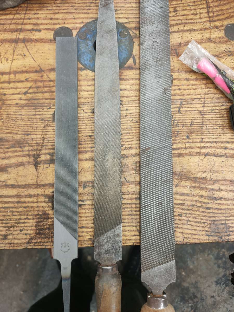

                        Hurrah!!!! Look what I got = the one on the left!!!!IMG20261030173740
                        It is a real left-handed lathe file. I once got a lathe file from ArcEuro once that looked left handed in the picture but wan’t upon arrival so I’ve always been wary of trying again. In a moment of bordom I found myself search amazon and came across this pferd – amazon returns are just soooo good I decided to take the chance.
                        #872131
                          To be fair to ARC they sold them as “LONG angle lathe files” not left hand. Mine works well and looks just like the one in the ARC photos.
                          The “hand finishing” files show the cut in the opposite direction to the low angle.

                                  I probably got the hand finishing file then. To be fair to arc, i emailed and asked if they had, or could source, left handed files and they told me no. I bought the left handed image even so, just in case they handn’t checked (can you have too many files?), and didn’t blame arc for the mistake. I also tried to contact their supplier with same request. I put a bit of time into trying to find one hence I’m quite chuffed now.
                                  FYI, my search for best file for left handers up to now was nicholson ‘magicut’ intended for plastics. I reccomend for right handers on steel.

                                    Out of interest jack what effect does the hand of the file make in use? The only thing I can think of is that there can be a slight tendancy for mine to want to move towards the chuck if you don’t hold it firmly.

                                      On a lathe you might want left or right handed files depending on whether you want to use the file on the top or bottom of the workpiece. That is why they sell both right and left handed pivot files. Underneath – you can see what is happening betterl on top seems more natural. And yes, the file diagonals make it ‘pull into’ the shoulder (or push away from it.
                                      This lathe file I have has both safe edges (although better to give them a bit of a grind if you want them truely safe).
                                      If a left hander uses a normal file the same way as a right hander does then there is a tendancy for the angle of the teeth to line up with the direction of cut and then they tend to sink into the previous groove = you get a checkering file effect with very deep grooves so very poor surface finish. To combat this, as a left hander, you have to almost perform a reverse stroke compared to right handers.
                                      No problem if direction of cut is straight along the file (e.g. planing a hand scraper edge) or draw filling. If you want to push when draw filing then the handle has to be in the right hand ?! So maybe it should be called push filing. OR maybe lefties inveted it because of the frustration with normal filing.
                                      I may now concentrate on getting left handed digital calipers – much easier to find, but what a mark up!!

                                            Thanks Jack, similar to what I thought. I do sometime suse mine under the work holding it with the handle facing away from me but not reaching over to the back, it is easier to see if shaping a convex profile.#
