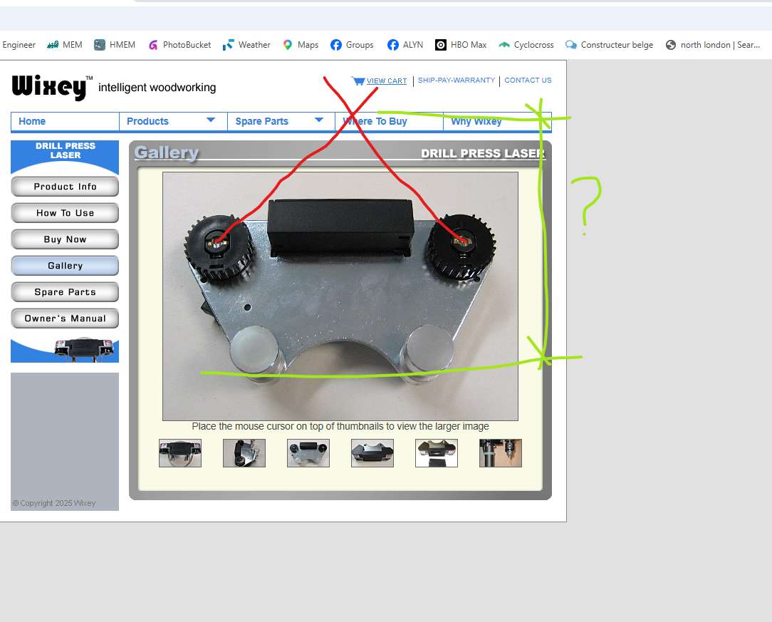

      Using the standard pilot pin for aligning annular cutters on a mag drill can be tedious when doing a lot of holes because you need to remove the pin each time before cutting the hole. I have looked for sprung pins without success and came across a laser alignment clamp-on Wixey WL133. Amazon reviews are a bit mixed so any thoughts here on this or alternatives?

        Given the usually small throat depth of mag drills you would have to check that the beams could be adjusted in close enough without being obscured by the battery box
        mag
        Other option may be to make a “cup” shaped cap to fit the end of the cutter with a locating pin on the bottom. That way you slip the cup onto the cutter and lower it to locate your mark, wind it back up and remove the cup. Good to go.

          Jason the cup solution is simple and perfect, albeit making up one for each size cutter. Many thanks
