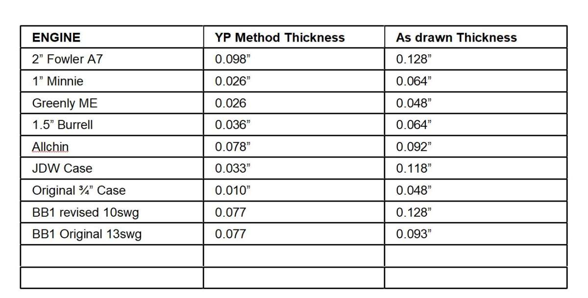

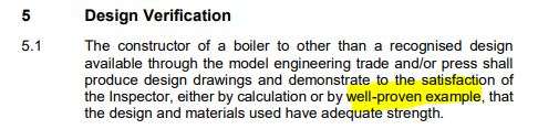

          On a slightly different note and knowing that all this stemmed from queries about the boiler for a traction engine to one of Julus de Wall’s designs (not Julian) I thought I would have a quick look at a few of the traction engine drawings that I have.
          Now the UK code says that a new boiler can be based on calculations or based on a similar existing design to the discretion of the inspector. Taking the latter I would say that the suggested new YP method would NOT result in a safer boiler. May be cheaper though but is the cost worth the risk?
          Since Compiling the table below I see Duncan has posted showing a near 50% difference in previously accepted and the new methods Acceptable psi. This would seem to be born out by the figures that consistantly show the YP method gives a thinner result than all the established designs.
          boiler thicknesses

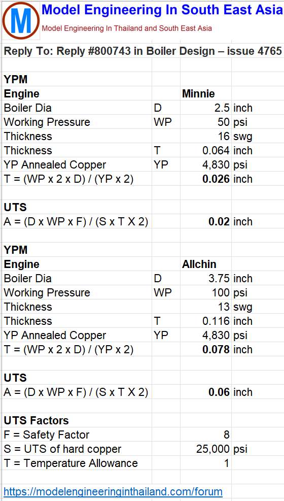

                  5) Your Table Is Misleading (Again)
                  As stated above, You are comparing the minimum calculated YPM value with a value shown on a drawing. This is misleading.
                  Also, what you are not showing is the YPM value compared to the UTS value. UTS calculation being the traditional method as used by Greenly, Harris and Evans.
                  Taking two examples here are the results:-
                  Minnie
                  YPM 0.026″ (As your table)
                  UTS 0.02″ (Slightly less than YPM)
                  Drawing 0.064″ (Much greater than either of YPM or UTS methods)
                  Comment. The theoretical thickness required (both YPM and UTS methods) is less than 1/32″. This is a very fragile thickness and I’m not even sure if it is available in the diameter required. The designer, LC Mason, has sensibly chosen a realistic thickness of 1/16″ which is shown in your table.
                  Allchin
                  YPM 0.078″ (As your table)
                  UTS 0.06″ (Slightly less than YPM)
                  Drawing 0.092″ (Much greater than either of YPM or UTS methods)
                  Comment. As for Minnie, the designer, WJ Hughes, appears to have recognised that the calculated thickness of 0.06″ (1/16″) is rather fragile for a 1 1/1/2″ scale traction engine and has chosen a sensible thickness of 3/32″)
                  All this bears out my comments above of calculated value versus actual practical chosen value for boiler shell thickness.
                  For the doubters, here is a screenshot of my calculations:-

                            Even worse, and quoting your statement “a new boiler can be based on calculations or based on a similar existing design to the discretion of the inspector” is completely wrong by any measure of proper engineering practice.
                            I was simply stating the current UK Code, I was not saying if it was wrong or not but it seems to work as we don’t see many failures. And the boiler inspector may not accept all existing designs if he feels they are not well proven based on there experience.

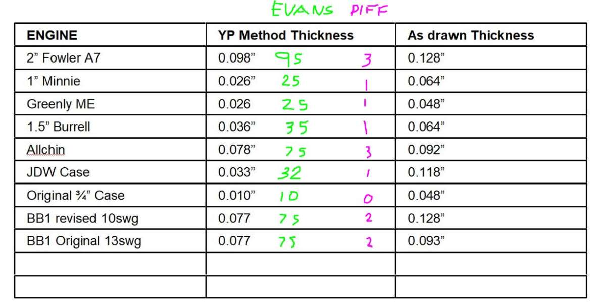

                            #800798
                              So as not to mislead anyone I have quickly added the thickness in thou that the Evans formula gives as well as the difference between the two.
                              mislead
                              Seems very little and as use factor take sthe shell well over the minimum is there much point in changing from what has been proven to work in the past?
                              #800802
                                Now what could be misleading is using a different temperature allowance here (1) to th eone you used in the article (0.8) giving a 20% difference rather than a 4%. Was there an engineering reason for this? As the Model boiler testing setup is very much based around Locos then the Evans method is more likely to be what will be used and quite possible preferred by inspectors and that is why I used it above.
                                40

                                        Yes I’m sorry that I’m a bit dyslexic and make the odd typo and my english and grammar may not be upto that of others
                                        But to spell it out, wrong numbers = using the ID when the calculation should use OD. I am not doubting the formula. The incorrect 6″ was used when the correct figure should have been 6″ + (2 x T)
                                        If you can explain where I have got that wrong I would be most greatful.
                                        As you say the result is based on what you pick the copper figures and safety factors from, as my table comparing Evans and yours shows the differences can be bery small, if a designer were to pick a slightly different figure it may be the results are the same or the old method could even give a thicker boiler even before other factors are added.

                                                Bob bring sup one of the point sI asked about in my inital reply. It is extreamly unlikely that a new boiler will go straight from pickle to a 2X WP test. At the very least any reasonable builder would want to check it for leaks starting with a low pressure and building up to higher maybe even 2xWP This will as Bob says start to harden the copper and change the graph. As the thicknesses between the YPM and that of Evans are so small then this additional hardening will likely reduce the diference even more to the consistant 3.5% thicker wall it gives
                                                #800844
                                                  As for this bit
                                                  “it would give your new proposed method more credability if calculations were done using the correct numbers.”
                                                  Our calculations DO use ‘the correct numbers’ with the caveat that no one can say what is the correct number for the Yield Point of copper, nor the UTS number for that matter.
                                                  I assume, therefore that you accept that the numbers used in our calculations are correct but that you are referring to number not used in our calculations, in this case the thickness of available copper materials.
                                                  If the numbers were correct then why did you alter them to my suggested ammendments and appologise for the mistake in this post ?

                                                    I’ve tried to reverse engineer the Aus code table for traction engine boilers, and it looks as tho’ their acceptable max hoop stress is around 18 MPa, 2610 psi, but I wouldn’t put any money on that.
                                                    The UTS of annealed copper is the same as that of work hardened, as the annealed stuff yields plastically it becomes work hardened
                                                    The important factor is the INSIDE diameter, that is where the load is applied.
                                                    If an FE analysis of a thin shell under internal pressure gives a hoop stress significantly different to the simple theory, I’d go and check the FE because it’s wrong. The stress at the inner surface is very slightly different to the outside, this matters for thick shells (in relation to the diameter). Taking a 127mm OD tube, 2mm thick with an internal pressure of 620kPa (95 psi) the thin shell theory gives hoop stress 19.06 MPa, thick shell theory gives 19.4 MPa at the inner surface, 18.8 MPa outer. We don’t need to get worked up about such small differences.
                                                    I think it wise to assume that a silver soldered shell is annealed. According to my little book from the CDA, anything above 300C will do the trick. I’ve always gone to red heat. For a boiler, at least the ends will have been a lot hotter than 300C.
