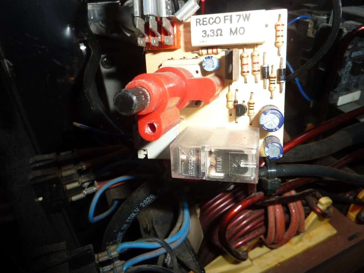

      I have a BOC Mig Master 130 Turbo Mig welder. The wire speed control has stopped working altogether. I have removed the small board which controls the wire feed motor and notice 3 very small components looking burnt, Diodes ?  Has anyone had a similar experience and how did they solved the problem, in particular the component identification on the Pcb. ?  John

        Can you post a photo of the board and components?

                  When the welder failed it didn’t do any thing at all it stopped. I have looked around, and others say it is the same or very similar to a Cebora. All I would like is a clear picture of the PCB, unfortunately on mine the identifications are burnt. So, if anyone has component details of a Cerbora please let me have a copy.  I’ll keep looking, shame to scrap it John

                        Many thanks to you all. The picture which came via you Dave above is just the board I need, but at that price of £70 plus I will wait a while. If I knew the burnt component values its not a long job to make one on Vero board. I’m fortunate as we have a semi industrial ( car garage type) Mig at MATES of which I’m a member, so I’m not stuck. But a Mig in the workshop available anytime  is the way to go. Many thanks to all respondents.   John

                                  Thank you Dave, I have joined welding Forum and was unsuccessful searching for my PCB details, you got there, good. Its those two diodes top right and the resistor between, which are burnt. Diodes no problem but can’t see clearly the band colours on the centre resistor. Anyway a move in the right direction.    John

                                    Looks like Brown, Black, Black, Gold to my eyes – 10 Ohm 5%.
                                    Physical size should give some idea of the power rating.

                                      Thank you David, mine is badly burnt and is so very thin, never seen one like it. I’ll give it a try over the week end, and report back.  John

                                        Not trying to teach you to suck eggs, but resistors don’t normally burn out on their own. Something else has probably failed. The electrolytic capacitors are prime suspects.
                                        Robert.

                                          The resistor by the biggest capacitor looks to have the same value too.

                                            Blimey, never thought I would receive such useful help, yes Dave, I had noticed that resistor being of similar value. Granddaughter visited and she soon got me sorted on the Welding forum, and I now have a very good colourful picture of the board. Amazing how these young people can see the obvious and I couldn’t, such is life. Eventually I will rebuild the board, test the important components Capacitors, Transistor, and Thyristor and go from there. I have a small stock of bits. But grass is starting to grow, then it will be hedges, so playing might have to wait until the autumn.  John
