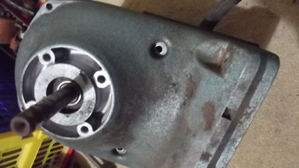

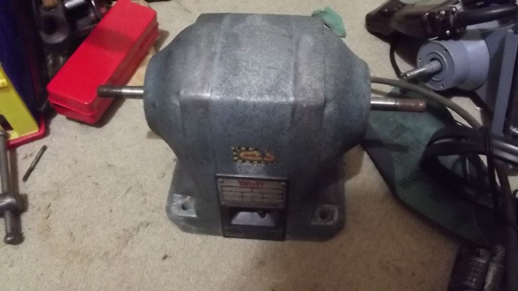

      Bought a wolf bench grinder but it has a case of squeaky bearings.
      Does anyone have an idea of a good way to press the bearings out? The body is made up of three parts. The two end pieces hold the bearings and the middle is a spacer between them. Can't touch the bearings without splitting the casing into constituent parts.
      I was thinking of heating the bearing housing on one side, whacking the shaft of that side and hoping the other half of the housing pops off. That sounds like a lot o hitting with a hammer to me though.
      Anyone happen to have disassembled one or worked in the wolf factory? Can't find a model similar on Ralliwolf or internet. Don't really know what it looks like inside.

          I would go with tapping the shaft with a soft faced mallet, a few not too heavy taps should show whether the end housing is going to part from the body easily. There may be some notches on the joint line to allow a flat punch to be use to help part the cases. The shaft should not be too tight a fit in the bearing and should knock through without too much force. Extreme force should not be required or used.

            Tap around the joint lines of the three castings with soft hammer first to free them up if possible.

                The two end casings should separate with some gentle tapping, looking at your pics it shows the castings are 3 separate castings bolted together, & you've already removed them.

                  Hold one half in your hand and use a mallet on that end of the shaft. I'd probably do this with the grinder on a flat surface to support the weights as it comes apart. If that doesn't work fasten one half down so you can hit a bit harder.

                      One cheap grinder I dismantled (To make it reversible for a tool grinder.) had the bearing at one end loctited in.(I assume to provide axial location.) The other end was a light press fit to allow for the different expansion of the case and the rotor. So it is worth tapping the shaft from both ends as it will come out more easily one way. Also be careful not to rip off the wires from the winding to the centrifugal switch.

                        I hit it with a table leg and it worked out. Applied heat first and in the end it came out quite easy.
                        Glad it is just the bearings cause I have no idea how the electrics here work. The brush is attacked to the shaft and one casting has two copper rings in it.
