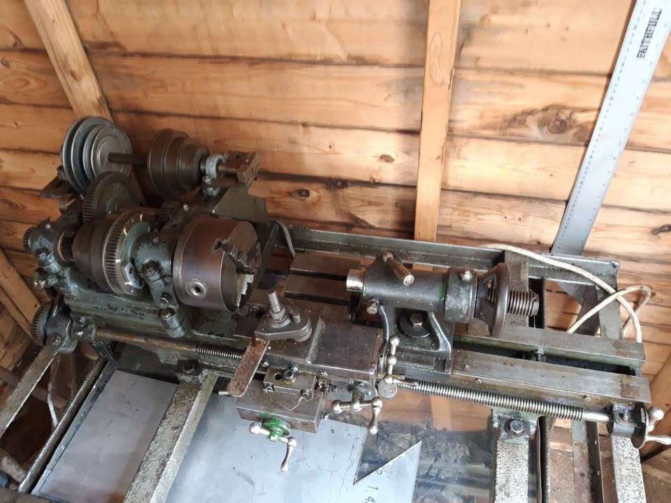

      Hi All.

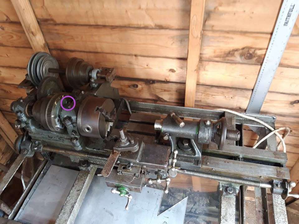

      So, I have recently bought my first lathe.
      It is an old Zyto.
      I want to buy a live centre, and a drill chuck for the tailstock. How do I know what size I need? I think it’s MT2, which is fine, but since it’s a pretty small lathe I can’t just buy any live centres and drill chucks right? Since they might be too long.
      Also, what is the best belt to use to get the drive to the lathe?

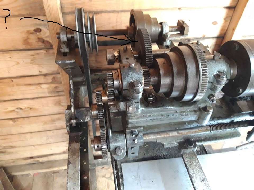

      I also want to know what the marked spindle/gear thing is for please. When I match up it’s gears with the gears on the lathe the lathe won’t turn, like it jams it. Thanks.
      Here is the lathe:
      zyto1
      And the marked bit I don’t know what is for:
      zyto6.1
      #790152
      Pete
        @pete41194
        Those would be what are called back gears, they provide a fairly deep gear reduction with a large increase in torque. I don’t know enough about that lathe to advise how to disengage them, but someone here will.

              Hi ell81, as has been said, your arrow is pointing to the back gear, but before you can use it, you will need to disengage the three cone pulley drive from the lathe spindle, and that maybe a grub screw needs backing off, which might be in that small hole on the small cone, if it is, it will be poking into a small dimple on the shaft, and when you want to re-engage the cone pulley, you must make sure the grub screw goes back into the dimple, otherwise you will end up scoring the shaft badly. As for chucks and live centres, they are all pretty much the same, given the size of Morse taper in the tailstock.

                  I think you will find the means of disengaging the big gear (‘bull wheel’) from the pulley is most unlikely to be a grub screw as suggested above. I think you will find it here:

                    The Back Gear may well be engaged/ disengaged by swinging the shaft in eccentric bushes.
                    When engaged, there will be a pin or grubscrew which disengages the drive from the spindle (otherwise everything will lock up beacus you have two gears, of different ratios, engaged at the same time.
                    DON’T be tempted to use this to remove a chuck that is stuck on the spindle. If you do, broken gear teeth are likely to result, and replacement gears will be difficult, if not impossible to find.

                      As Charles mentions above, there is spring loaded pin on the right hand face of the bull wheel which engages with a hole on the right hand side of the pulley block.  Look for a little knurled screw (on mine), pull this out and give it a quarter turn to stop it springing back.  this will disconnect the ‘straight through’ drive from the pulleys to the spindle, and enable the back gear operation.
                      NB – make sure the pin is correctly engaged in the hole when you switch back out of back.  Mine has some breakage to the side of the original hole, so a previous owner has repaired by drilling a new hole at another location on the pulley block.

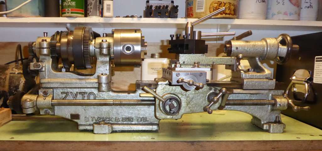

                        I have been looking for some photos – I think I also had more on the old ME website, but below is the only one I can find immediately.  I shall look further tomorrow.
                        Martin

                          Adding to above, the locking pin is visible in the middle of this view from the above image

                            By changing the contrast of the first picture, it looks like you disengage the button or pin as already described. Then there will (or should) be some sort of retainer to temporally unlatch so the backgear shaft can be moved. It simply slides along until both gears engage. Ensure relatched in whichever position before running. Retrace steps to restore direct drive.

                              Hi, thanks to those who pointed out the correct way to disengage the cone pulley drive from the spindle, My thoughts were based on my fathers RandA lathe, although I did wonder if it was on the Bull wheel, as my Myford “M” type is via the Bull wheel.

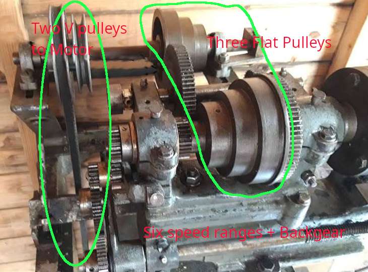

                                  Pete correctly says ‘… back gears, they provide a fairly deep gear reduction with a large increase in torque.”, but no-one has explained what back-gear is for!
                                  It’s a “good thing”.  Normally a lathe spins jobs at high speed, up to about 800rpm on a Zyto.   (That’s slow by modern standards, but not a showstopper.  Use HSS rather than carbide cutters.)
                                  Rule of thumb guideline, cutting mild-steel with HSS, RPM = 10000 / diameter of job (in millimetres).   So the operator needs a range of speeds depending on the job in hand:
                                  • 4mm diameter ideally requires 2500rpm (too fast for a Zyto – it will kill the bearings!)
                                  • 10mm = 1000rpm
                                  • 50mm =  200rpm
                                  • 100mm = 100rpm
                                  • etc.
                                  On a Zyto the required speeds are achieved, approximately, by moving belts between pulleys.   This Zyto has 6 basic speeds. 2x by moving the V-belt on the motor,  3x by moving the flat belt on the lathe:
                                  zyto
                                  Though swapping belts works, moving them is a pain!   Modern lathes reduce the need for belt changing by speed controlling the motor, often supplemented by a 3-speed gearbox, much more convenient, but reduced torque at low RPM can be a problem.   Expensive lathes have pricey gearboxes throughout.
                                  Operations like threading and parting-off are best done at low rpm, perhaps as low as 10rpm, when it’s good to have plenty of torque (turning power).    Whilst low rpm can be achieved by speed controlling the motor, doing so loses torque, leading to stalls.  Much better to spin the motor at full speed and gear it down.  Fast turning motors maintain their rated power output, whilst the gears reduce speed and multiply torque.  Win win!
                                  Backgear is an extra low gear ideal for threading etc.   Backgear may not help parting-off because the Zyto isn’t particularly rigid – small lathes tend not to be!

                                    The frame holding the countershaft pulleys looks as if made without a ready way to slacken the flat belt to change speed. So doing that on this lathe will be a pain as Dave says!
                                    It should not be. I don’t suppose it takes more than 15 seconds on my Myford. The usual arrangement has some way to move the countershaft nearer the lathe to allow this, typically controlled by a lever operating an over-centre clamp or an eccentric arrangement so the shaft locks itself in the operating position. So if the frame does not have that quick-tensioning system, I’d investigate making one for it.
                                    Also it looks from that angle as if the belt encloses the back-gear shaft, so fitting a continuous-belt replacement may need that lifting as well. These machines were made for belts that have a joining-clip in them. You thread the belt round the pulleys then assemble the clip to join the ends. An alternative arrangement, used for example on the Myford lathes, is to put the countershaft higher so the belt is entirely clear of the back-gear.
                                    The Vee-belt looks too deeply engaged. Assuming those are standard-profile pulleys (which they might not be!) the correct belt’s outer width is that of the groove top, so it runs with its outer surface pretty well level with the pulley rim.
                                    The cutting speed is a bit advisory: you can machine metals at much lower speeds than the books suggest, especially with high-speed steel tools, because the books are based on trade practice where time costs money. It just takes longer!  Note though Dave’s warning about excessive speed on a machine like this, with its plain bronze bearings and very basic lubrication.
                                    That slotted cross-slide is a bonus. Its primary purpose is for “boring between centres”, for maching cylinders too long to hold safely and accurately in the chuck. The work is packed up to the right height and clamped to the cross-slide, and the cutter is in a bar driven from the headstock centre or chuck, and supported by the tailstock centre.
                                    Such a slide also allows using accessories like the rear tool-posts many of us use especially (but not only) for parting-tools; angle-plates and vertical slides. The current edition of ME&W carries an article showing such applications.
                                    Morse-taper tooling such as centres are readily available from the model-engineering suppliers. The taper shank is of standard length for the diameter so that does not control how much of the lathe is hogged by the tool itself. Drill chucks and some die-holders are the longest.
                                    Howard has explained the change-wheels, on the outside end of the headstock. Disengage these when not being used, to reduce wear; and anyway you will need the leadscrew (the long one along the front of the lathe bed) disengaged from them when using the handwheel on its far end. I take it the disc visible inboard of the handle is a graduated dial?
                                    That leadscrew handwheel is used when you need take a measured cut longer than the top-slide travel gives; by engaging the half-nuts by that lever with the curved slots. Normally you keep the half-nuts disengaged and use the saddle handwheel that drives a pinion engaging the rack fitted to the bed above the leadscrew.
                                    Or set up the change-wheels to give a fine self-acting longitudinal feed using the leadscrew and half-nuts. There are a few change-wheels already on the machine but did the rest of set come with it?
                                    That little dial on the right-hand end of the saddle is a thread-indicator, used when screw-cutting. It normally pivots in or out of engagement with the leadscrew, with a pin, screw or nut to hold in either position; and should only be engaged when screw-cutting.  Its graduations are not measurements as such but timing points for starting each iteration of the cutting, as it’s normal to take a series of cuts to complete the thread.
                                    A tip on using the tool-clamp. Your top photo seems to show it slanting downwards. It’s best set slanting down but quite gently to give the maximum clamp area gripping the tool shank. Never upwards – than can result in suddenly losing its grip.
                                    The tool itself, ground appropriately for the material, is set so its cutting edge is exactly on the centre-height of the lathe, on a machine like this by using shims under the tool. Introductory books on turning should explain all these points.
                                    The black fitting there on Martin Whittle’s photographed lathe, is a “Quick-Change Tool Post”. A steel block held to the top-slide, clamps to itself separate, channelled blocks that hold the tools themselves. Each has its own adjuster for setting that height. It speeds up repetition work, especially; but you need at least four tool-blocks to make the set worthwhile.  You can see four other blocks on the shelf above the machine, in Martin’s photograph.
                                    I made a crude “Quick-ish Change” set of tool-holders for my much smaller EW lathe, by drilling blocks of steel to hold small tool-bits on an incline for height-setting.
                                    It looks a good lathe – keep us posted with progress and do please ask, if you need help!

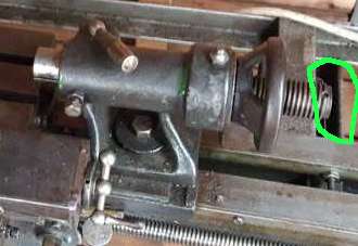

                                        ell81 asked ‘I want to buy a live centre, and a drill chuck for the tailstock. How do I know what size I need? I think it’s MT2, which is fine, but since it’s a pretty small lathe I can’t just buy any live centres and drill chucks right? Since they might be too long.‘
                                        Buying a pre-WW2 lathe requires the owner to sort out complications, and spares may be hard to find.
                                        Though MT tapers are standardised there are variations:
                                        • Short or long.   Short type for drills and small lathes.
                                        • Tang ended or with a hole threaded for a drawbar, which could be 3/8″ or 10mm.
                                        On the machine, two problems with tapers!  Keeping them in place and releasing them.  Drilling forces tapers to wedge ever harder, and it can be difficult to shift them after long service or corrosion / gummed oil bites.  Other side of the coin, tapers come loose far too easily when milling – or doing anything else that vibrates the spindle sideways.   Drawbar essential.
                                        Don’t have access to a Zyto, so some guesswork follows.
                                        tailstock
                                        The Zyto tailstock takes drilling pressure, so the MT should either have a tang, or a plain end.
                                        • There may be a slot in the tailstock aligned with the tang.  A lever inserted into the slot bears against the tang so the taper can be  ejected.  I see no sign of a slot on the Zyto tailstock.
                                        • If the Zyto’s tailstock screw is drilled through, green ring above, the taper is ejected by inserting a rod and tapping it with a hammer.  The taper length isn’t critical, so a long one can be cut short.
                                        • Many tailstocks auto-eject when wound back.  The tang contacts an internal pillar which nudges the tool out.   Taper length is critical: too long and the taper won’t grip, too short and it won’t eject.  To fit these, measure the approximate depth of the pillar, buy a long taper, cut it slightly too long, and then fit it by progressively slicing off the end until the taper engages in the zero position and ejects correctly when wound back further.
                                        • If all else fails, cut the taper short, and eject with wedges.
                                        One of the delights of home metalwork is that we can chop tangs off and/or plug drawbar threads.   You can even bespoke MT tapers.   A little intimidating for the beginner, however modifying shop bought MT tooling is good learning.   An important part of the hobby is measuring accurately and cutting to fit.  (Model Engineering as practised by me is almost entirely “fitting”, a process by which one lump of metal is carefully cut to match another.  Done with simple tools, no need for tenths micrometers, gauge blocks, surface tables or advanced metrology.)
                                        But there’s a lot to know.  Taper tooling is usually hardened so look cutting with an angle grinder.   Sawing or parting off in the lathe aren’t a good way of cutting them.
                                        With luck a Zyto owner will simplify the above by confirming what they use, providing the measurements, and naming a seller!

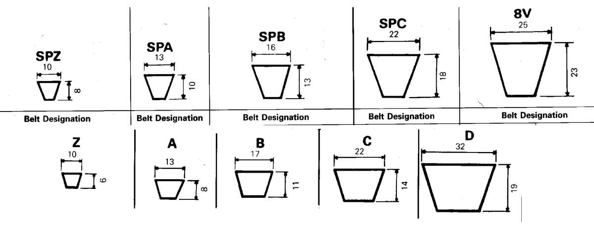

                                                Selecting a Vee-belt is easier than that. You don’t need take components with you.
                                                Measure the width across the top of the groove.
                                                Look up a table of standard belt widths, designated by a letter, and find the one whose outer width matches the top of the groove so it rides approximately flush with the pulley rim.
                                                That’s the belt width sorted, now we need the circumference.
                                                There is a formula giving the belt circumference by the pulley diameters and the shaft centre-distance. I don’t know it off-hand but it’s likely a transmission-components stockist can supply it.
                                                Vee-belt profiles come in two forms: plain Vee (actually a trapezium), and toothed or “cogged”: trapezium cross-section but with small cross-grooves moulded into the inner surface. The latter is more flexible and better where the driving pulley is small and the driven pulley large, as typical on a lathe’s primary drive.
                                                The belt coming up from the motor in the first photos looks too narrow for the pulley, as it is sunk rather deeply into the groove.

                                                  Hi, Vee belt profile sizes.
                                                  BELTSIZE
                                                  Just to add, your Vee belt/s should not be touching the bottom of the pullies, if they are, you either have the wrong size belt, or the pullies are badly worn, and you won’t get an efficient drive.

                                                      For the back gear pull and turn the small button on the bull gear 90 degrees the one nearest the chuck, this separates the bull gear from the stepped pulley, now slide the rear shaft sideways to engage the 2 sets of gears, try turning the drive belt by hand the head stock should drive freely but with much reduced gearing. To return to normal speeds slide the rear shaft the other way it has spring detents to disengage the gears, now find the mark on the stepped pulley it looks like a small notch in the rim of the pulley next to the bull gear, line this notch up with the button on the side of the bull gear and rotate the button 90 degrees again, you should feel it drop down into the bull gear. If you give the bull gear and the pulley a wiggle in opposite directions the pin at the end of the button should engage with a hole in the pulley and connect the 2 together. If you can still turn one against the other for just under 1 revolution you’ve not got the pin in the hole. If they’re now locked together again try turning the drive belt by hand the head should drive but at the higher speed range.
                                                      As it was designed you have 6 speeds 3 high and 3 low, mine still has its original metropolitan vikers motor and has a range from 63 rpm upto 930. With your set up using 2 pulleys steps on the motor drive belt, you have in theory 12 speeds but some may be duplicated depending on setup.
