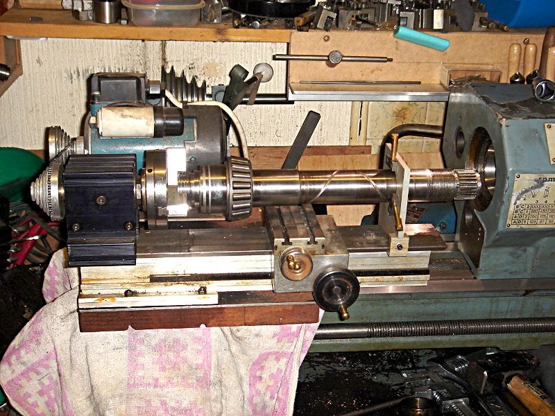

                              winkMy last bit of Peatol abuse – Boxford spindle. Worst before that was a pulley that it could scarcely swing with the riser blocks on
