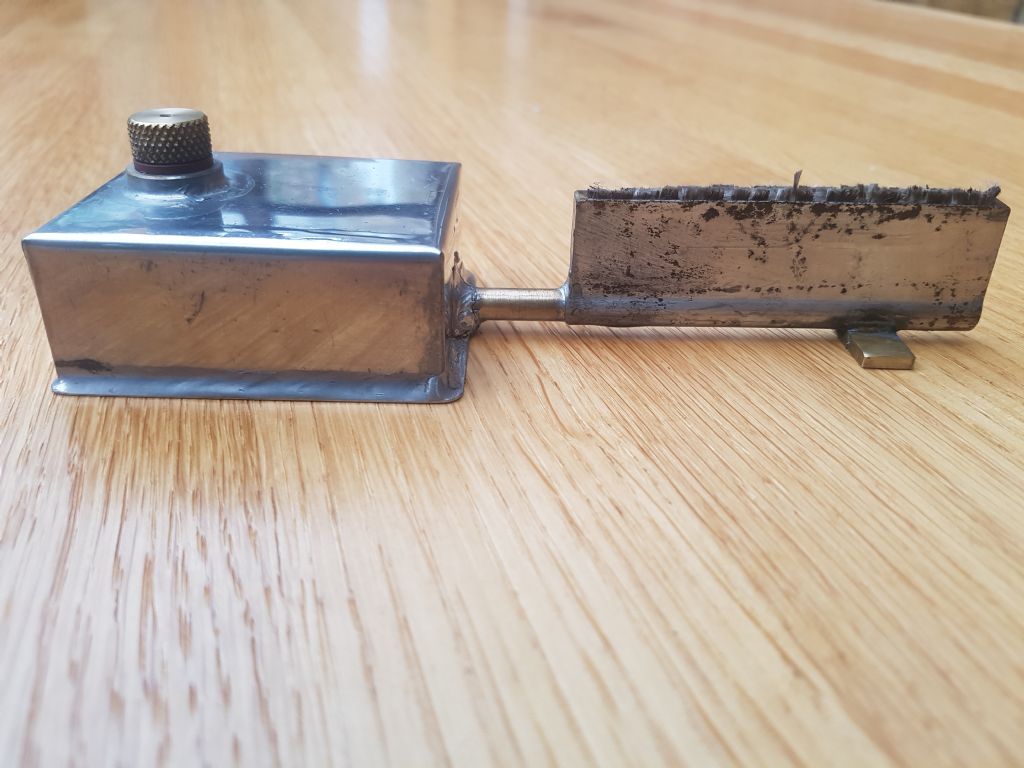

                                  Brian John
                                    @brianjohn93961
                                    1. Are you using a metho burner ? Can we have a closer look at it and how it was constructed ?
                                    2. Are you venting the exhaust steam through the chimney ?
                                    #564725
                                    Bo’sun
                                      @bosun58570
                                      Good morning Brian,
                                      The burner is indeed a meths burner. A tin plate tank (2.5"x 2"x1&quot connected to a long (3"x1"x3/16&quot wick holder with a piece of 3"x1" Valor Oil Stove wick.
                                      Both combustion gas and exhaust steam exit through the chimney.
                                      The model is from the T. E. Haynes book "Model Engineering for Schools – Book 1, Steam Engine and Boiler".
                                      #564741
                                      Brian John
                                        @brianjohn93961
                                        Could you post a photo of the burner please ? I am always looking to improve my own design of burner.

                                              #565607
                                              Bo’sun
                                                @bosun58570
                                                Posted by Bo'sun on 29/09/2021 11:34:56:
                                                Good morning Brian,
                                                The burner is indeed a meths burner. A tin plate tank (2.5"x 2"x1 ) connected to a long (3"x1"x3/16" ) wick holder with a piece of 3"x1" Valor Oil Stove wick.
                                                Good morning Brian,
                                                Apologies for the delay, finally here is an image of the meths burner I made for my steam engine.
                                                #565943
                                                Brian John
                                                  @brianjohn93961
                                                  1. Thank you for posting that. It has given me a few ideas already. I will have a go at building something similar.
                                                  2. The chimneys on my boilers are just dummies now. They are not actually connected to the combustion chamber because I was losing too much heat via the chimney. I see you are venting the exhaust steam through the chimney but where does the water go when you do this ?
