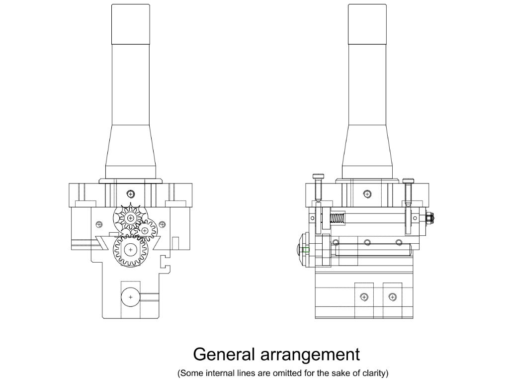

      For some weeks (yes, really) I have been working on a design for an automatic boring and facing tool. I think that I've now come up with the finished drawings. What I would like is for some kind person to have a look at them and see if they can find any errors which I have missed and point them out to me. I have bought the metal for the project but want to be sure not to ruin it by cutting it up too small – come on, we've all done it! There are six drawings in DXF file format, a brief description in a PDF file and a jpeg of dubious quality reproduced below to give some idea to anyone who's interested.
      I should point out that I am NOT a draughtsman, neither am I in any way qualified to present the drawings in any other than a way that I can follow and suits me. That is to say, They are produced for me and by me, as long as I can understand them and make it from them, that's fine. Basically, I'm not after a critique of my draughting ability. Sorry if this sounds a bit haughty, but there are some on here who tend to ride horses of high stature.
      Here is the jpeg of the general assembly:

        #218282
        Bazyle
          @bazyle
          Is the gear ratio 12:18? Leads to non integer increments which is not technically wrong just awkward.
          You might want to consider the main shafts at right angles to use a worm reduction for finer feed.
          It looks like you have two concentric circles of pins, one for in and one for out. It looks like the star wheel shaft moves but as drawn it seems to be engaging both stars at once. I take it what looks like a collar for the spring is actually a gear. I think that needs to be outboard of the star and wide enough to remain in engagement with the layshaft when the star shaft is moved across. Perhaps you have some arrangement not shown to move one set of pins in and the other out and the star shaft is fixed.

            I really didn't want to get into a discussion on the merits of the design, but, to address the points above:
            The design is unashamedly based on one by Graham Meek, but with some differences to suit my preferred method of construction and available tools. The slide feed screw has an 8mm x 0.75mm thread, so I specifically chose the gear ratio to give a 0.05mm feed per click of the feed screw. As for the pins, they are actually arranged in diametrically opposed pairs so that either one, or both, can engage with the feed wheels, depending on the feed rate required. I admit, the drawing shown doesn't demonstrate that very well, but it makes sense when viewed in conjunction with the explanation and other drawings. Depending on which pin or pair of pins are engaged, the feed screw will rotate in opposing directions to enable boring or facing from the inside-out or the outside-in, so to speak.

                You have just said the magic words, "Graham Meek"
                If Gray designed the principle of operation, then I suspect it will work perfectly for you.
                I collaborated with Gray during his Screw-cutting dog clutch design, and he is a good engineer.
                My day job is mechanical design engineer and I can see that your drawing skills are well above the standard of most people who are not in the profession, so don't beat yourself up about presentation etc.
                Good luck with the build and lets see it in operation on youtube when you have it finished.

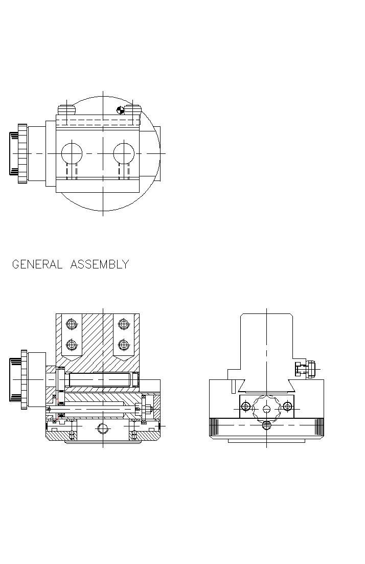

                  Graham Meek has sent me the following copy of his original design, which he feels may be usefiul for anyone wishing to compare or distinguish the two.

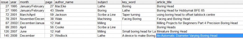

                  This also reminded me that a little while back I did a search for 'boring head' articles in MEW over the years, so any 'completists' may wish to check these out:

                  John Stevenson 1
                    @johnstevenson1
                    I like John's better, the feed system is far more compact and no whacking great knob wailing round to catch the unwary.

                      Ajohnw
                        @ajohnw51620
                        Posted by John Stevenson on 11/01/2016 16:33:07:
                        The whacking great wheel is good for making very fine adjustments when boring but a big dial with a hex socket and a long reach hex key is also good.
                        0.5mm pitch taps are available in a number of sizes up to 12mm dia at reasonable prices of late. Used for cctv board lenses. They seem to have standardised on the pitch to some extent.
                        Rather than gripping a knurled rim to face – have holes and put a piece of bar in.

                                John Hinkley
                                  @johnhinkley26699
                                  Blimey! I didn't expect it to get this much attention. So….
                                  Murray – No, I don't have any 3D drawings. It's about as much as I can do to produce the 2D ones. But if you're offering . . .
                                  Michael – I looked at the thread in my off-the-shelf Asian boring head and that was mighty small, probably in the region of 0.5mm pitch. That's why I've gone for 0.75mm, as I'm anticipating the generated forces to be higher on mine.
                                  As I tried to explain in the post above, the feed screw is 0.75mm pitch – I happened to have one – and the feed wheel has 10 cut-outs, so one turn of the feed screw turns the slide screw 2/3rds of a turn – 0.50mm, thanks to the 12:12:18 gearing. Thus, one feed "click" advances the boring bar by 0.05mm. By having the drive pins arranged in two diametrically opposed pairs, differing PCDs and engaging with the feed wheels at the same differing PCDs, drive can be neutral, selected for an advance of 0.05mm or 0.1mm. There is, therefore, no need for the expense of a left-hand thread. There is provision for holding the feed ring by hand or using a screw-in bar to prevent rotation.
                                  I'm on goodness only knows what version of the drawings – I've lost count – but I think I've found most of the errors and am about to freeze the design. Work has started on the slide and I expect to post some photos in an album in the next couple of days.
                                  Other changes to Graham Meek's admirable design were prompted by the fact that I wanted a bigger one – who doesn't – and what I have available in the way of tooling and materials, etc. For example, I happen to have suitable MOD1 involute gear cutters obtained for a previous project, so I am using them instead of having to make and use a single-point form tool.
