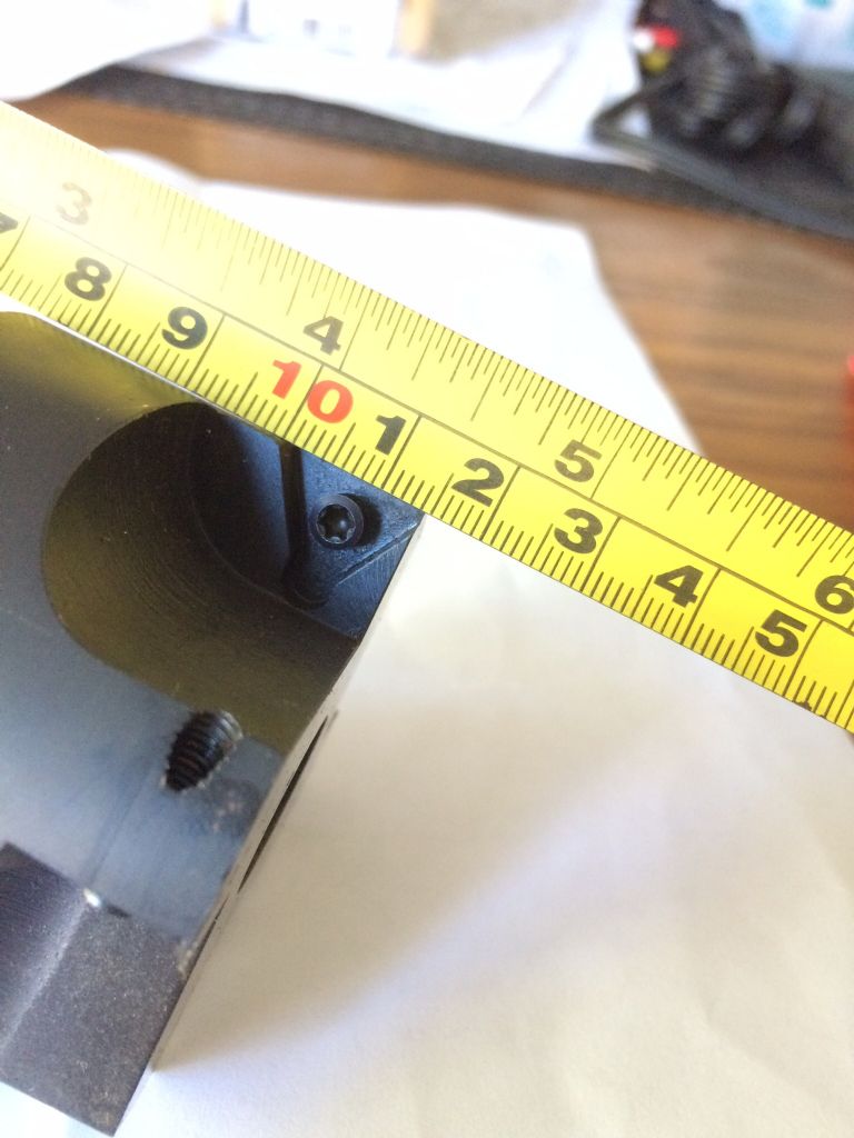

      I bought a load of facing mills from the ebay.
      Three of them take a triangular insert, I've never used triangular inserts before so have no idea what it could take.
      Any ideas please?

            TCMT perhaps….

                      Looks like 16mm triangular tips would fit. As I use 11mm triangular on my lathe I've been hoping to find a milling holder for those but no luck so far even for 16mm.
                      You might find that TCGT work better as they have more rake,

                            Triangular insets are usually defined by the inscribed circle …. probably 10mm in this case. TCMT or TNMG probably.

                                    So far 12 replies to this thread but I still have not seen any real comments on trying to identify what type of insert would fit.
                                    I would suggest that measuring the size of the triangular recess would give an answer to the basic size, the next determining factor is how the tip is held in place. If its a central screw then its most likely that the insert has clearance rake and is single sided. Reversible inserts (six cutting corners) have no rake and rely on the holder having an angled face and these usually only have a centre hole too small for any sensible screw so these just to sit on a peg with some other clamping device. Lastly triangular inserts are available with no central hole.
                                    A picture of the holder would help.

                                                    Strange, I wondered why you had asked for a picture.
                                                    Ive found an insert that fits, length is roughly 15.25mm but it has fairly large radius's's.
                                                    Measuring the tool the inscribed circle is 9.52mm (must have been a lucky measurement). This would make it 16 size inserts, although these should measure 16.5mm?
                                                    inserts need to be angled, so I'll measure the angle tomorrow.
