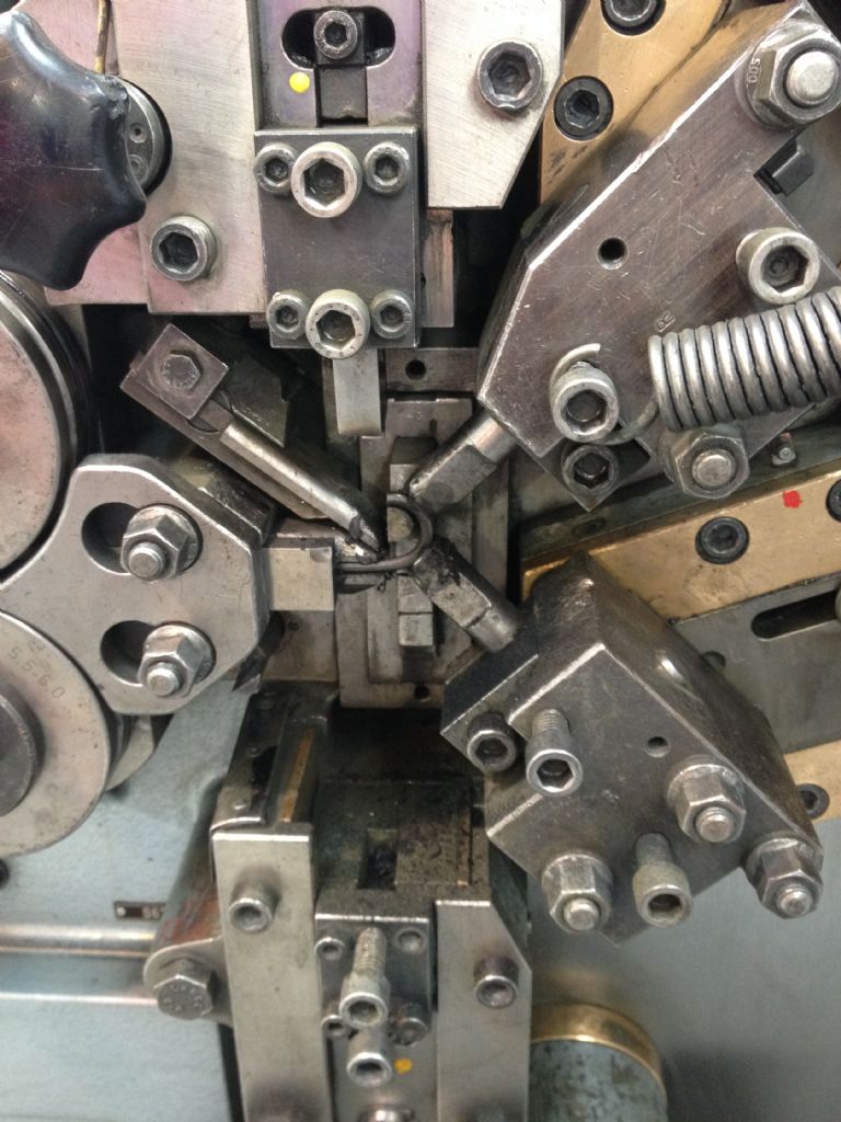

        Spotted this small machine at the Anson Engine Museum yesterday. Any idea's on what it was used for?
        #198163
          A wild guess … It looks rather like a spring-making machine.

                                  Looking like a spring maker or something similar that bends and forms. There are quite a few cam operated levers and no sign of any actual cutting (swarf), so doesn't look like a cam operated machine tool. This is the sharp end of a (helical) spring making machine – not a state of the art CNC type but still electrically programmed to some degree (a couple more in my album).
                                  Spring maker 3
                                  In the above photo, you can see the wire coming in from the left and being bent by the 2 fingers that are at 45 degrees. There is only 1/2 a turn at this point, as the previous spring has just been cut off (you can't see the blade which is outside the picture). Setting all the angles and distances takes a fair bit of trial and error, so hardly in the "one minute exchange of dies" territory.
                                  The mystery gadget doesn't look easily reprogrammable, so probably intended for making large numbers of identical parts in the same way that a cam lathe's operation is "programmed" by the metal cams. It's probably for making something like the spring used in clothes pegs! The action seems to be happening in the area at the very bottom of the middle of the photo, whatever it is.

                                    I think Lionel may be on the right track A chain maker? or maybe curtain hooks?
                                    The small crudely attached afterthought idler pulley wire guide suggests a wire forming machine.
                                    To the right of the persons fingers is what might be considered the jaws of a pair of pliers or pincers, they are mounted on a shaft that is able to rotating suggesting a twisting motion. at the top of the photo is a crank (part of the main shaft with its attached flywheel) that is connected to a bar that bears against the pincer shaft.
                                    The pincer shaft appears to be moved for and aft by a cam driven lever on the opposite end.
                                    A few closer and at an angle photos would help work it out.
