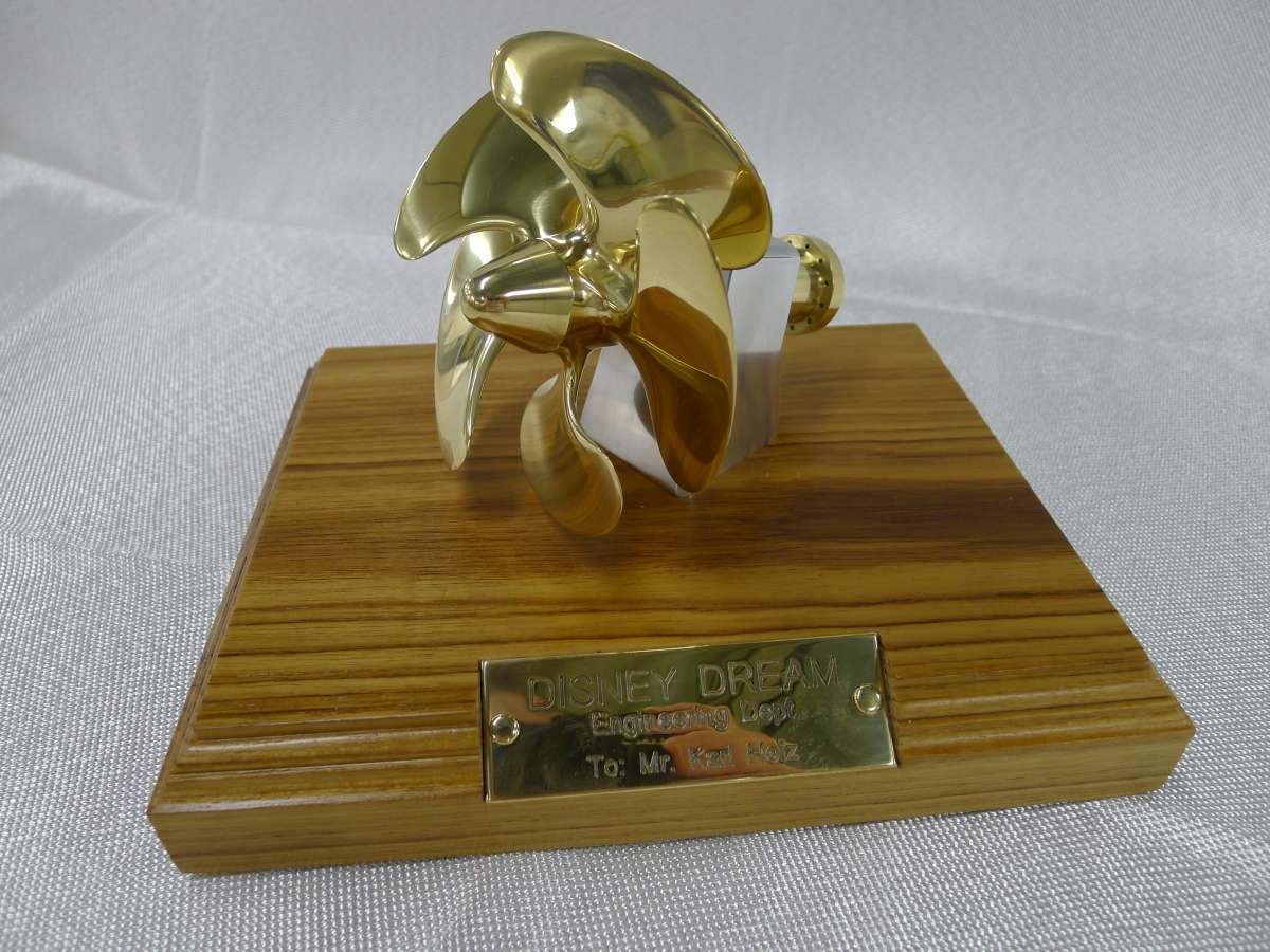

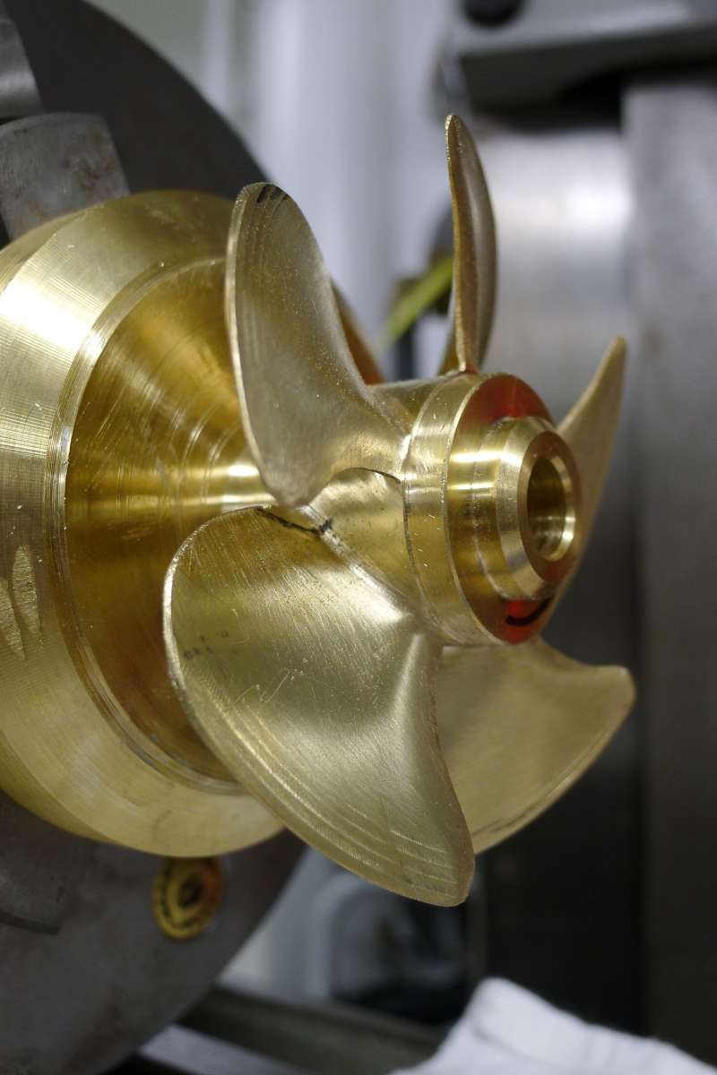

      Something I thought you guys might find particularly interesting.
      Over the years I have worked with some incredibly talented crewmembers.  Their machining and engineering skills frequently put most of the engineering officers to shame.  One guy in particular stands out in my memories, particularly with a project I discussed with him.  I was discussing with him the possibilities of making some sort of presentation to our company President, who was retiring.  He suggested a brass model of one of our propellers on a base, which I though was an excellent idea.  Unfortunately we were fitted with what are known as highly skewed propellers, which I thought would be something extremely difficult to model in brass.
      December 8, 2000a (6)
      He asked if he could have time to look into it which I was more than happy to do.  After a couple of test tries to prove his set up he eventually produced this item.  When you have enjoyed looking at it and thinking about how it could possibly have been made I will provide links to some video clips that will show you how he did it.
      When I retired a couple of years later he made one for me as well:
      25-08-12-05KarlHolzPropeller2
      And before anyone with a keen eye informs me that the real ship has six blades and the model only has five, the picture of the real ship is a previous one that had six blades and I haven’t got a good shot of the last ship’s props!

            I think most people would assume cast but it was machined from solid.

              OK gents, for those who may find this interesting, and being basically a model engineering forum I figured there would be some, I offer four video clips of the basic machining process.  I’m sure you can see what is going on from them but basically the dividing head is unlocked and so free to rotate.  It is connected to the table cross feed shaft with a gear train such that when the table is being driven automatically by the cross feed shaft, it is also rotating the dividing head.
              What is also very interesting and not immediately apparent is the fact that the pitch of the propeller blades accurately decreases the further away from the boss it is.  i.e. at the blade root the pitch is highest and at the blade tip the pitch is the least.  Frequently on model propellers the pitch is uniform across the blade but, on real propellers certainly of ship size, you will see this quite clearly in the blade design. The reason for this is that while angular velocity remains a constant across the blade the linear velocity, which is relevant to the speed at which the blade is cutting through the water actually varies with the distance from the centre.
              I asked the Chief Mechanic who made this how he worked out the gear ratios and he showed me his calculations.  I was stunned by his level of in depth engineering understanding.
              Anyway enjoy the video clips.

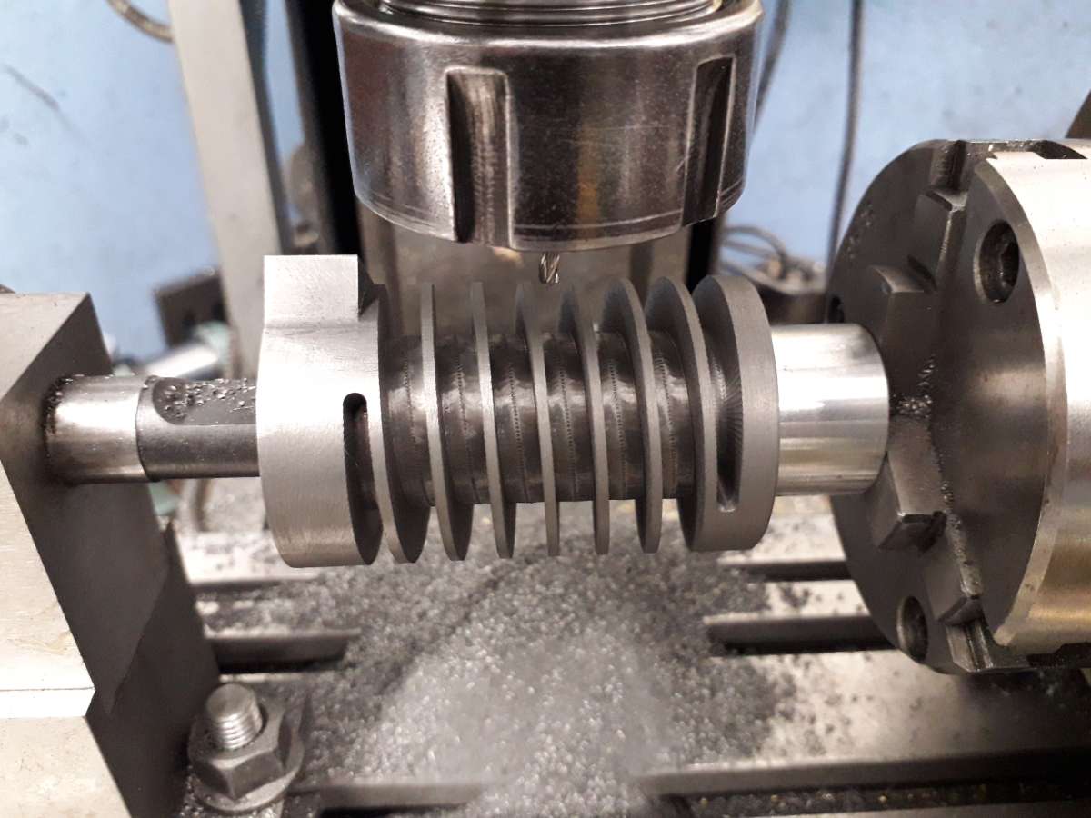

                  Pedant alert: I think the pitch is constant from hub to tip, but the helix angle changes. Having said that, propellor design looks to be fiendishly complicated, the blades themselves are twisted aerofoils, or is that aquefoils. Working out the gearing for thd dividing head would need several cups of strong coffee and an ice pack

                    I had assumed you would not have asked if he had access to CNC
                    I thought he may have made a wooden master blade and then used some form of pantograph copy arrangement to replicate the master indexing the workpiece around 5 times.
                    We do have a few members here who have shown similar gearing arrangements to rotate the work as it is fed, myself I have done similar to form a helix but used a series of increments based on a set angle and distance to advance the mill table. Plenty of handwork to finish the job.
                    20181228_193117
                    20190609_083221
                    I’m waiting for someone like Dave to make a comment about the setup in the videos but I’ll assume it is due to having to use what is to hand on the ship though it’s a bit of tooling I would have thought would have been available.😈 I can also see a reason why it may have been used rather than the usual method and it is not as though I have never resorted to it either.

                      Jason,
                      Whilst I remain in awe of your own work, I think the big thing here is that it’s analogue motion, not digital.
                      Any tiny ‘steps’ in the workpiece will originate from profile inaccuracies in the gears, rather than from the inherently digitised motion of a CNC machine.

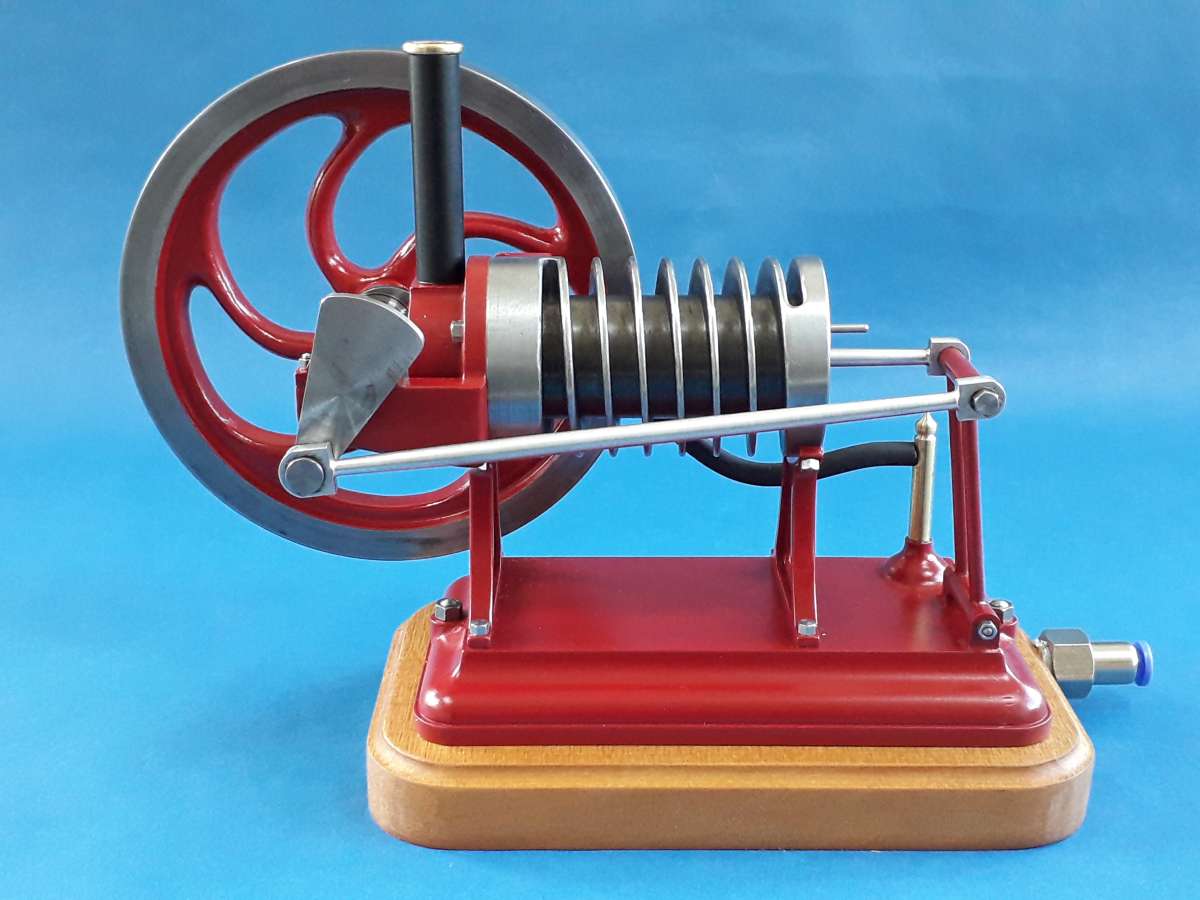

                            Just to confirm that model of mine was done on manual machines. But you could say the helix is digital due to using co-ordinates.
                            I’m not sure if there is any tapering in the thickness of those blades but if there is then any manual stepovers or angular adjustments to the dividing head would also leave facets or steps. The path the tool follows to any of those settings would be analogue.
                            #812486
                              So if there were changes to the pitch then the will have been some faceting of the surface to be blended out with plenty of needle file and abrasive work before polishing.
                              Noel, I can’t think of a reason that the original engines used the spiral fins. I just replicated it as best I could and enjoyed the challenge.

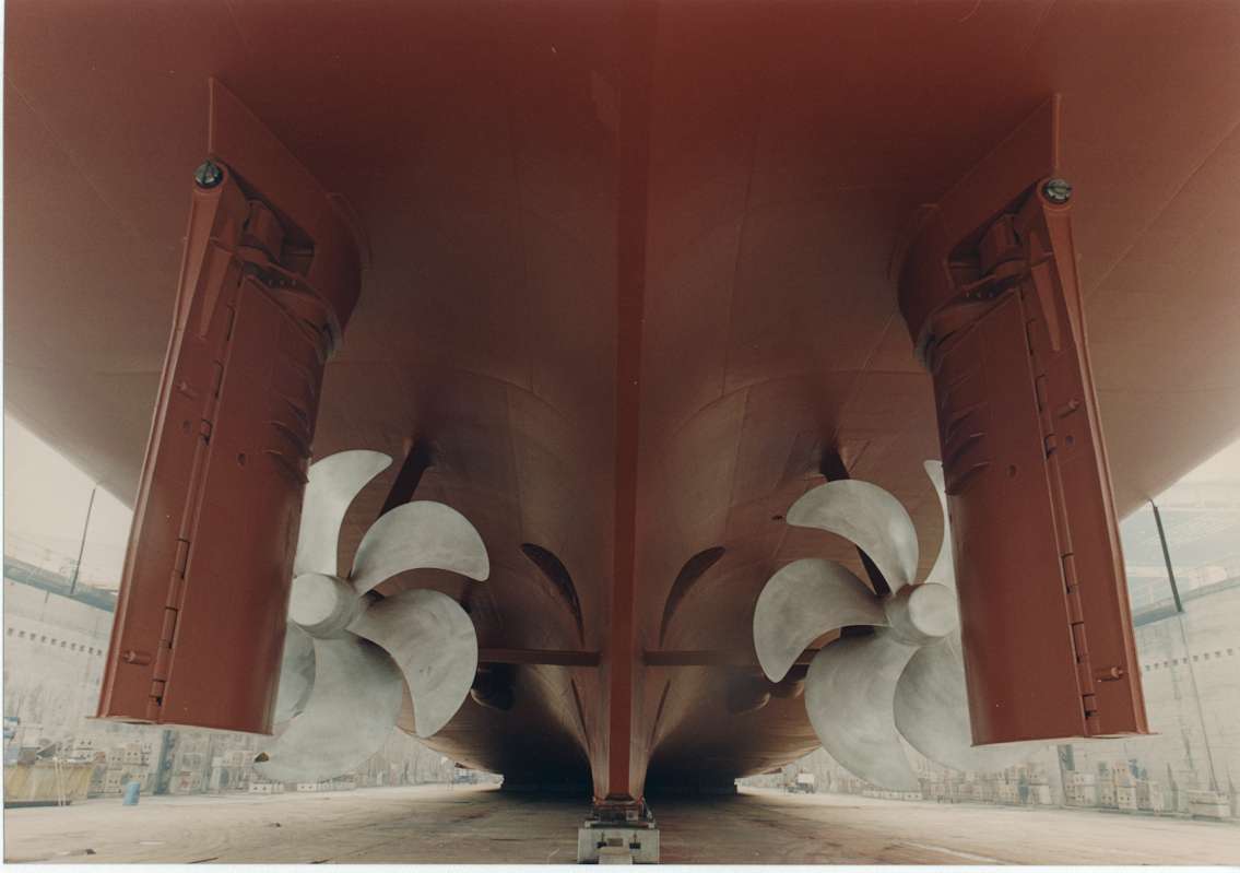

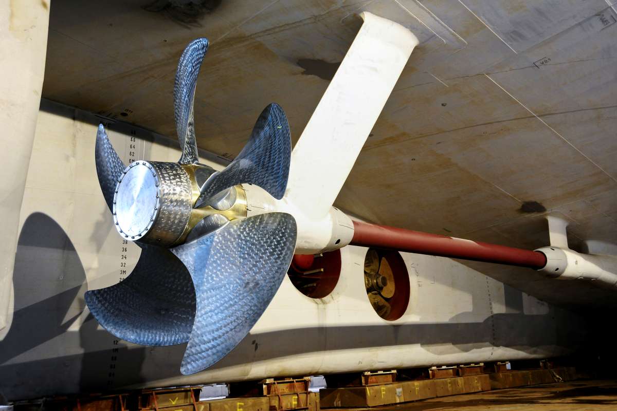

                                  This is probably the best shot I have of a marine propeller, where you can get a better idea of the shape:
                                  S687_DDream_Underwater-Ship-Area_DSC8415
                                  The model is made of brass, having a piece of bronze that size as stock would be a little over indulgent.
                                  Noel touches on an interesting point, going astern.  Propellers tend to be designed for the itinerary they are expected to be on.  Long lengths of time at sea under fairly consistent conditions require a particular design that is comparatively efficient under those conditions but which is then less efficient when manoeuvring or going slow.  Ships that require extreme manoeuvring capabilities, such as tugs, ferries and anchor handlers use propeller designs that give the best torque and response but tend to be far less efficient when full speed running.  All propeller design is a compromise to best fit an infinitely variable set of conditions.
                                  The most interesting, and frequently most misquoted are, what are commonly known as, variable pitch propellers.  However, as I’ve mentioned above, all propellers are variable pitch.  What is really being referred to are controllable pitch propellers.  These are usually found on ships that require very fast response and manoeuvrability but at the expense of efficiency.  These are nearly always found on tugs, anchor handlers etc. although when I first went to sea on small North Atlantic container ships they were fitted with Controllable Pitch Propellers, or CPPs, to enable fast ahead and astern movements to break the ice when going up the St Lawrence in winter.  That was in the days when fuel efficiency deep sea wasn’t as significant as it become a few years later.
                                  As for the pictures, the first shot from astern above is the Disney Wonder, they are around 20 tons of single cast bronze each and the single propeller is from the Disney Dream.  This one is of interest because it is fabricated not a single casting.  The blades are all bolted to the hub with stretched studs from inside.  A man can comfortably sit inside the hub while he spends all day slowly stretching the studs.  While basically fixed there is an ability to adjust the pitch by a couple of degrees either way to enable the best possible deep sea efficiency.  That propeller is a bronze hub and stainless steel blades and end cap.  Big advantage of course is that a damaged blade can be replaced, yes, even with the ship in the water.

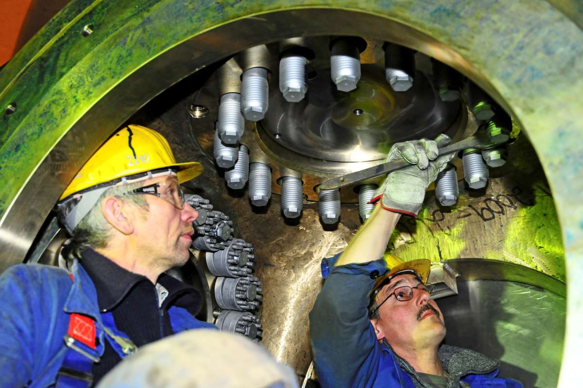

                                    Just out of interest a picture of the process of tightening up the studs on a fabricated propeller.  The bare studs can be seen on one blade and the nuts have been fitted on the studs behind the technician.  All the stretching is done manually, no hydraulics are used.  The nut is fitted hand tight to the main stud  with the ring of hex headed jacking studs all backed off.  Then begins an incredibly lengthy process of tightening the jacking studs, in a specific sequence and in a number of stages, to stretch the main stud.
                                    There are 12 jacking studs per nut and 18 nuts per blade.  There are five blades per prop and two props.  That is a total of 2160 jacking studs to be tightened up by hand, with a torque wrench, in a number of specific stages.
                                    S687_DDream_Propeller-Montage_DSC6660
                                    The hub is normally filled with oil in service.

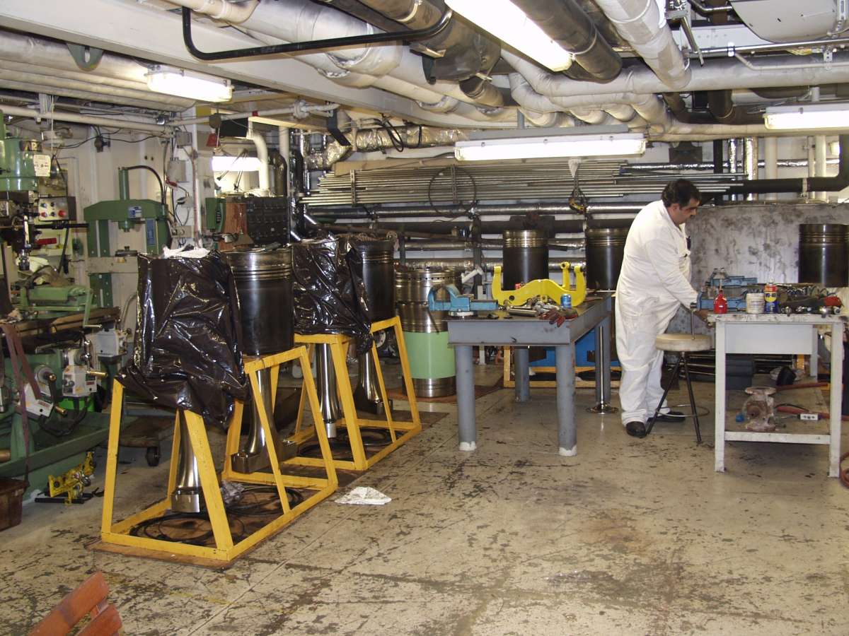

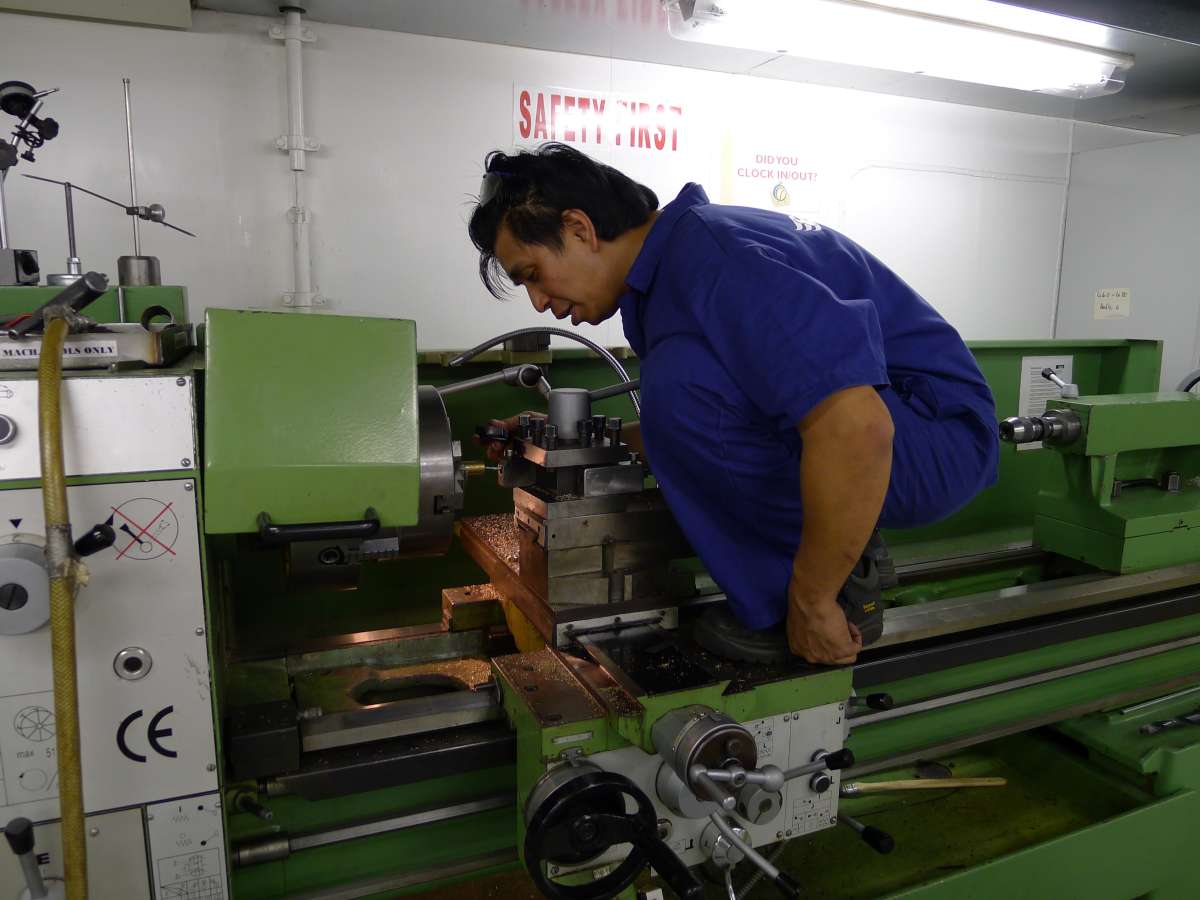

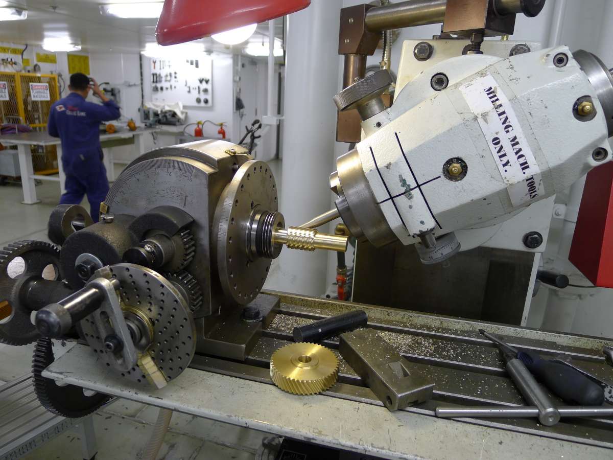

                                            Jason, despite the fact that I have in the thousands of pictures around the machinery spaces and many events such as dry docks and engine overhauls etc. I only have a few shots of specific items in the workshops and none at all of the workshops in general.  How could I have missed that over the years?
                                            In particular my last ship, the Disney Dream, had a superbly fitted out workshop with the usual array of large lathe, pedestal drill and milling machine as well as a separate welding bay with dedicated ventilation and even a separate area for the electrical team to have their own testing bench.  One of the first things I did was to arrange the purchase of a 7 x 14 mini lathe with accessories, justified of course by the need to make those small one off parts that the big lathe was too cumbersome to make.  Needless to say it was for our use in the evenings!  Having said that the crew were pretty adept at making the most of whatever machinery was available, as this chap demonstrates making a small bush on the main lathe:
                                            07-05-12-01DreamWorkshopRonTurning1
                                            This is a shot of the Disney Wonder workshop during an engine overhaul:
                                            22-07-01-12WonderDG512000HrServWorkshop1
                                            And this is another job being done on the milling machine.  This time I asked the lads to make a display piece for the Chief Engineer’s Office that demonstrated as many different types of gearing as possible.  This was all mounted into a perspex box so when a handle was turned all the different gears could be seen rotating.  I was always very conscious of the fact that the engine room crew tended to be out of sight and out of mind so I was always looking for ways in which the skills of the lads could be shown off to the rest of the ship:
                                            11-02-13-01MillingMachineGearCutting1

                                              Just another shot of the propeller model.  The machined blank is now in the process of being carved out to the basic shape, mainly with angle grinders and files.  As Jason points out the ‘steps’ the machining process leaves can still be seen at the periphery of the blade:
                                              02-09-11-03MachinedModelPropeller3
