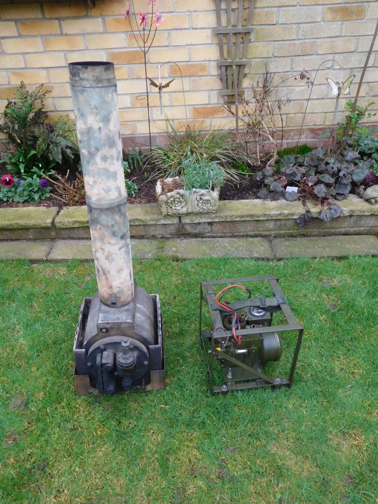

      Anyway – I am now in possession of one of the latter variants. It's been used quite a lot judging by the soot on the boiler, but I am intrigued by the fact that it's aluminium – and it's been full of water for the last thirty years at least!

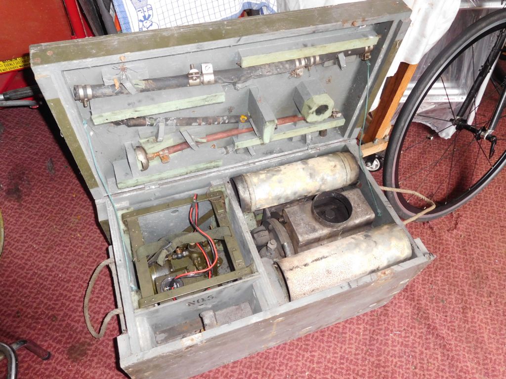

      Here it is in its box with all the connecting pipes clipped into the lid:
      Intriguing-looking piece of kit; I haven't connected up any of the pipes.

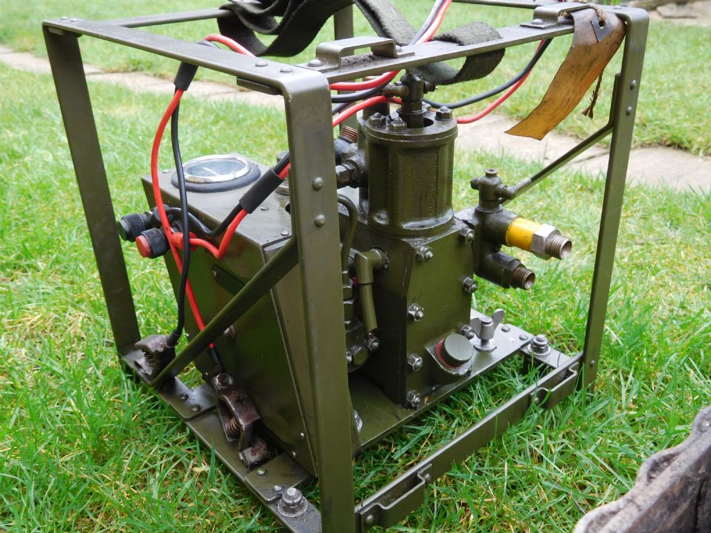

      The engine has a variable-stroke feed pump and an integral lubricator pump also. Exhaust is directed up the chimney to draw the fire.
      It even comes with a spare gauge glass in the box.
      Has anybody ever steamed one of these with its original cast aluminium boiler? Those pressure cookers we cheerfully use in the kitchen (only at 15psi) aren't a lot different; you don't hear of many of those exploding.
      I would imagine anybody wanting to run this device in public would have to make a new copper or steel boiler to get insurance for it.

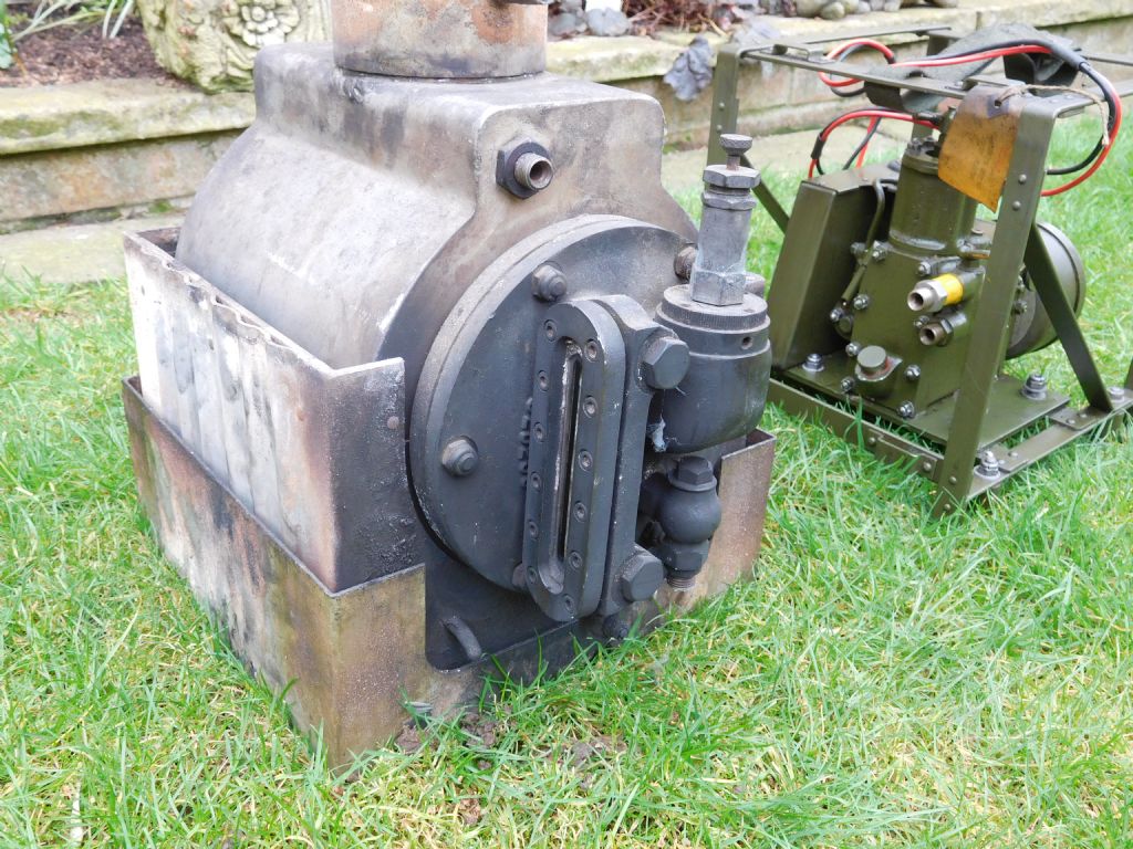

          Wow. Awesome piece of history. It looks like you could unbolt the front and inspect inside for corrosion. Pressure cookers usually have a safety valve, even if it's just a rubber plug. Does this have some sort of safety valve?

            Looks like a safety valve the other side of the water guage,

              I saw one of these sets ( or one like it) on display at a traction engine rally once. The owner had it in steam and powering the engine/ generator set to produce power to light a lamp
              . The owner said that the boiler was effectively in 2 halves which screwed together so it could be disassembled for cleaning out.
              On active service the water would often have had to come from streams or pools etc, I don't remember seeing a boiler feed pump or any boiler drain valves. The set seemed quite a big heavy thing but I suppose in the days of valve/ tube radios it was needed to recharge the accumulators without making a noise.

                Yes, Hopper; that's a fairly substantial safety valve to the right of the water gauge. The website I referred to said it was run at 60psi, so it would make quite a bang if the aluminium gave way. Funny stuff, when it gets old…
