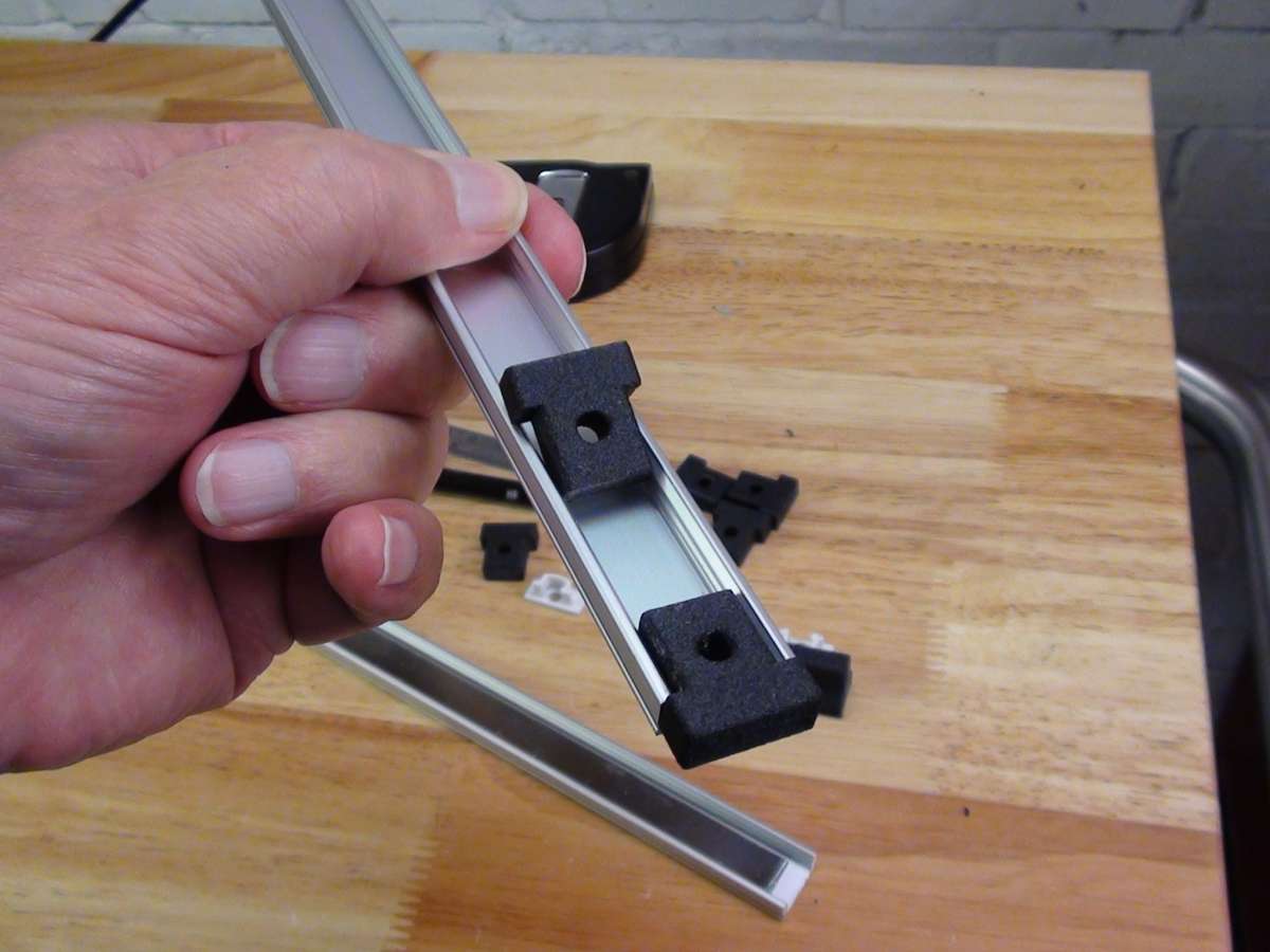

                        Failing to raise much enthusiasm for continued work on my present project, I turned my mind to the DRO set up.  I should say that the current system relies, at least on the Z-axis, on magnetic tape stuck directly to the mill column and the read head passes over it of course.  I didn’t like that idea much, specifically for aesthetic reasons, so I considered my options with regard to mounting the tape in a more pleasing manner.  I was hoping to mimic the commercially available scales, but in a lower profile due to the diminutive size of the mill. Casting my Google net far and wide, I happened upon some LED strip light aluminium extrusions which seemed to fit the bill.  They came with mounting clips, end caps and translucent clip-in covers.  I could only obtain them in in multiples of 6six, each 1 metre in length, but at £8.49 including P&P, who was I to complain?
                        I’ve made up a test piece approximating to the length of that required for the Z-axis:
                        Channel with end caps

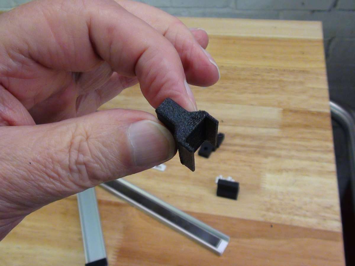

                        Fitting the ned caps supplied wasn’t very satisfactory , so I’ve designed my own version and 3D printed them in black ABS-GF as seen in the photo above.  They have a hole on them to secure the extrusion to the mill.  (In the background you can see the test scale.  This was put together before I decided to make my own end caps, so the gap at the end of the magnetic strip is too small and this will be remedied in the final version.  I noted that when I’d stuck the tape and stainless cover in, my alignment was, shall we say, less than satisfactory.  Alibre Atom and 3-D printer to the rescue again and a suitable tool was made to (hopefully) ensure that the tape and steel cover remain central to the extrusion.
                        Strip fitting tool
                        Not a very well composed shot, regrettably, but the better one was out of focus!  David Bailey I am not! The idea is that the tool has a Y shaped cross-section, with thin (0.8mm) wide legs which straddle the tape as it is laid down in the channel.  That’s the theory, anyway,  Whether it will work in practice, only time will tell.

                        andy198712
                          @andy198712
                          I’m really keen to see how you get on!
                          is that tool for the head or to stick the strip down centrally ?
                          #818722
                          John Hinkley
                            @johnhinkley26699
                            Sorry, I thought that I’d replied earlier this afternoon.  I must have forgotten to press the “submit” button . . .
                            Yes, the Y-shaped tool is to try to ensure that the magnetic tape and subsequently the stainless steel strip sit centrally within the aluminium extrusion.  I haven’t tried it out yet and before I do, I’m going to reprint it in plain PLA instead of ABS-GF, which can be a little rough to the touch.
