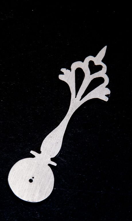

                                    Hi Derek
                                    I'm thinking quite small and fiddly here…….
                                    Norman
                                    This is about 2 1/2 times size

                                      Norman, I surrender !!! that WOULD be the piercing saw.enlightened
