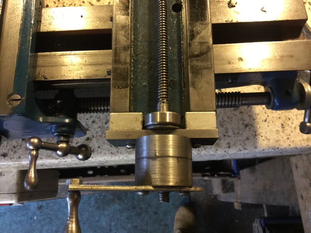

      Hi all,
      Need a length of acme rod for my ML1 cross slide which is bent any suggestions on a source I can only find american companies?
      Bit of a disaster really it came like it also with buggered handle threads. Straightened it as much as i could but its not good enough. I modded with the addition of bearings to make movement more smooth however when the handle is from about 12 to 3 o'clock the bend causes the outer handle to rub inside the bearing housing.
      Thanks,
      David.

          Probably best bet is to find someone (on a CNC forum) who is upgrading newish machine to ballscrews.

            I remember many many years ago my first lathe was a ML1 and I had a similar problem.
            So I swapped the acme cross slide screw for a length of withworth studding, I am not sure
            if I used BSW or BSF, I then made a new micro dial to suit the screw pitch.
            This lash up lasted me for years until I could afford a Super 7.
            Bert Ashton.

              Try Zapp Automation or Marchant Dyce, though stainless studding isn't a bad substitute for the short term.

                Think I'm going to have a crack at grinding an acme thread tool and machining a short test piece. I can grind the bit I have an acme thread gauge. However I'm not sure of the thread specs of the cross slide lead screw. Would any one know? its an ML1 as mentioned. I know the lead screw is 8 TPI not thats of any help.
                Thanks,
                David.

                  Done the same thing as Burt, used a bit of studding, metric 10mm was all that was handy at the time. made the nut in two pieces, the flat bit , and the threaded bush with a reduced bit on one end, which is tight push fit in the centre hole of the flat bit . So when i need to replace it , just knock the old nut out, then just push a new one in, & a new bit of studding
                  To get a good fitting nut i put four nuts on a gash bit of studding [ not tight , left them a bit loose ] then weld them up, J.S.-style, [ takes care of any lash ] then turn to suit
                  On an ml 1 though are you sure its acme & not a square thread, myford also had a spell using 12 tpi screws with 80 division dials,

                    Nope no suggestions as you haven't told us anything that can help only Acme which it may not be.
                    What size, what TPI, is it acme, how many divisions on the dial.
                    Sorry if this sounds harsh but an ML1 will have passed through many hands and the likelihood of it having been butchered is very high.
                    This is a unique opportunity to now do something about it and finish up with something far, more usable that when it was made.
                    Bodge mentions 12 tpi screws which were made and fitted, unfortunately 12 into 100 means you need a dial with 83.33333333333333333333 divisions
                    8 tpi will give you 125 divisions on a tiny dial and you then have to do the remainder 25 maths in your head.
                    10 Tpi will give the best option and a S/H one off an old ML7 could probably be adapted to fit.

                          Comparing with a vice and wheel jack lead screw, i’m sure you are correct. Not sure of an easy fix other than sourcing a replacement. Image attache (old) if you look jet behind the bearing you can see some porosity where i had to turn (with difficulty) the mashed and bent handle threads before fitting, welding and threading.
                          The machine is o.k. Gone from a chattering wreck to easily capable of taking 1/16 + cuts on free machining steel. Want to sell to buy something larger but A: I don’t want to sell some one a lemon and B: the more belles and whistles I have (which are extensive) the more value.

                              Unfortunately 12 into 100 means you need a dial with 83.3 recurring, but myford at the time didnt think that was too much to worry about, so like it or not 80 div, dials, [ though the dials werent to bad, resetable, and not made of marzak ] Also fitted to their so called 4 inch precision lathes.So any old bit of 3/8 ish studding will do !… 10×1.5mm gives about 60 thou p/rev or .005 indicated on dial is .004 movement of tool, So the general method is get it some where close, check for size with a mic, then take last couple cuts using dti,
                              A bit of a guess but would think the screw dimensions most likely 3/8 dia x 10 or 12 tpi more likely square , but could be acme. as J.S writes need a bit more info…
                              bodge.
                              Ah, just seen the pics & text,…..think you are now entering the realm of the law of diminishing returns, so try find parts at right money!!

                                Why not have a go at making one? My lathe has, as standard, a non-T-slot cross-slide. I also have a T-slotted cross-slide which was supplied as a special , but to use it requires transferring the existing handle & leadscrew from one bit of gubbins to the other, something of a pain and which doesn't really encourage me to use the T-slotted device especially as adjustment for smooth handle rotation can be a bit problematic requiring gentle adjustment withing the clearance of the three fixing screws.
                                My lathe (Warco 220) is metric throughout so I assume the leadscrew is metric. I've ground up a tool from an old file and made a gauge from a piece of 1mm steel, and experimented with it. First time was a disaster as the tool broke, and before I realised, nicely gouged the test thread I was making. Tried again, with complete success, so I'm now about to set about making the complete item.
                                Dimensioning was easy – measured the OD of the existing, and the pitch, and looked up everything on the internet and other places. Tip width was a problem – eventually I set the micrometer to the required value and did it by comparison of the tip against the gap.
                                I'm not sure what steel I should be using, but given the amount of use it will get, I suspect good old EN1A will be ok, and that's what I'm using. It runs in a brass nut incidentally.

                                  ''Sorry if this sounds harsh but an ML1 will have passed through many hands and the likelihood of it having been butchered is very high.''
                                  ''This is a unique opportunity to do something about it and finish up with something far, more useable that when it was made''
                                  I have butchered it in a good way (it has one previous owner). Only machine I could afford at the time, which my mentor was supposed to come and look at with me, however he developed medical problems and died shortly after so Im stuffed in all holes.
