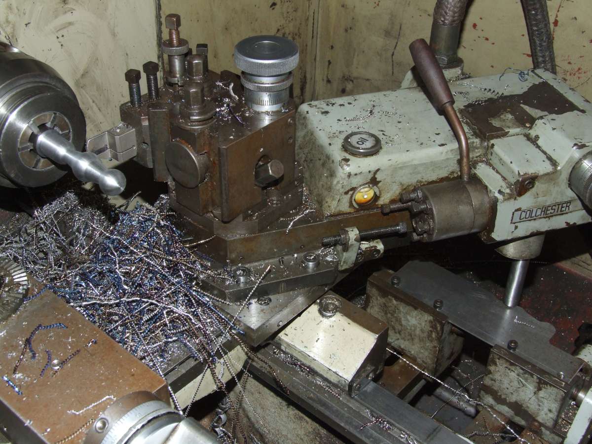

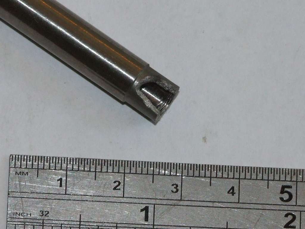

        I can confirm that ‘pure’ tungsten is a pig to machine. Turning is ok with carbide tooling but the material is brittle. This is the result of attempting to tap the end of a 6mm rod with a 2BA thread:
        Tungsten_ME
        Tungsten alloys are better, but only in the sense that ‘pure’ tungsten is very difficult. The alloys can be turned with carbide inserts and drilled with carbide drills. Tapping is a right pain. The alloys are very stiff so tend to grip the tap like a vice. When experimenting with tapping tungsten alloy I broke several expensive taps intended for high stiffness materials. The only taps that worked were a set of worn HSS Dormer taps, and that was at 50% thread depth. This is a tungsten alloy disc turned and drilled:

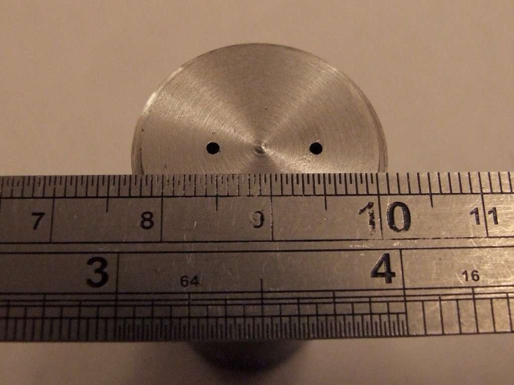

        Tungsten Small Holes

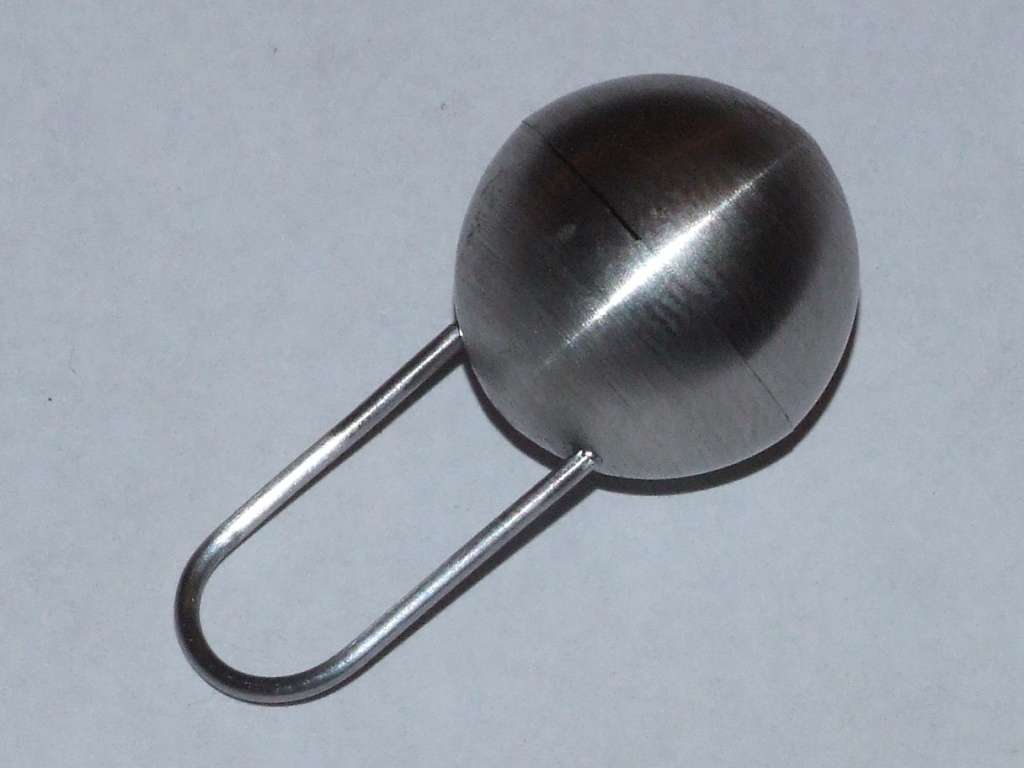

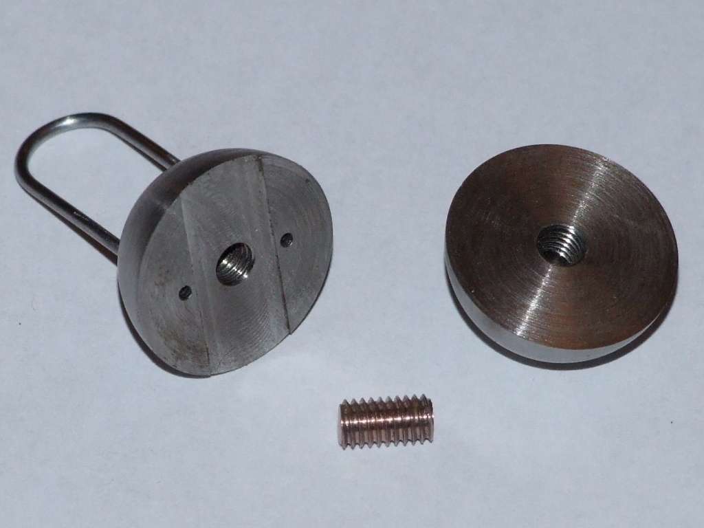

        The final parts:
        Governor Ball Parts
        The threaded rod was made from a 4mm tungsten TIG welding electrode. It threaded ok with a die. I can’t say how the tungsten alloy threads as I haven’t tried it. Parts assembled to form a governor ball for a model traction engine:
        Governor Ball Assembled
        All machining was done on an industrial lathe and vertical mill. I have no feel for how a mini lathe would perform.
        Julie
        Addendum: Pure tungsten is not pure. Due to the very high melting point of tungsten the material is actually a matrix. Pure tungsten consists of tungsten powder in a binder of a lower melt point metal. The combination is then sintered at a temperature above that of the binder but well below the melting point of tungsten. The same is true for tungsten carbide tooling, where the binder is usually cobalt.

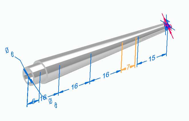

                            #834114
                              I’ve looked into machining Tungsten for my clock’s pendulum because they work best with a high-density bob.  By all accounts Tungsten is pig difficult.   Otherwise, Tungsten is a good practical choice because it’s twice as dense as Lead, isn’t toxic or radioactive, and is available and affordable.  Alternatives include:  Osmium, Depleted Uranium, Platinum and Gold.
                              Not tried to machine Tungsten yet, but being brittle and very hard, there’s a high risk fine details like threads will break.  See Julie’s comments. Therefore I suggest a design that minimises the amount of machining needed.

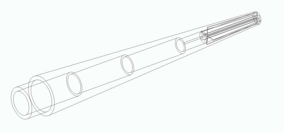

                              As designing from scratch is interesting, I had a go.  Comments welcome, I don’t claim the result is perfect!  It’s an Aunt Sally, presented for review in hope most defects and improvements will be spotted rather than wasting time on a prototype full of avoidable mistakes.
                              Practical men are encouraged to join in.  Armchair and computer job: I used SolidEdge CAD supplemented by the web and a dash of AI.
                              First try and get the requirements right!  Note use of “should” and “must”.  I suggest:
                              1. Materials must be available.
                              2. Materials should be affordable.
                              3. Design must, as far as possible, be doable on a mini-lathe.
                              4. Operations that cannot be done on a mini-lathe must be doable by other basic workshop methods.
                              5. Dart must:
                                1. Outperform lesser darts (Top priority – this is why we’re making it!)
                                2. Be of reasonable size and weight
                                3. Be comfortable in the hand
                                4. Fly straight and stable, point first
                                5. Stick into a dartboard without breaking
                                6. Allow easy replacement of delicate parts – spike and flights
                              6. Dart should:
                                1. Survive hitting hard objects accidentally
                                2. Look good
                              Requirement 1:  Tungsten, Brass, Silver Steel and Aluminium are all available.  Also paper or plastic for the flights.
                              Requirement 2:  All the above are affordable except Tungsten is pricey!
                              Requirement 3:  Met by limiting cutting to Turning, Drilling, and Threading. (Knurling optional.) Threading may not be necessary.   See Requirement 4 below for machining that can’t be done with a mini-lathe.
                              Requirement 4: (Non-lathe operations)
                              • Design calls for a R20 radiused bull-nose, suggested because it looks pretty.  Could be replaced with a plain chamfer, or shaped by hand.  Doesn’t need to be accurate.
                              • Design calls for the flights to be held in 0.2mm slots cut 15mm deep in the tail. Difficult to cut accurately by hand. I’d use a slitting saw on my mill.  Not ideal, suggestions welcome!
                              • Silver-steel spike easily turned on a lathe, but requires a small blowtorch for hardening and tempering.  Or accept it will bend, and make lots of spares.
                              Requirement 5-1:  inkmonkeh suggests Tungsten, a good choice, except it’s hard to machine, likely to break Requirement 3.   I suggest a simple Tungsten cylinder inside a shell made of a heavy metal that can be machined.  Brass is suitable for the body.  It’s a compromise.  The mass (35g) is lower than a solid Tungsten head (50g), but much easier to make, and less likely to shatter.  The extra 15g provided by solid Tungsten is tempting though!
                              Requirement 5-2 (size/weight):  Bad requirement, incomplete, because I guessed.  The proposed dart is 121mm long, diameter 10mm and weighs 41g.  Back to the customer, is that OK?
                              Requirement 5-3 (comfy): Bad requirement, forcing another guess.  10mm diameter feels about right to me but I’m a fountain pen wielding bureaucrat, not a dart player.  Jason mentions the advantage of thin darts being able to cluster; is that a requirement?  Customer to clarify diameter!  (Or, inkmonkeh experiment to see what works best for him.) For grip, I suggest a heat-shrink silicon sleeve rather than grooving or knurling the body.
                              Requirement 5-4 (flying):  Proof of the pudding is in the eating.   However:
                              • Design positions the centre of mass forward of the mid-point.  (The head is heavier than the tail)
                              • I don’t know what the optimum position for the centre of mass should be,  There’s an interaction with the flights, and whether or not the projectile is spin stabilised.  Getting this just right may be critical to meeting R5-1, making this better than other darts.
                              Requirement 5-5 (penetration):  Met with a steel spike, suggest home hardened Silver-steel.
                              Requirement 5-6 (breakages):  I suggest the spike be a replaceable push fit inside the body.  Accessed by unscrewing or unpinning the tail and dropping out the Tungsten core.
                              Requirement 6:
                              • My design’s Brass body is deliberately thin to maximise space for the Tungsten core.  Not much metal left at the body and tail joint, less if it’s threaded.  (M8 fine or extra fine).  It’s a weak point.  Could be pinned, but that’s weak too.  Don’t know how to calculate the strength, or what the worst case shock load might be.  More work needed.
                              • When the dart hits, inertia will hammer the Tungsten against the Brass body, and is likely to damage it.  A small replaceable O-ring would stop that.
                              • Replaceable spike and flights.
                              The Dart.
                              Outside view, the Green Dot marks the centre of mass, total weight less flights, 41g:
                              dartAssy
                              Spike, steel, weight 1g:
                              dartSpike
                              Tungsten Core – just a cylinder, weight 24g:
                              dartCore
                              Brass Body – front, weight 11g:
                              dartBody
                              Brass Body – Rear
                              dartBodyRear
                              Brass Body – Inside:
                              dartBodyInside
                              Tail, Aluminium, weight 4g:
                              dartTail
                              Tail Inside – drilled out progressively to reduce weight.  Slotted at rear for flights.  4x 0.8mm holes drilled on rear-face to reduce tail weight.
                              tailInside
                              Not happy with the tail.  Looks good, but Requirement 6-2 is a should, not a must.   Replacing the tapered and much drilled Aluminium with a simple straight wooden shaft is well worth consideration.  A straight shaft would move the centre of gravity forward, reduce the overall weight, and be much easier to make.   My 0.2mm slots for the tail need looking at too – must be a better way!
