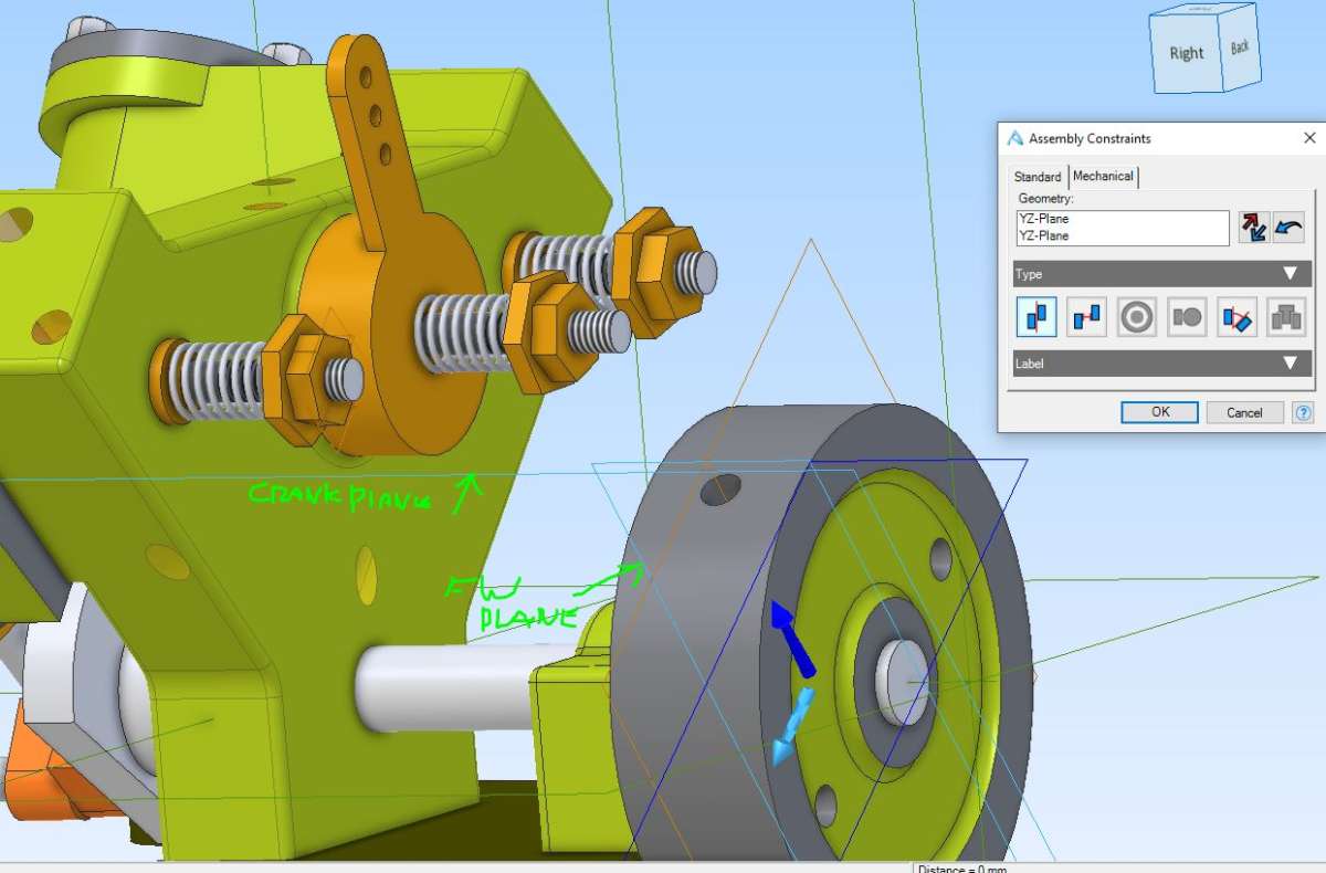

        Right click the two item in turn and select “show reference geometry”
        Constrain one vertical plane of each item
        Click again and remove the Show ref geemetry
        The two will now rotate as one.
        I do this so that things like flywheels and eccentrics all rotate together when the crankshaft is rotated

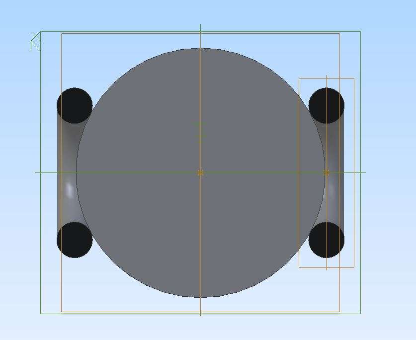

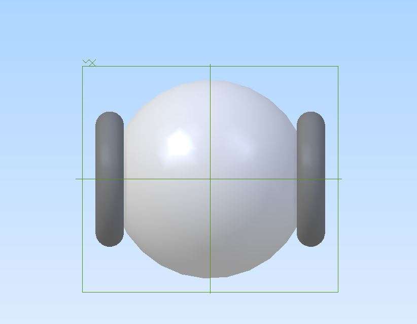

          Also no need to eyeball the O ring position. Similar show ref geometry can be used to make the ring and ball concentric to the bore of the body. Then a Tangent constraint to make the O ring touch the ball valve. Mirror takes care of the O ring on the other side of the valve. I have not shown any compression of the O ring.
          ball 1
          ball 2
          #827590

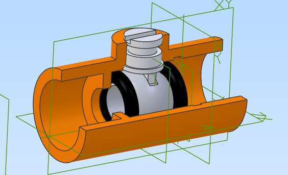

                                    I suppose you don’t need electric motors on your machines when a treadle lathe and hand brace will do but some people move with the times😉
                                    This is what it should go together like using a fairly small number of constraints. I also section the main body in the assembly so I can see what I am doing which is only a “View” not an actual lump cut out the part. I also section the other parts at the end.
                                    Note. If making use of Reference Geometry as I show then the parts need to have been modelled correctly as if you eyeballed the position of features on the individual parts then they may not line up with the 3 axis and planes used as the Ref geometry

                                        Anyone spot the mistake?
                                        #828124
                                        blowlamp
                                          @blowlamp
                                          Is it that the screwdriver slot is 90 degrees out, so it doesn’t indicate the on/off position? 😉
