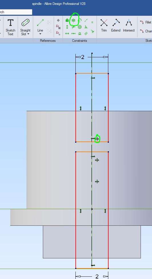

        Nigel. As I have said several times when I put up a video click the “Youtube”  that comes up once the video is playing this is at the bottom in the black bar. Then when in youtube click bottom right of the screen on the two diagonal arrows to get full screen. This will come up crisper than watching on this website. Yes it is still a bit fuzzy as the free screen video software I use is not that high a resolution but a lot better than not watching on Youtube..
        Again as said many times I use Alibre Pro but all the tools I used should be available to you in Atom.
        As for 5 to 6 decimal places. Taking your 2mm slot as an example. If you just draw a rectangle, give it a width of 2 then it will indeed be 2.0000000etc. But if you just place that centrally by eye you could have 0.999999mm on one side and 1.000001 on the other. The only way to ensure it is truely central is to constrain it, eithe dimension one side so that it is 1mm from the central axis but better still use the “symmetric” constraint and that will place it equally about the ctr line. The advantage of this method is that should you subsequently change the width of the slot it will always be central
        The top rectangle here was my sketch for the slot, you can see the symmetric constraint ringed and the icon to use at the top. I have also placed a second 2mm wide slot by eye that looks like it is also in the middle but if I were to measure it is actually 0.003mm off.

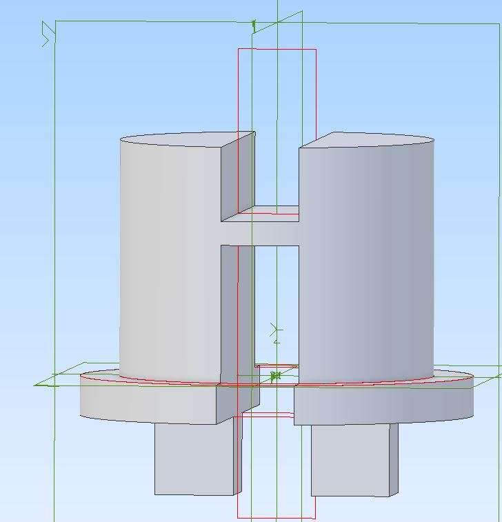

        Nigel Graham 2
          @nigelgraham2
          I tried to align them by constraints. I’d read a previous instruction as meaning to use the objects’ reference planes, so tried to put them together.
          That didn’t work so I tried to constrain the surfaces of one side of the tenon and slot. That didn’t work either.
          The only bit I aligned visually was the right-hand O-ring because I could not define anything to constrain it to. I ought to have represented the clip retaining the real one.
          The left-hand one sticks to the circular bulkhead next to it.

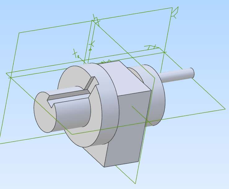

          The problem I find in assembling anything is forever over-constraining them without really knowing which constraints are wrong and why, because the error warning highlights all the wrong ones.
          As I see it the constraints lock two part surfaces together, and using two or more risk locking them rigidly, but it’s not clear which to use where, if you want one part to move on the other in only one way, or one moving part to make another move..
          So I created the attached, with just three simple Parts, to try to see just what does what.
          The shaft with its keyway, enlarged head and handle is a single Part. The journal and keywayed disc are merely drilled to the same diameter as the shaft.
          I constrained:
          The shaft concentrically with the anchored journal, and the inner face of its handle disc to the face of the journal.
          The other disc concentrically with the shaft, and its inner face to the journal face.
          Four constraints so far…
          Pulling the handle round did not seem to do much so I cut the two keyways initially to indicate any movement.
          This proved the handle revolved the shaft in both the journal and disc. The disc stayed still so I thought it was stuck to the block.
          Trying to constrain the disc face and shaft surface over-constrained the lot, with all the previous constraints now listed as wrong!
          So I deleted that last constraint, and then constrained the lower edge of the disc’s keyway with the adjoining edge of the shaft keyway. This time both parts revolved as if keyed together.
          A further test showed the shaft and disc would revolve as one, but not slide sideways.
          I had expected the disc to stick to the bearing, or slide along the shaft, or some similar failure, so was surprised when it all worked. I am still not really clear why it worked: I used inspired guess-work at best for some of it.

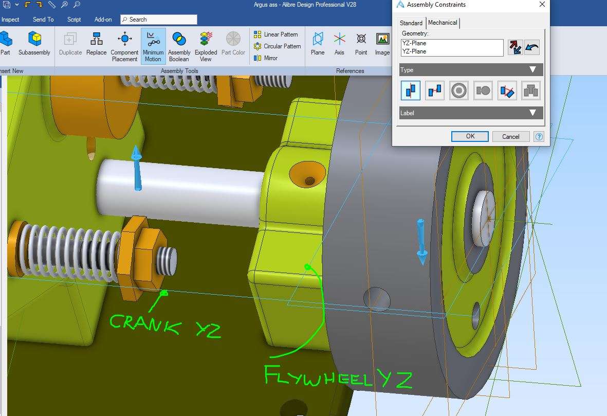

            Going back to what I said about assembling the valve, the same applies here.
            Best think how the real valve works. That small lip around the bottom of the spindle runs against the recess at the bottom of the vertical hole. So constrain those two surfaces together just as they would be on the real thing. Then the spindle can’t move up or down as you try to rotate it with the mouse.
            The CAD does not know what the parts are supposed to do until you tell it. That is why just like if you were assembling the parts in your workshop the disc did not turn with the handle. We have to put in keyways to drive gears or a flywheel as one with the crankshaft so that is what you eventually did to get it working. Had the CAD treated the journal like the disc and made the two move as one that would not have been what you wanted so you can’t expect the CAD to do one thing for one pair of parts and another for a different pair. YOU HAVE TO TELL IT.
            The CAD was not to know if that disc were say a bearing that you where then going to assemble into a housing in which case you would have wanted the shaft to rotate in it not move as one.
            However if the disc was intended to be Loctited to the shaft then you could not draw and constrain keyways so the other method I have shown would need to be used. That is right clicking each part, selecting “show reference geometry” and then constraining one plane passing through the crankshaft with another passing through the disc.
            This is an example where I have constrained the flywheel to the crankshaft as it is retained by a grub screw not a keyway. You can see the two planes marked in blue and I have noted what each is. Click the pictur ebelow and it will come up larger and clearer
