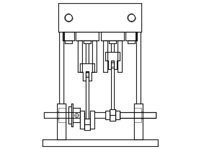

            A little bit of work in QCAD – and putting the parts together it looks like this. There are still a few bits missing, but it can be seen how it will look. Back into the workshop to transfer some of my ideas from paper to metal…

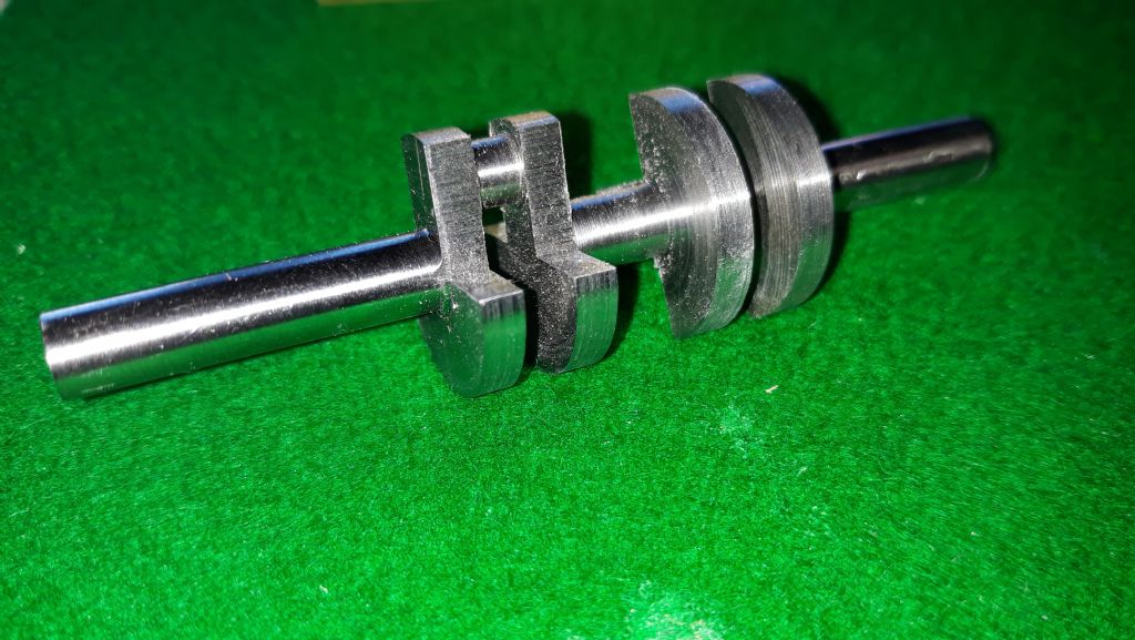

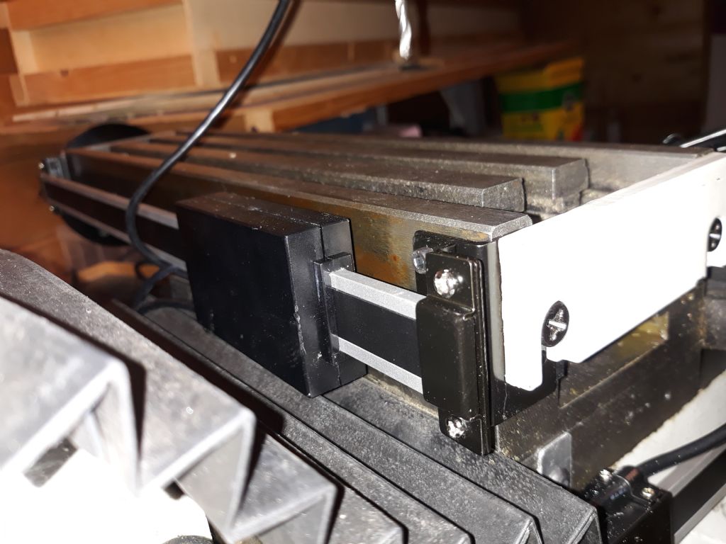

              After some break a sign of life. A crankshaft has arrived. The first one I made I killed during milling, as it flexed and the milling cutter caught deep into it. All bent, cutter broken.
              I improved the clamping by making exact matching packing pieces to grab the shaft in a normal machine vice, I had it in a turning table during my first attempt.

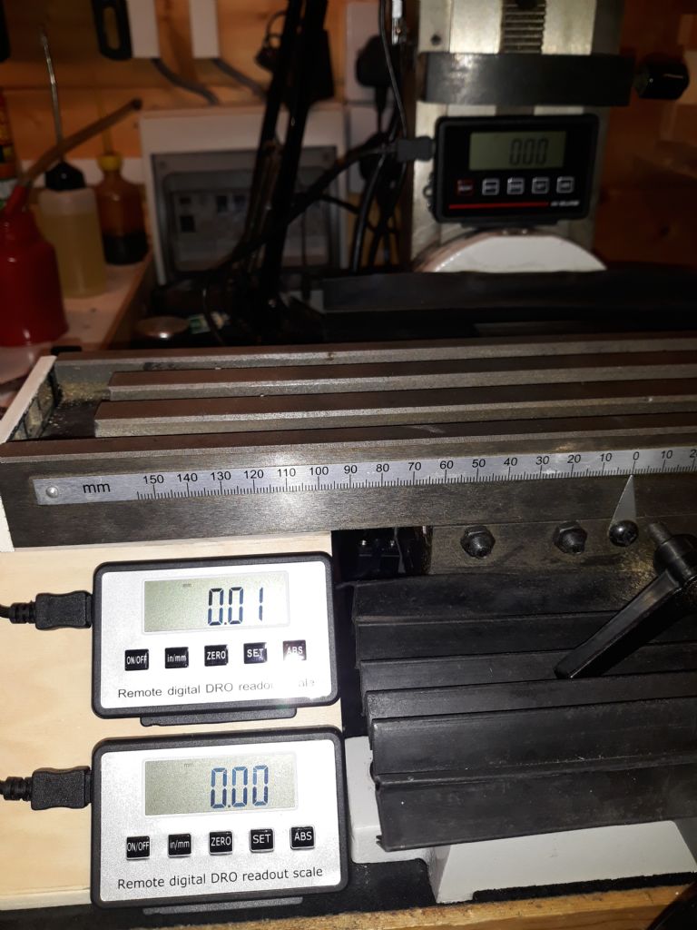

              I also invested into a cheap DRO for the other 2 axis of my Sieg SX2, all 3 axis together under 100£

              Here the second attempt, still not perfect but it shoud do it.
              Unbelievable how much fine metal pieces and/or dust are on the part. You hardly  see it with the naked eye, but the photo is cruel. Everything comes to the surface….

              Ady1
                @ady1
                I've found those cheapo dros great, you can stick then onto anything and get very reasonable results

                Nigel Graham 2
                  @nigelgraham2
                  Interesting project! Looking forwards to seeing it progress.
                  Looking at the drawing, you might need make an offset connection between each eccentric-rod and its valve-rod, but that should not be particularly difficult.
                  You seem unhappy with the milled finish on the edges of the crank-webs, but they should yield to careful draw-filing. I used that recently on the milled rectangular part of an operating-lever, and succeeded in replacing the cutter-arcs with a lovely satin sheen.
                  Wind a few layers of electrical insulating-tape or masking-tape around the pins and shafts to protect them from accidental slips of the file.
                  Those basic DROs can give good results, but some types at least are very prone to failure by swarf or even the thinnest layer of lubricants like cutting-oils contaminating the reader unit. As I have found….

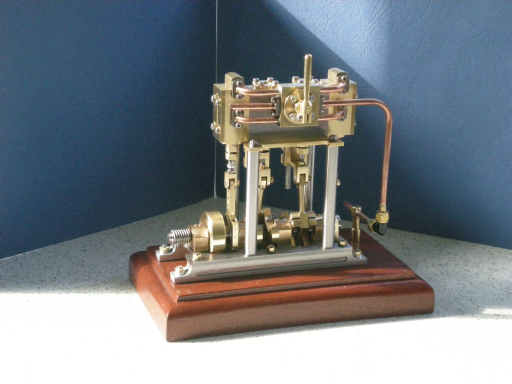

                    Jim Nic
                      @jimnic
                      This picture of my version of John Moore's Paddleduck engine shows a similar layout to Gerhard's.
                      In this design the eccentrics are located outside the crankshaft bearings whereas Gerhad is showing his inside. There appears from his sketch to be plenty of room for this without resorting to offset valve rods. Paddleduck has 3 main bearings which are necessary due to the built up crankshaft but could be incorporated to add stiffness anyway.
                      The 90 degree crank offset does indeed allow for self starting from any position and also in either direction depending on the throttle valve position.
                      Jim
                      #539863
                      Gerhard Novak
                        @gerhardnovak66893
                        Posted by Hopper on 14/04/2021 23:53:37:
                        Looks good. Is it usual to have 90 degree crank offset on such steam engines?
                        As Jim said this setup allows self starting from any position. As you have double acting pistons (minimum on my model) you divide the power into 4 equal parts, with a peak every 90 degrees. This gives you the smoothest running possible. Of course, the power is not completely equal between the piston going up or down, as during the "up" cicle you lose the area of the piston rod and you may have some loss due to the gland packing of the rod.
                        But let's leave this aside, I am happy if the machine runs!
                        Jim, lovely machine! You went for a reversing valve – am I right?
                        I am not sure what to do – I would like to have a Stephenson valve gear, but there is not too much space available. Anyway, I can make that later, I just need to leave enough vertical space for it.
                        #539881
                        Jim Nic
                          @jimnic
                          Gerhard
                          The reversing valve was part of the design as it is intended for use in model boats. It works well by crossing over the airflow across the piston valves, although mine leaks a little air mainly because of my inexperience of machining (it was 10 years ago!) It also acts as a throttle control.
                          Jim

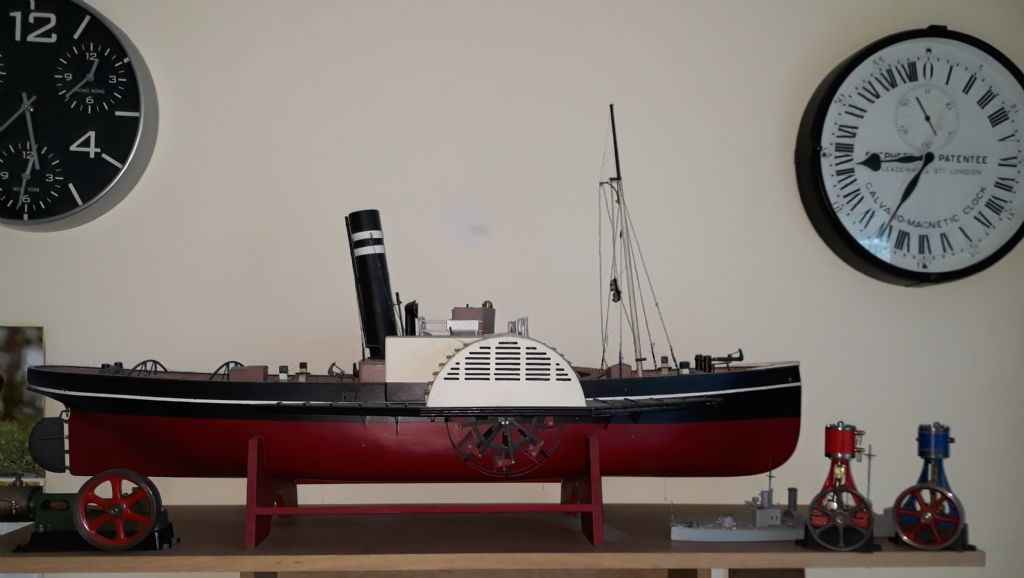

                          Gerhard Novak
                            @gerhardnovak66893
                            I have actually seen this design also for other model boat engines. By the way – I have a swimming bath tub in my office – my late fathers masterpiece. The Reliant. If you ever have been in the Maritime museum in Greenwich you may have seen one of the engines (full scale) and a model. My dad built this years ago, and after he passed away I drove to Vienna to get it over. Didn't want to post it, you never know what arrives.
                            It would be a project and a half to put the two twins into this boat. Probably it is too small for that, but it could take one horizontal twin like for instance the Stuart Score. Length of the model boat is 40" – same as the model in the museum. Of course I have also a replica of the Greenwich clock on the wall…
                            #539919
                            Jim Nic
                              @jimnic
                              A lovely model. I'm not a boatbuilder myself but I always admire well made wooden boats and ships such as that.
                              Jim

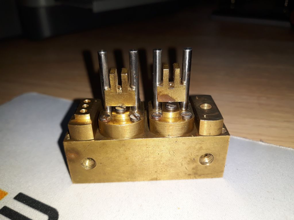

                                Gerhard Novak
                                  @gerhardnovak66893
                                  Just to let the readers know that I didn't completely stop working…
                                  There is much going on, a planned house move and all the related decluttering ect. If it happens I will have a 7m long workshop (others call it garage)
                                  Anyway.

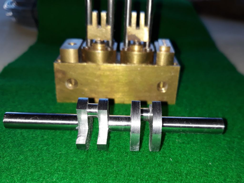

                                  Cylinder block fixed to the bearing blocks. Crankshaft already starting to rust…. My fingers must be acidic…
                                  And I am fighting with the album. No matter how I turn the blooming photo it is always at its side…. May be time to update the forum…
