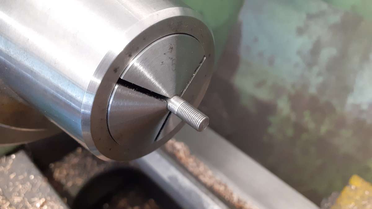

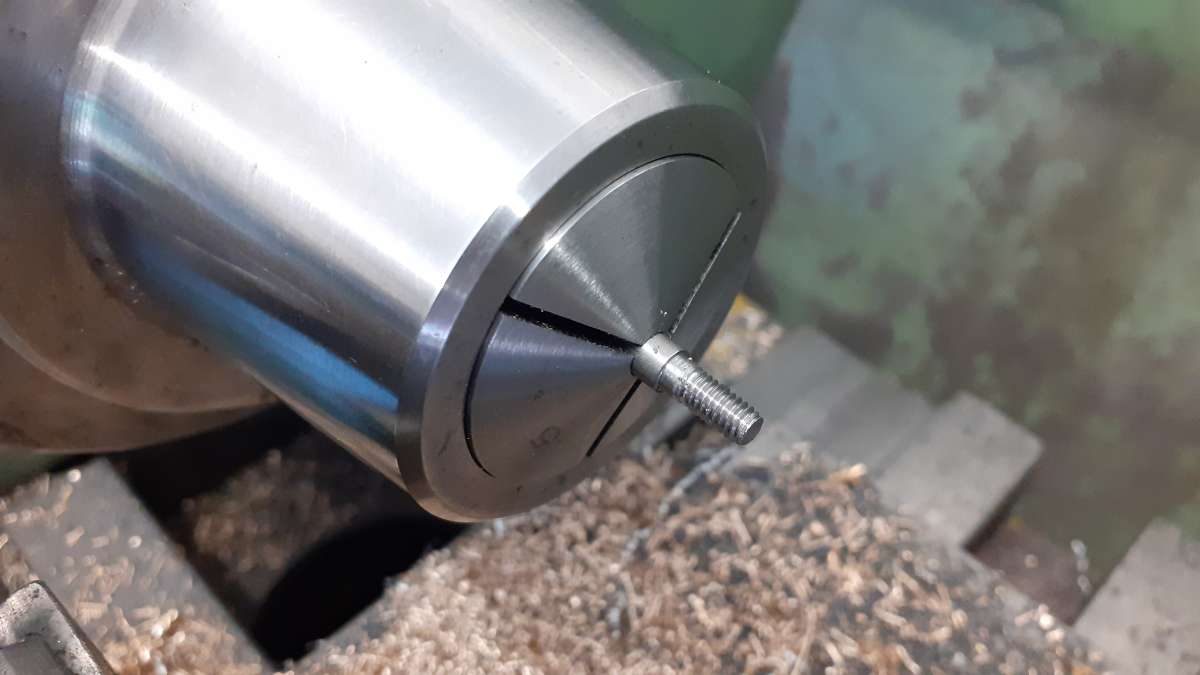

              £)£ should be OK with Carbon or HSS. This is one done a week or so ago.
              M4 x 0.7 on the piston end, Split HSS die by Volkle
              20240625_141956
              For finr adjustment I tend to go with M5 x 0.5 at the other end but would not have thought twice about M5 coarse. This cut with a solid HSS die by ARC
              20240625_142454
              Stainless is the usual choice as you don’t want any rust pitting which will make the rod rough and it wil lwear your gland packing.
