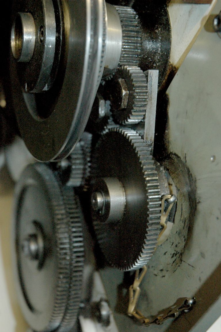

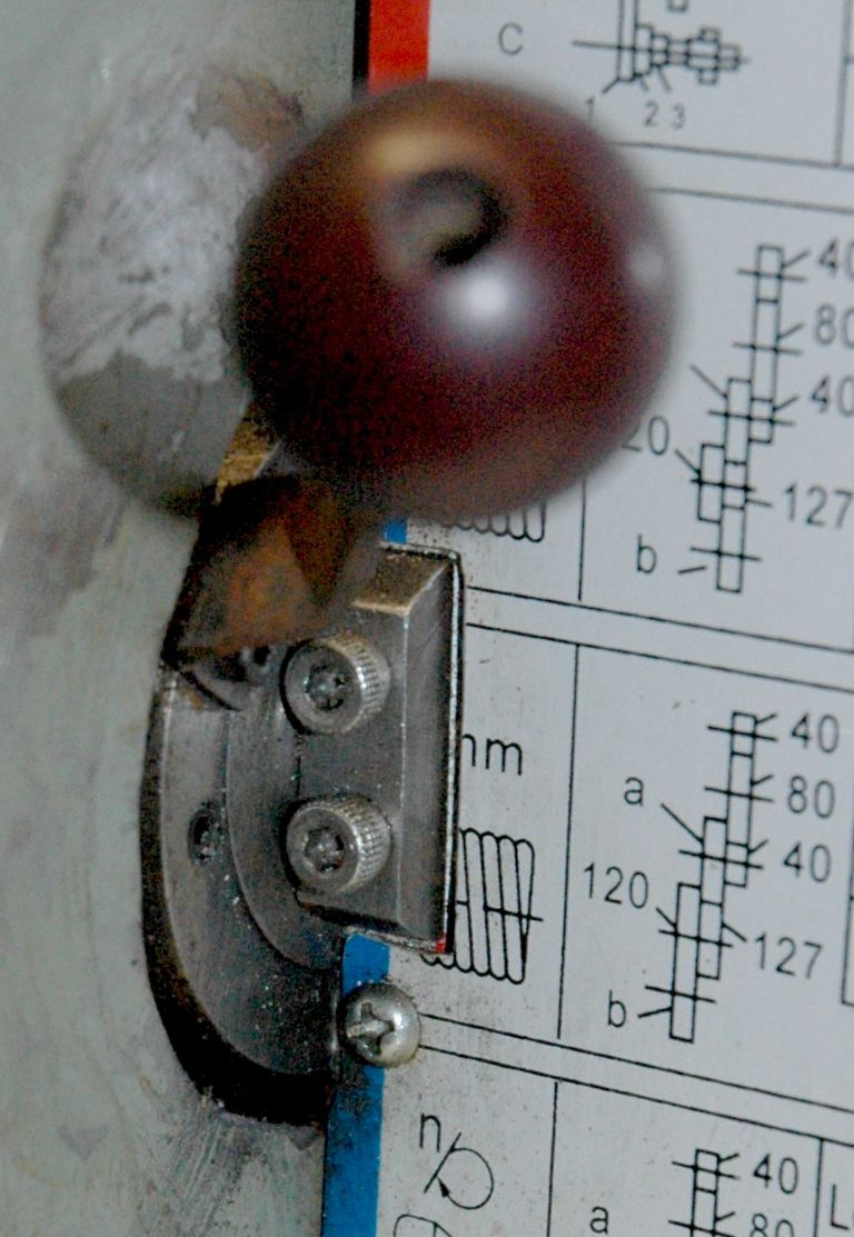

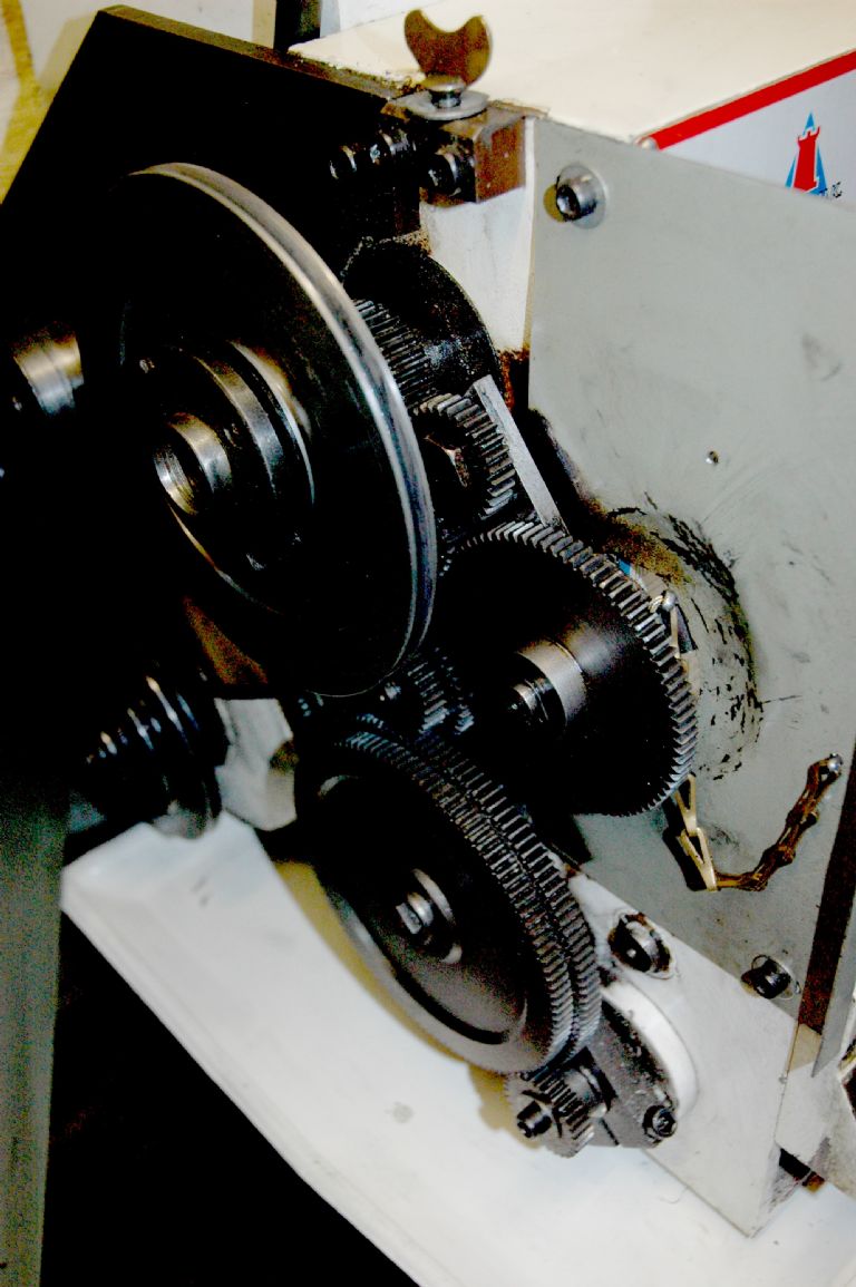

              The other thing I was on about was the tumbler reverse mod thats been done to the lathe Here are a few photos.
              So if anyone recognises this mod can you please let me know what it is So I can go through to see if it is set up correct.Because when you engaage it it keeps throwing back out again?
              Regs Andy

                #96906
                Les Jones 1
                  @lesjones1
                  Hi Andy,
                  The tumbler mod could be a variation on Steve Bedair's design.
                  Steve Bedair's tumbler design.
                  Les.

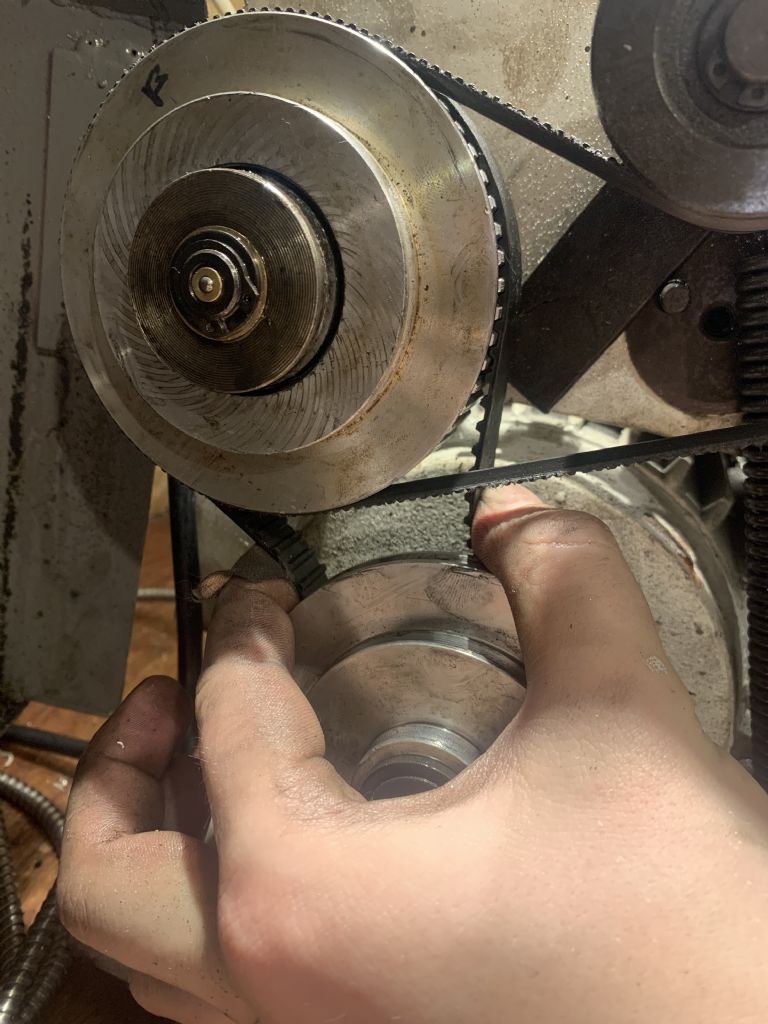

                        Thanksw Kwil and Del will have a look on Davall site and The lathe still only has the two bolt compound at the moment. But iv also come across another problem with the belt The 710 which it has on now works perfect on the top pully but when trying on the bottom it is to tight and drives even without using the clutch .Which would suggest the 730 but i dont think the 730 would work on the top pully as it would be to loose?
                        So have to try n work that one out.
                        I am missing just the turn of a knob to change the speed though the Conquest was variable speed. I might look into trying to change this to variable as it would be a lot better i think..

                                #97265
                                Aestus57
                                  @aestus5782081
                                  Hi Andy,
                                  Have you looked at the adjustments that can be made on the motor and "countershaft" pulleys.
                                  They are both adjustable on my 920, but very awkward to get to. The motor will slide vertically on its mounting and the countershaft has a small radial slot which it can slide in. Its a bit of a juggle to get them both in a position that the belt will engage all the pulleys easily, but it can be done.
                                  Hope that helps
                                  Peter

                                    #97281
                                    Derek Drover
                                      @derekdrover32802
                                      The drive belt on mine appears quite loose on the top pulley, till the tensioner takes up the slack, and does also appear tight on the bottom pulleys (like it doesnt need tensioning), but it does work ok. These models are sometimes prone to slipping in the highest ratio speeds, so the belt does need to be quite tight.
                                      ta
                                      del.
                                      #97312
                                      Oshb5s
                                        @oshb5s
                                        Hi
                                        Yes I think I can lift the motor up and slide the other out which will help But not help me that iv ordered the 710 belt from the US lol
                                        Never mind..
