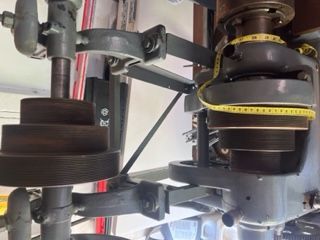

      I have an old 1920s LM lathe which requires a new belt, I need advice on how the spindle is removed so I can put the new poly V belt on

          1920s with Polyvee that's novel and it proves the spindles been out before!

              Whichever lathe it is they tend to come out of the front
              #645600
              Dave Halford
                @davehalford22513
                T&LM – I had one of those. If it is just don't take the felts out
                Most 1920 lathes were built like this the section drawing will help you understand

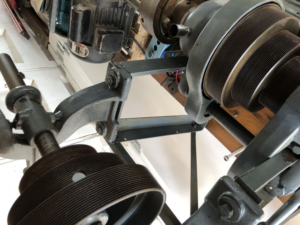

                #646193
                Aston Manning
                  @astonmanning46959

                      A very logical upgrade yes
                      … dead easy to cut a set of shallow vee-grooves in an existing flat-belt pulley

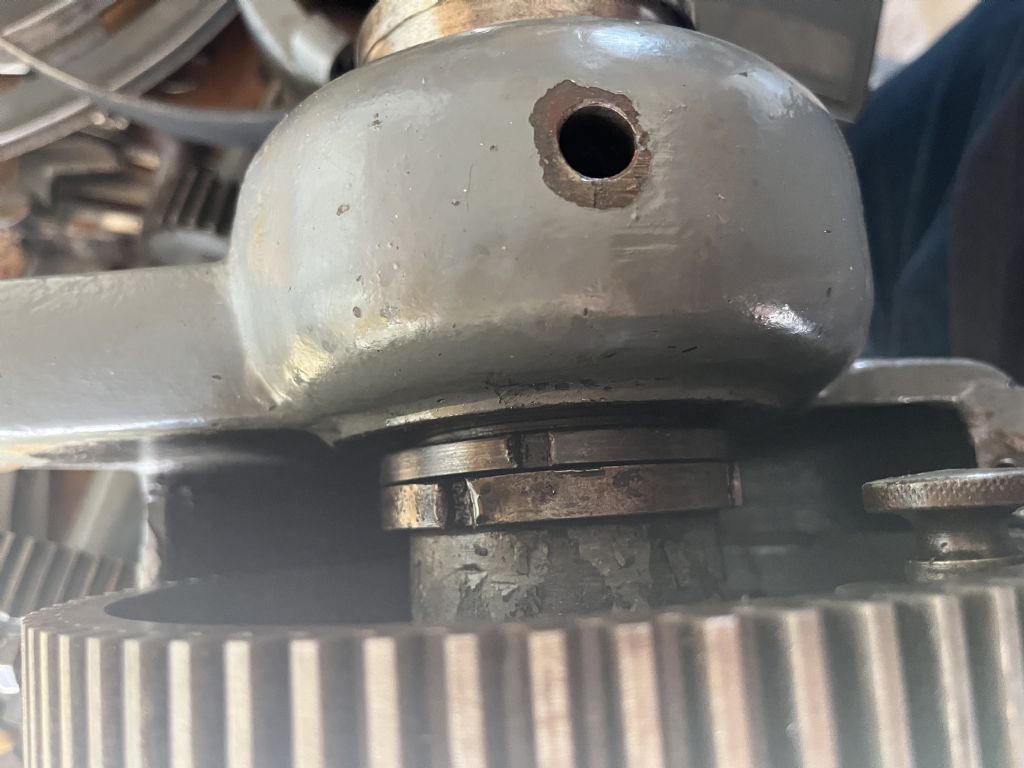

                        ..Are there slotted ring-nuts on either side of each of the bearings?
                        ..bit hard to see in the photo's..
                        Howard, see link in Dave Halford's post of the 17th..

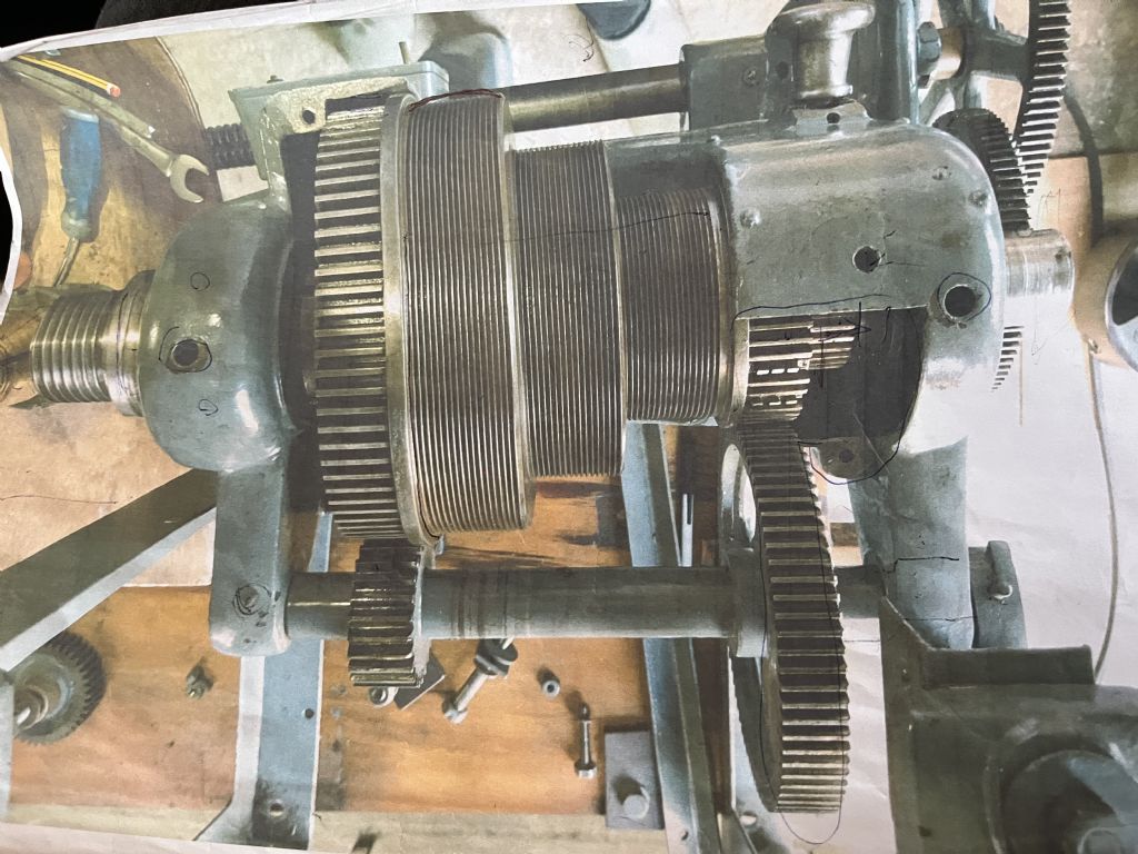

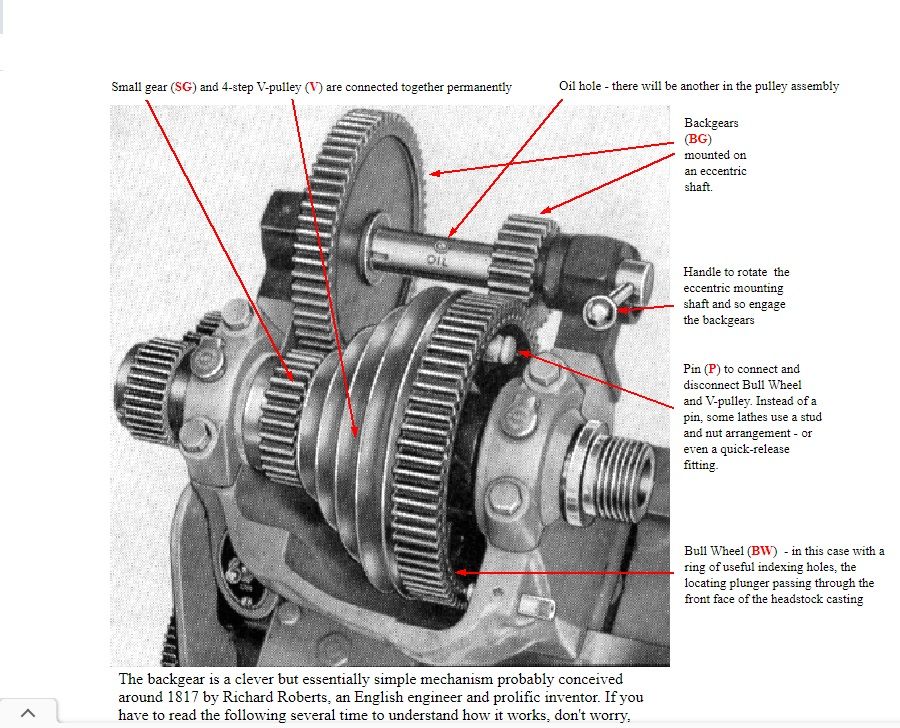

                          yes it has slotted ring nuts one which screws in to a bronze bearing sleeve furthest from the chuck and two closer to the chuck.I will get some better pictures tomorrow. I'm unable to remove the gear that is for the change wheels it is too close to the back gear to put anything in to prise it and I cant fit a removal tool in I think I have to remove that gear and the rest should come off of the spindle.
                          It's a similar set up to the picture below

                            " I'm unable to remove the gear that is for the change wheels it is too close to the back gear to put anything in to prise it and I cant fit a removal tool in I think I have to remove that gear and the rest should come off of the spindle. "
                            I shouldn't prise or pull anything too hard until you are sure all the fixings are out, there could be more than one – how is/was it (apparently) secured to the shaft.?
                            Some more photo's would be very useful.

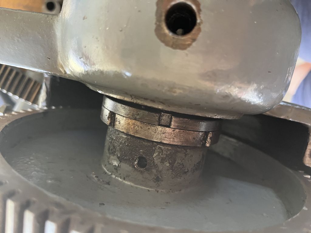

                              The gear on the end of your spindle may possibly be like some Myfords and have a tiny grub screw fitted into a threaded hole drilled and tapped in the very end of the spindle, lengthways, half in the gear and half in the spindle. You have to remove the screw from the very end of the spindle before the gear can be removed. Post a few pics from different angles would be helpful if that does not work.
                              Someone has done a nice job on grooving the pulleys for Poly V belts. Are you sure the belt needs replacing already? Seems a shame to disturb it all unless absolutely necessary.
                                        Edited By Hopper on 24/05/2023 09:10:17
                                        I think that grub screw is known as a French key.
                                        The poly vee grooves seem very narrow.

                                            Judging by the pictures of your lathe the photo above is not at all similar as regards the headstock and spindle construction.
                                            The link that Dave Halford gave (a few posts back) is much more relevant. It may not be identical as it does not have the back gear but if its the same make of lathe then the manufacturer will probably have used the same general design and there are enough clues in the drawing that will enable you to proceed.
                                            It looks a really nice lathe and I suggest taking care and not rushing disassembly, hopefully there is a flat or dimple where the grubscrew sits so that any burr does not damage the front bearing (spindle must come out from the front)

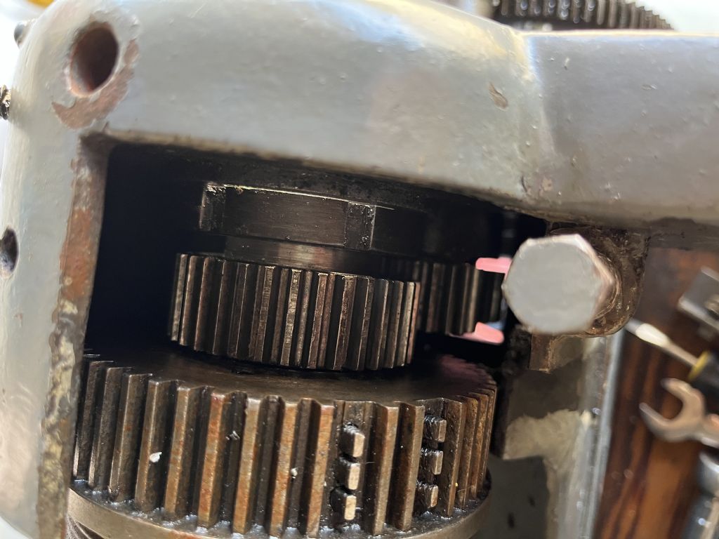

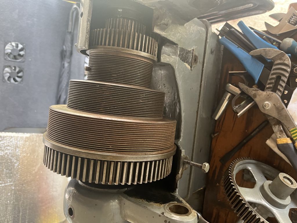

                                              Does anyone know what the slots on the gear are for? Also any ideas of a way to remove the smaller gear off the spindle there is only a 4mm gap between the large gear and the small gear
                                              #648738
                                              Clive Brown 1
                                                @clivebrown1
                                                Those "slots" are pegs put in to repair broken teeth. A common practice with older, hobby lathes.
                                                #648739
                                                DiogenesII
                                                  @diogenesii
                                                  Is that a slotted nut outboard of the small gear?
                                                  #650434

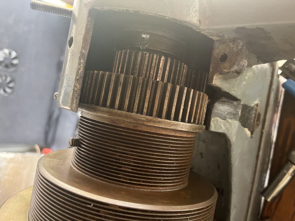

                                                  Aston Manning
                                                    @astonmanning46959
                                                    Thanks all
                                                    what would be the best way to get the bull wheel off? It looks like it’s threaded. I don’t want to damage the teeth or the spindle
