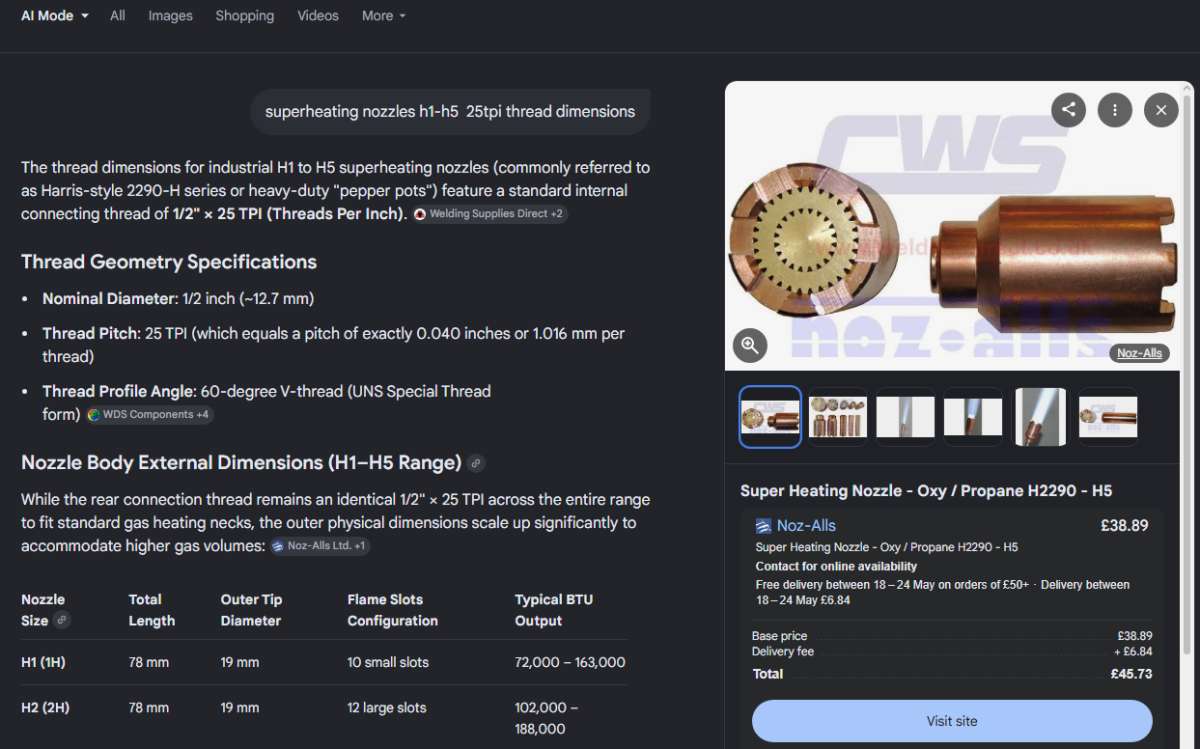

      This was how I confirmed the thread size yesterday; screenshot from a Google search
      image_2026-05-17_135040135
      Unfortunately it didn’t help source a suitable tap & die.

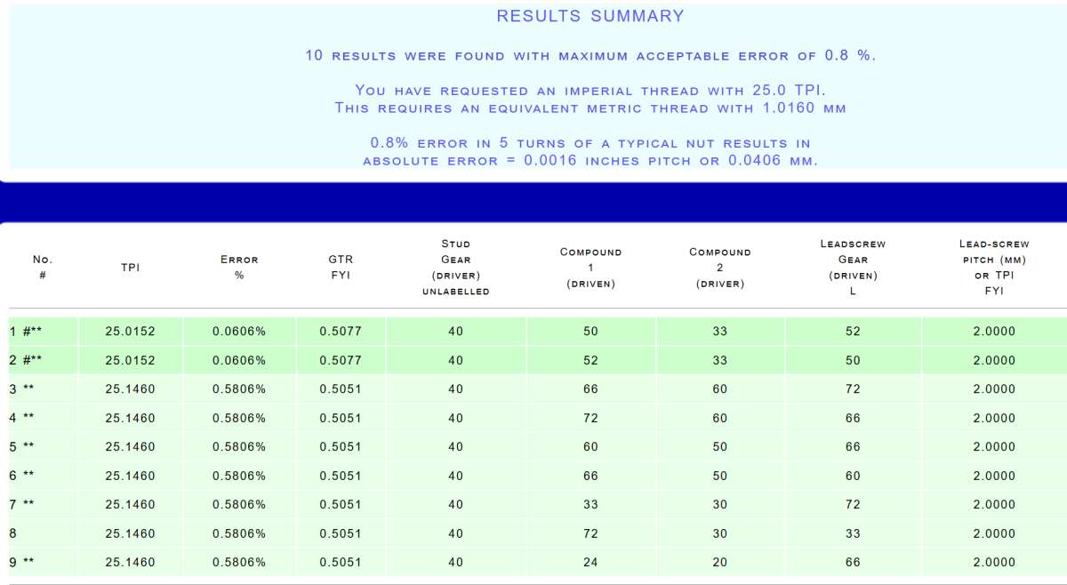

              I can’t screwcut 25TPI on my lathe either, but I could if I sourced a 50T changewheel. Is that an option for you?
              Edited again, I have an 8TPI leadscrew so just 16T on the spindle and 50T on the screw will do it, no need for compound train.

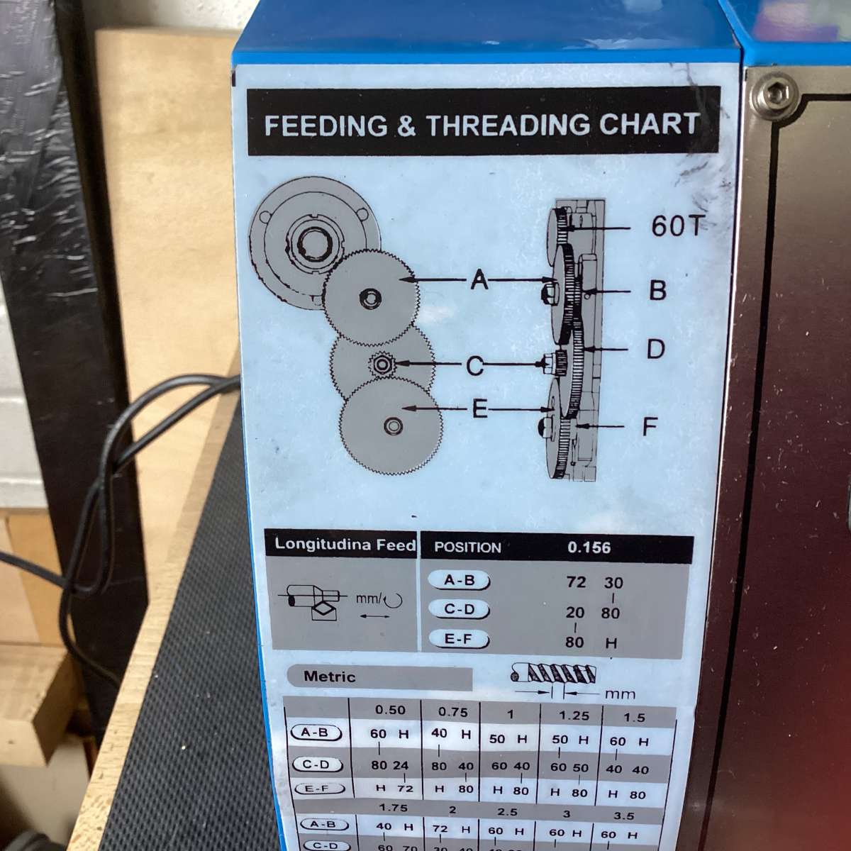

                Hi Adrian, I believe my Amadeal 210 lathe has a 2mm pitch lead screw. I’m not sure what gear combination I’d need for 25 tpi.
                  This program takes a bit of getting used to, but seems to work OK
                  You will need a list of what change gears you have, as well as the leadscrew pitch
                  https://ridethegeartrain.com/index.php
                  See Also
                  https://www.lathes.co.uk/transposing-changewheels/
                  Double check this;
                  image_2026-05-18_145434125
                  Bill

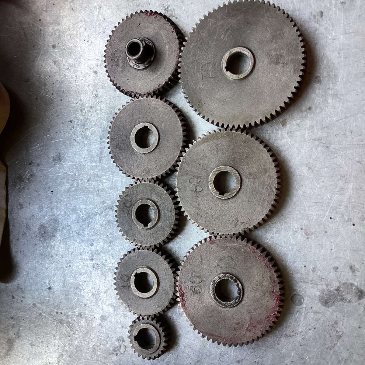

                    The gears I have are shown in the photos, i.e. the factory combination for longitudinal feed shown on the gear casing sticker, and the gears laid out on my bench.
                    IMG_1991IMG_1995

                      If I read the numbers on your gears correctly as 20, 30,40, 40, 50, 50, 60, 60, 70, 72, 80, 80 then 25.09tpi is the best you can get with them.
                      25 train

                          Given that the stud gear on my lathe is 60t what gears would i need to supplement my current choices with to get the sort of accuracy shown in the top two results in Bill’s table?

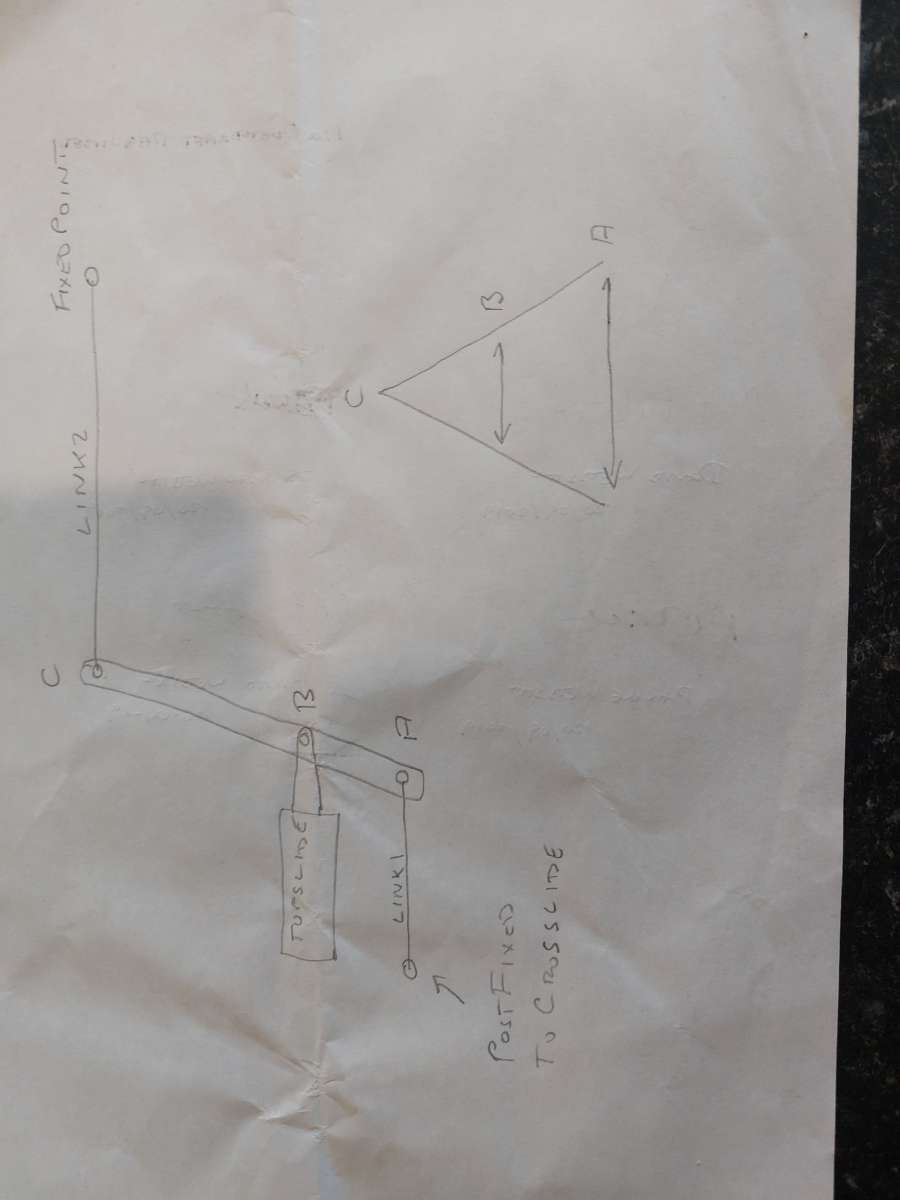

                              If you’re absolutely desperate, you could try this
                              Make a lever with arms in ratio 0.4 one end, 25 the other. Take the screw out of the topside and fit a clevis with a pin through the middle lever hole (long side of lever to back of lathe). Fix a post to the cross slide with a link to the short end of the lever. Have another from the other end of the lever to some fixed point. Set the lathe to cut 1mm pitch, 25.4 tpi. As the saddle moves to the left, the lever will pull the topside back relative to the saddle so that the tool moves at 25tpi.
                              I said you’d need to be desperate!
                              #848859
                              duncan webster 1
                                @duncanwebster1
                                I think I’ve got the pins at the short end the wrong way round. Other lever ratios might work better with a different pitch set, say 1.5 mm.

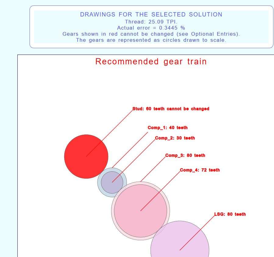

                                  As for an exact train try this (can someone check my maths.
                                  25tpi = 1.106mm pitch
                                  You have a 2mm leadscrew so we need that to rotate just over half a turn per turn of the chuck
                                  2mm / 1.106 = 0.508
                                  From previous playing about with numbers it just so happens that 32/63 = 0.5079365
                                  Given you have a fixed 60T driver and a large gap between that and the leadscrew a 60T will be needed to  cancel out the 60T on the spindle and an idler to fill any gap
                                  So the train would be
                                  60T  Driver on the spindle
                                  ?T Idler on the first stud (whatever fills the gap)
                                  60T Driven on the 2nd stud
                                  32T  Driver on the 2nd stud
                                  63T Driven on the leadscrew
                                  This gives
                                  60 driving 60 = 1
                                  32 driving 63 = 0.508
                                  Multiply those two together 1 x 0.5079365
                                  Multiply leadscrew pitch by 0.5079365 = 1.015873 which is not far off the 1.016 that we wanted

                                    Messing around with https://bilar.co.uk/cgi-bin/change-gear-calculator.pl says a 32 and a 63 in the geartrain would give you 25.003
                                    3D printed would likely work unless you envisage production quantities.
                                    Edit, overlapped with Jason but fortunately we come to similar conclusions.
                                    Edit again another solution only needs the 63T gear whcich as a common metric to imperical conversion may be readily available.
                                    20 – 50- 80 -63 = 25.003 or 0.012% error

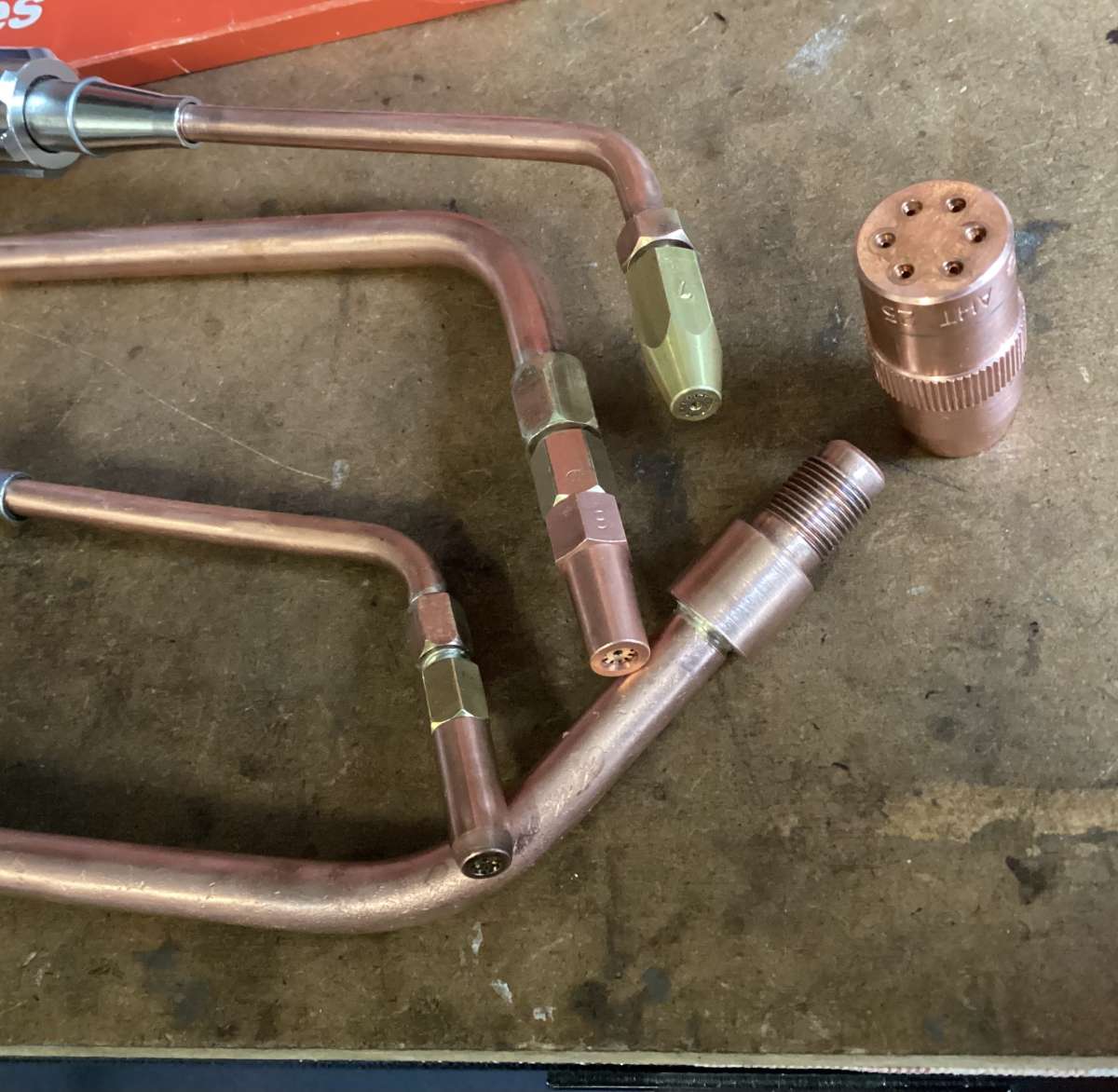

                                        In case anyone’s interested, I’ve been making a few multi-jet propane nozzle/necktube combinations lately. Since the Welders Warehouse closed a year or so ago, there is no UK supplier, afaik, currently selling multi-jet oxy-propane torch packages or even just a necktube/multi-jet propane brazing nozzle combination*.
                                        My pic shows three different types of multi-jet propane brazing nozzle and an AHT-25 acetylene pepperpot heating nozzle that I “propanized” by counterboring the 0.9mm exit holes. The thread on AHT heating nozzles is 7/16”-27 UNS, so it was pretty easy to repurpose a secondhand swaged welding tip by silver-soldering on a copper heatsink that doubled up as a male thread for the nozzle. 7/16”-27 taps and dies are freely available online for not much money.
                                        *Nozalls do sell Kemper OxiKit 555 Walkover nozzles, which might just qualify as being multi-jet.

                                        duncan webster 1
                                          @duncanwebster1
                                          Will do a sketch tomorrow
                                          #849059
                                          duncan webster 1
                                            @duncanwebster1
                                            sorry it’s a bit faint. The end C of the lever is connected by a link to some fixed point. The point B is connected to the topslide via a clevis fixed in place of the topslide screw support. The end A is connected via a link to a post fixed to the cross slide.
                                            Now suppose the lathe is set to turn 1.5 mm pitch. In one rev the saddle moves 1.5 mm (obviously), but point C doesn’t move, so the topslide moves by 1.5*BC/AC, and we want this to be 1/25″ which is 1.016 mm. Rearrange and we get BC/AC = !.016/1.5, so if AC is 150mm (to pick a convenient sounding figure) , BC is 101.6 mm.
                                            As the saddle moves, the point A will move in and out  very slightly, which will make the link connecting A to the cross slide move from being not parallel to the bed. This will cause a very small error, which could be calculated if we knew how long the thread was, but it will be very small especially if you arrange the start finish points of the thread to have the ABC lever slanted each side  as in the second sketch. A similar error exists with point C but as the link that end can be much longer the error is even smaller.
                                            Apart from an intellectual exercise I can’t see anyone actually doing this! On my lathe getting a suitable post in front of the topslide on the cross slide would not be easy.

                                            Bill Phinn
                                              @billphinn90025
                                              Thanks a lot for the explanation, Duncan.
                                              Hopefully, the small error required would be the same for every pass, otherwise the thread might look a bit ragged by the end of the job.
                                              #849181
                                              duncan webster 1
                                                @duncanwebster1
                                                Yes it would repeat the same every pass, and as I said it would be very small. All depends on lever/link lengths compared to length of thread. The longer the better for levers/links.
