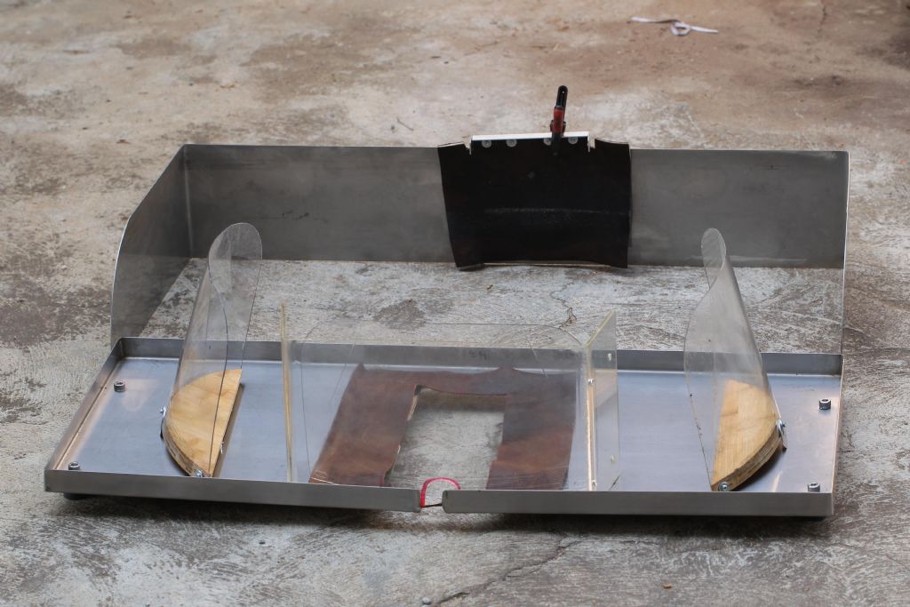

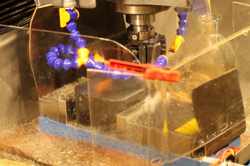

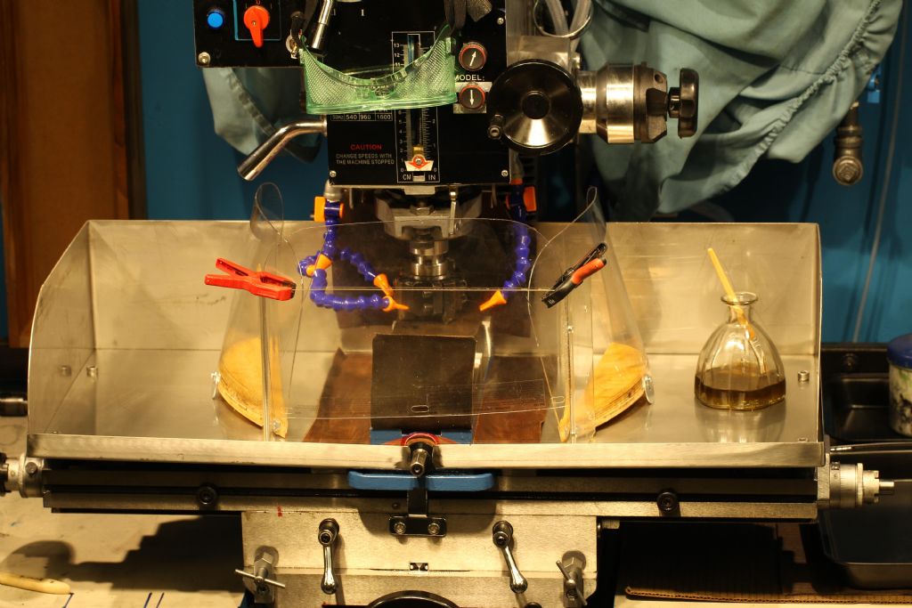

      Ok so I had a stainless chip tray made for the mill table when the vice is used.
      I have tested it by face milling a block of steel 5mm off one side and 2mm opposite side at 900+ RPM-Spindle. This effort contained all the chips. I used cutting fluid.
      I am sure it will contain the coolant later on as well, which will leak down near vice to the bed then with a pipe bak to coolant tank.
      I think I am very happy with this, and I can see well what is going on.
      PartsNothing bolts down, every part just slides in or sit on another, easy & fast to remove.
      1-Stainless Chip tray with 4x plastic feet rest on table.
      -It moves with the table.
      2-Stainless back plate resting on this tray. The size of the backplate can be changed for when quill & head is higher positions. This size will cover most work around the vice.
      3-2x Facermask shields used left & right of the quill to limit chips in tray area.
      -These move with the table, can be easily just positioned as required.
      4-The original perspex cover that came with the mill was used and slip in behind the vice on the tray.
      -This moves with the table.
      5-A leather piece was cut to fit around the vice to keep chips away from vice/table gaps.
      -This moves with table/vice.
      6-A leather piece that slip in behind the quill/spindle to catch chips near cutting tool fitted.
      -This moved/stay with the quill position.

        Easy install removal to catch chips & coolant vice used
        #587247
        MikeK
          @mikek40713
          Looks good, Chris. This is something I still have to do for my mini-mill.
