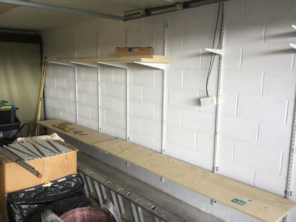

            I find that the shelving that uses heavy duty brackets that slot into vertical steel rails with dual rows of slots most useful – you can always easily adjust the heights and gaps between shelves as your requirements and tool inventory changes.
            For the shelves themselves, I simply go to B&Q and get them to machine cut strips on their vertical circular saw 'table' from 18mm heavy duty plywood to my specifications, which they do for no charge. (The 8 x 4 sheets are conveniently placed next to the sawing machine).
            This system keeps the floor underneath the shelving clear of support legs, so can be used to store ladders and other large items.

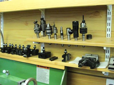

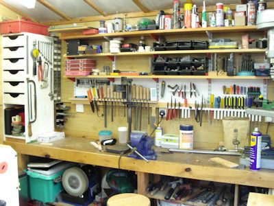

                                    Another vote for spur shelving, very adaptable with a bit of tweaking you can get the bracket to hold shelves at different angles. Cheap versions available from the big DIY stores.
                                    This lot is all held up by spur shelving and I wouldn't be surprised if the uprights were adding some strength to the somewhat flimsy workshop walls.
                                    This is an example of angling shelves by cutting brackets to hold lathe tooling at a jaunty angle.
                                    Most of the shelving is made from 'Timberboard' from Wickes comes in variety of widths and lengths and being an engineered board (laminated) is fairly stable, takes varnish nicely.
                                    Edited By Journeyman on 18/05/2023 17:12:30

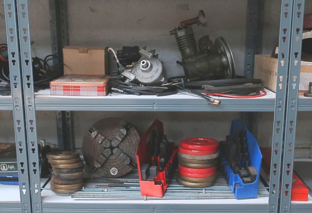

                                          I 'bulk-bought' an apparently identical set of the shelving linked to from Screwfix.
                                          The shelves are thin, but supported across the middle so the MDF actually supports two 450mm squares.
                                          The units are almost purposely designed to induce buyer remorse, thin, 'wangy', and lacking any kind of stiffness until fully assembled and with the shelves in. If you can screw em to a wall so much the better..
                                          They look & feel pretty dreadful, but on the other hand you get a lot of shelving for relatively little money – 175kg per shelf is pretty adequate (even if somewhat hard to believe)..
                                          #645789
                                          DiogenesII
                                            @diogenesii
                                            ..not saying it'll last forever, but.. ..the chuck is a 10" P-B on an 'L' fitting, the clamp sets are '14mm slot'-size..
                                            PS this isn't the bottom shelf..
                                            Edited By DiogenesII on 19/05/2023 07:44:28

                                              175 kg per shelf stops being hard to believe the moment you consider the (non) engineering of the common smartly faced chipboard bookshelf sets from Ikea et al. Almost a yard of books supported on 4 wimpy little pins pushed into the uprights. Books by the yard are heavy, really heavy. I'd be scared to try and calculate the loadings involved. Far as I can see the support engagement is about 6 mm long by 4 mm wide per pin, assuming a little bit of load flow from the flat board around the pin. Doing the maths seems to be tempting fate that if I did figure out thing the shelves would realise they actually aren't strong enough and collapse. Something over 9 m length by 2 m high of fully loaded bookshelf its a lot to re-home!
                                              Kit built furniture always seems vastly under-engineered for the job and I hate the way everything flops about until that last part slots in making it a stiff structure. But the Argos bed in teh spare room did get some extra brackets.
                                              I guess the old adage that, for smaller projects up to "needs a few people" size the old adage that if its "stiff enough its strong enough". Peering under a modern car is a (worrying) education into how much load can be passed through how little material if you are clever about it.
