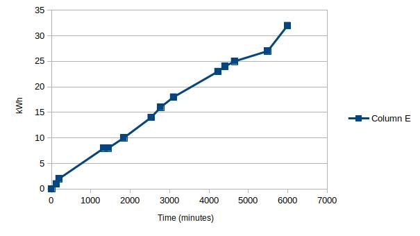

        I've not worried too much about my energy costs, high as they are, until now . I live in an old and poorly insulated house and thought that's just how it goes. But I'm sure I'm not alone in having had an email advising of a substantial hike in prices – around 30% in my case. That made me think.
        My energy provider estimates my annual electricity consumption at 7,857 kWh. That translates to about 900W continuously, which I thought was reasonable.
        As I've been unable to get into the workshop recently for health reasons, I thought I'd make a graph of background household consumption:
        The slope until the sudden upturn at the end amounts to about 325W. The upturn was coincident with me going down to the workshop and leaving the lights on.
        I was really surprised by this – I'd thought that my workshop was a tick on the back of overall household electricity costs, but it seems that it is in fact dominant. It seems odd to me that a continuous 325W is enough to run a house with an electric oven, microwave oven, electric kettle, washing machine, dishwasher, two computers, two TV's and lighting. That's three and a bit of the old incandescent lightbulbs! But that's how it seems to be. I'd be interested to know how others fare.
        At the moment my workshop is lit by four T8 58W fluorescent tubes:
        which between them give around 20,000 lumens I think. I had a look at LED tubes, but it seems that to get the same level of illumination wouldn't actually save me much. Maybe I could do better by more strategic placement of lighting. Any advice would be welcome.
        Robin
        PS – please don't nag about the hanging sockets, I know and I'm working on it.

          A couple of suggestions.
          A typical fluoro tube is is about 45 Watts while a similar LED tube consumes 18 watts. Don't run them all at the same time.
          The dark roof will soak up the light. Paint it white or cover it with reflective material and you will not need as many lights.
          Paul.

              +1 for the OP painting the ceiling and walls white. A good coat of emulsion would make a big improvement to overall light levels
              Then install LEDs.

                +1 for painting with white emulsion…
                Looking at the photo I can see that the basic workshop is well lit with the ful length tubes,…however, personally I know I could not manage without specific lighting for the machines and important work areas such as the (tiny) bench areas where I assemble etc. There are some really excellent LED fittings now that have been a revelation for me, and most are not true work or machine lights so much as good domestic angle and spot lights. You might experiment with not using the tubes but using more specific LED lighting and see how that works when actually making stuff….could be much mre cost effective to keep the light exactly where you need it …if that makes sense!

                  + 1 for painting with emulsion, your fluorescents seem to be arranged centrally down the centre of the workshop which will mean that at times you have the light unit behind you, I would take the plunge and arrange the light units to the side of the workshop, staggered with half on each side, I would take the plunge and go for LED, my workshop is so much brighter since I changed to LED. I supplement my lighting by using a rechargeable LED head torch, it’s surprising how much easier it is to see fine details at the tool when it’s illuminated adequately. Dave W

                                    Thanks for an (ahem!) illuminating discussion. Unfortunately painting the ceiling white isn't an option if I want to remain married. My wife has fantasies about turning the cellars into living space when my love affair with the lathe &c has run its course. She likes the raw brickwork.
                                    Reading replies I think my best option is to change to LED's and make the light more focused on important areas. I've certainly found that LED bulbs seem to be subjectively 'brighter' than fluorescents with the same nominal lumen output.
                                    Further measurements suggest that our background usage (measured overnight with everything turned off except the fridge and freezer, TV's/computers sleeping and a single light) is 225W. I guess that's mainly the fridge and freezer, which is pretty good I reckon.
                                    SoD makes a good point about the small things adding up with the 'high ticket' / short duration appliances being less important. I'm trying to convince my wife that it's still OK to use the electric kettle and the dishwasher! And convince myself that it's still OK to use the 2Kw lathe – actual turning time is a small fraction of workshop pottering time. With those lights on.
                                    Workshop heating is the next thing to attack. I've been using 3kW electric fan heater, blissfully ignorant that I was using in an hour what the rest of the house uses in a day until I made these measurements.
