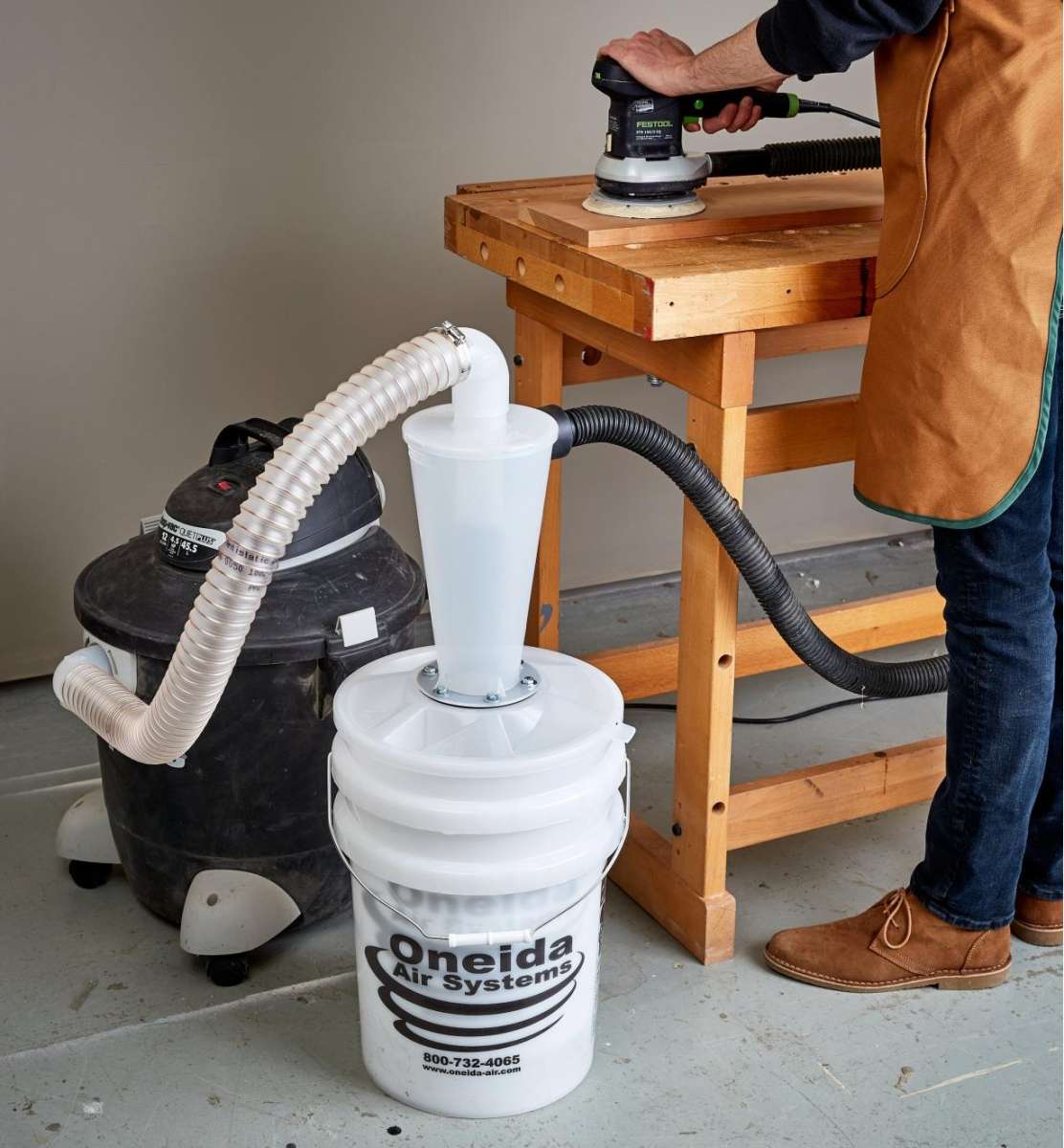

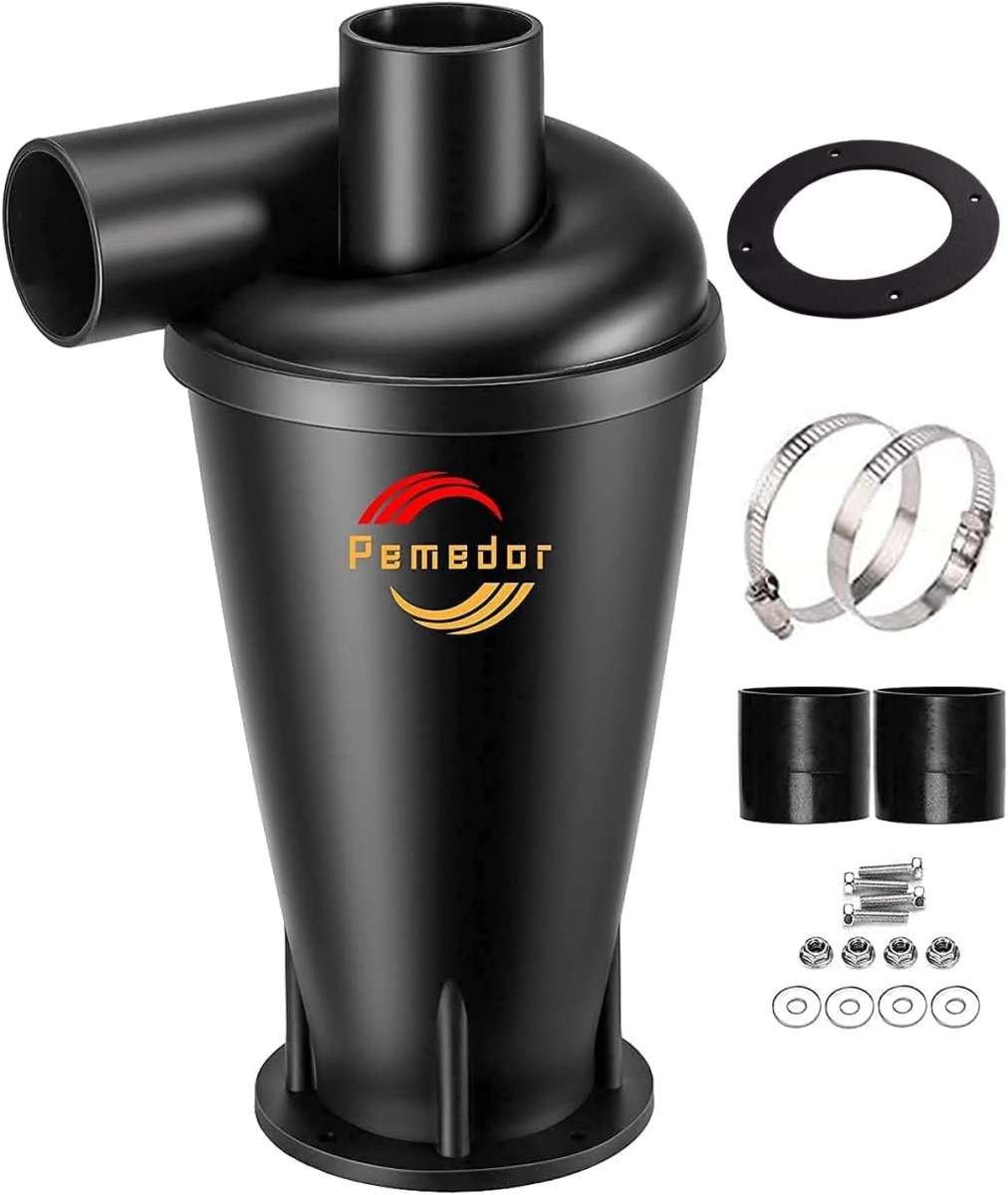

                                              I use a 30L food barrel with a cyclone attachment fitted to the top. That is powered by a standard shop vac that I think I got from Screwfix. The Cyclone attachment and barrel is a game changer as nothing really ever gets to the vac so you never have bags to change. It’s something I setup when doing more wood stuff but it works great for swarf. I have a 5M hose on it and so can reach anywhere in my small workshop with it.

                                                I use almost exactly this, powered by an old Sealey wet n dry shop vac. I have 2 barrels, 1 for swarf and 1 for everything else. Absolutely brilliant – if it will fit up the hose it will suck it up no bother – wet or dry, although with a spiral wound hose the longer swarf can be an issue as has been said. I have fitted a relief valve to the barrel lid to stop it collapsing though and that is great (can get them on amazon).  I’ll get a smooth bore when I get a ’roundtuit’.
                                                Highly recommended if you have the room.
