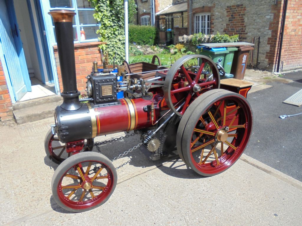

                                            I totally agree with the view " build as large as you can", but don't be under any illusion, large models can cost a lot of money to build, castings, boiler, boiler fittings, rubber tyres , also tools etc that you havn't already got,
                                            Also large models need large machine tools to build them,
                                            I built the 6" Burrell in the picture, It took me 7 years and was a hell of a lot of work, but all worth it when finished,
                                            I cut the straight gears, the largest was 21", the flywheel was 25" , the final drive gear and winch drum probably weighed around 300 Lb before any machining was done,
                                            The castings were from EKP Supplies in Devon, They do a 6" an 8" and I think some 3" scales as well, have a look at their website.
                                            Any help I can give you, please send me a private message, I am in Bucks,
                                            Good luck with whatever you decide to build,
                                            Richard.
