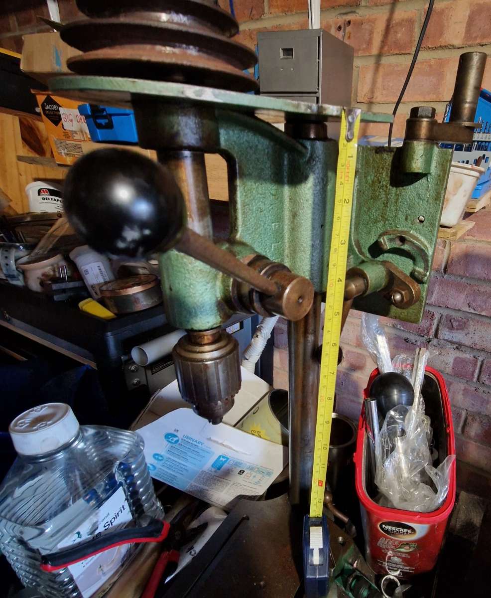

      I bought a small motorless bench drill for small hole drilling.  Its an old English solid machine about 14ins tall and 7 front to motor mount
      Having trouble finding a suitable motor. Tried 12v types but no where near powerful enough. I have a spare 1450 rpm motor but way too big and heavy all else seem to be 10 000 rpm types which would require an interesting array of pulleys! Dont really want to get involved with speed control ,expensive and I dont’do’ electrics either. Just a motor to bolt onto back.!thanks Jonathon.

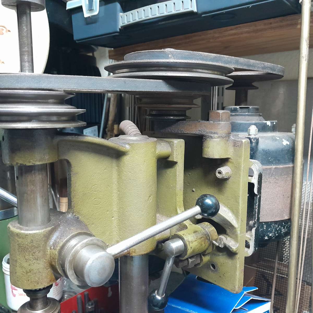

                              Gosh – double take when I saw the pictures. I’ve got the same drill only in brown paint. That sort of vertical handle or rod sticking up at the back by the motor plate is a countershaft to hold an intermediate pulley. My motor is about the size of a sunneydew mellon. I think you should find one cheap if you are patient because people think they are too small for a lathe.
                              I have a 3mm drill permanently in mine to start off holes then go to the larger generic Excel/Warco bench drill.

                              noel shelley
                                @noelshelley55608
                                Having seen the picture, that is not a small drilling machine and a 370W 4 pole motor would be fine. Just make it fit ! Noel.

                                  Given that there is a lot already missing … I would be tempted to remove all the redundant parts and fit a good modern variable speed motor to it.

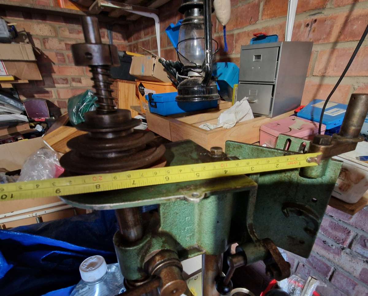

                                    Only the intermediate pulley is missing, and belts.

                                      I’m not arguing, Bazyle, but I would personally consider the absence of the motor and the intermediate pulley system to be “a lot”… and I think it would be better-value to strip any excess and simplify the drive.

                                        The machine itself is a Cowell’s of Watford affair. They supplied partly-machined bits and pieces and you made the rest. I’ve got the 1/2″ version; I built it in 1975 or so. I think yours is the 3/8″ type but many parts – and the speed reduction arrangement – is similar to mine. I’ve got a Brook Crompton Parkinson 1425RPM 1/3 horse (250W) motor on mine.
                                        #765345

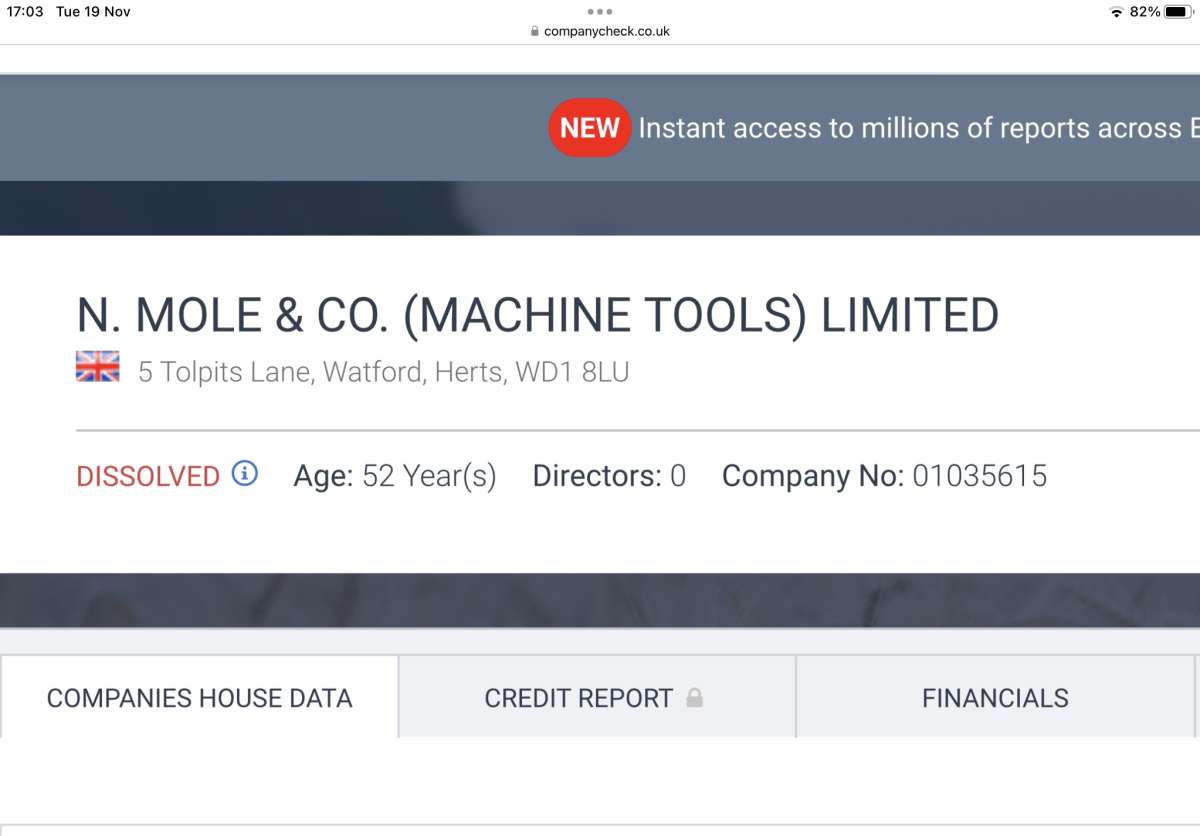

                                                We have been here before. I didn’t recognise the similarity with mine when this came up. Note in that thread  the ever researchfull MG mentions a similar unit from Amolco. Guess what, A Mole traded from barely 100 yds away.
                                                and many pictures here http://www.myford-lathes.com/grinding9.html
                                                #765369
                                                  Norman Mole was a fine chap …  and we always made a point of visiting the shop when passing through Watford.
