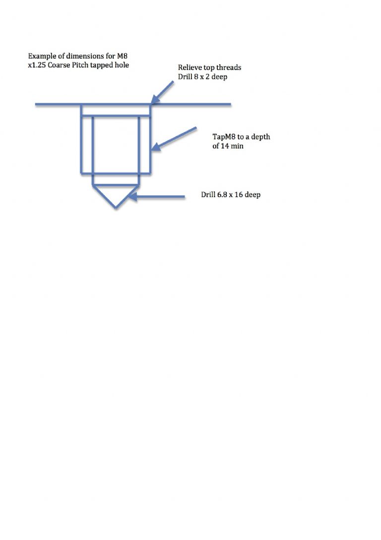

                4 x m6 is best …though if you can fit 3x M8 you will get around 50 % increase in the clamping force
                As a rule of thumb the depth of the tapped hole should be at least 1.5 x thread diameter or you will pull out the threads as you tightened the HT bolts.
                You could also use some loctite on the joint …… belt and braces

                                        Thanks for your advice. The material and sizes of the two parts, and the positional relationship between then is already defined, The only thing I can vary is how they are bolted together and the main requirement is to resist torsional movement of the 20mm diameter 'axle'.
                                        The bolts (12.9) have to go into tapped holes in the round bar, I like to have about 2xdia thread length which is easy in 20mm thick material, in fact I could put the bolts past the width of the flat if I spotface where I have to drill.
                                        The width of the flats is about 18mm so the furthest away from the centreline would put M6 bolts 11mm apart. I could use 6 M5 bolts and get those even further apart. Its only a one-off job so cost is not an issue, 4 or 6 takes longer to do than just 2 but time is not too critical.
                                        I wonder whether two small fixings in conjunction with a 'large as possible' tight fitting dowel might be a better approach?
