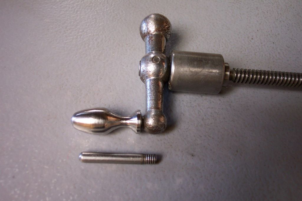

                      Brian Wood
                        @brianwood45127
                        New handle for Holbrook tailstockLike Carl, I have had excellent results with 304. This is just one example
                        Brian

                                  This example was a case of hewing out the metal, in this case with a small carbide button tool, and then smoothing the shape with various files before using a worn Scotchbrite pad to finish the job. It was a satisfying piece of freehand turning as well..
                                  I've had equally good results making taper turned furniture knobs in 304 which were then finished with Scotchbrite to leave a satin finish. Good support to the work is I think very important so that flexing is kept to a minimum. Work speed is modest at around 300-400 rpm

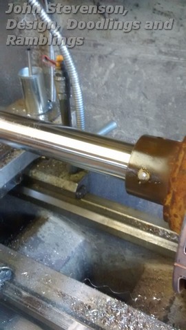

                                            Did a long pump shaft yesterday in stainless, 50mm in diameter and a couple of foot long.
                                            It had worn quite badly where the seal track ran and so needed building up and turning back to size with a good finish for the seal.
                                            Shaft after welding with 316 wire.
                                            Completed shaft.
                                            This was turned at 1200 rpm feed of 0.07mm per rev and no coolant.
                                            I did take a video of it but You Tube will not upload it although it plays on my computer.
