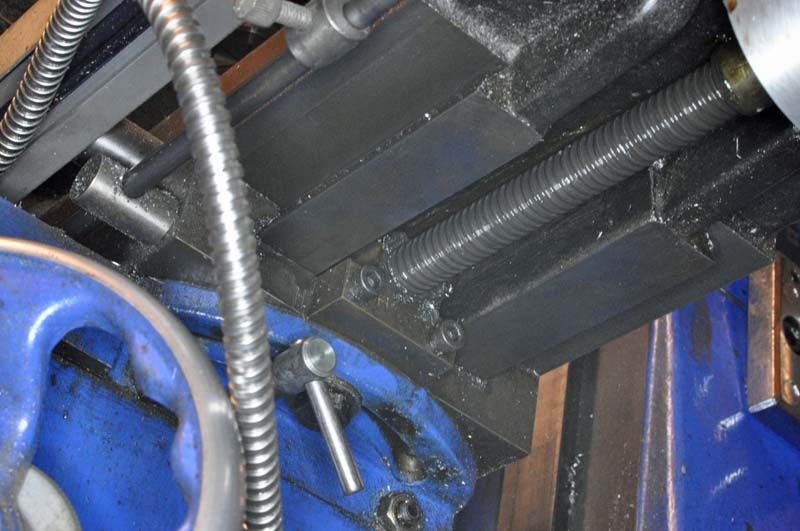

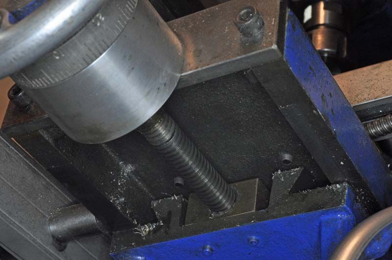

                                On my MkII both X and Y are half inch. Hard to tell, I can have a better look tomorrow, but I think they are ACME. You would at least be able to buy a tap if you made them ACME. I'll put a couple more photos in the album tomorrow as well.

                                      #208975
                                      Roderick Jenkins
                                        @roderickjenkins93242
                                        Couple of pics of the leadscrews:
                                        Y
                                        X
                                        Rod
