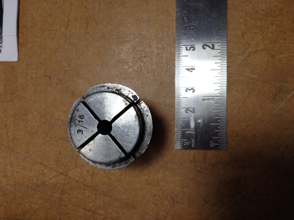

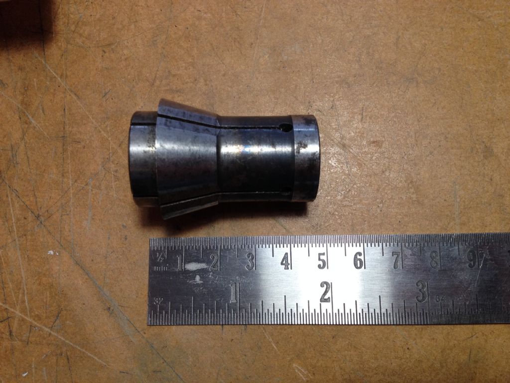

        Hi,
        A friend has a number of collets but doesn't know what type they are – or what they'll fit. Can anyone shine any light please – many thanks.
        Brian
        (I hope the photos will appear – I struggled to attach any piccies)

        #596386
        Anonymous
          They're dead length collets. Looking at the size I'd hazard a guess they're for a 3/4" Britan repetition lathe. I don't think I have any for direct comparison as I sold the ones I had since I have a 1-1/4" Britan.

            They look remarkably like Britan collets, Andrew beat me to it !

              Anonymous
                Posted by B Tulley on 30/04/2022 15:11:15:
                …does this mean they are only really of use on a Britan…
                Most likely yes; superficially the collets look like the DIN6343 standard, but don't match any of the standard sizes. At least that is the case for my collets for the 1-1/4" Britan.

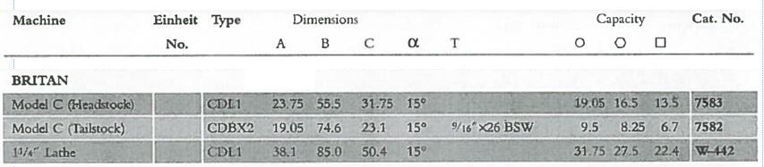

                          Is it one of these? A is the maximum diameter of the collet, B is the overall length, C is the diameter of the register and alpha is the angle of the taper from the centre line.
                          Martin C

                            Martin Connelly
                              @martinconnelly55370
                              This is just a snippet from a 32 page list. If you give the actual dimensions I may be able to find something that matches. Trying to judge from a photo is not too easy.

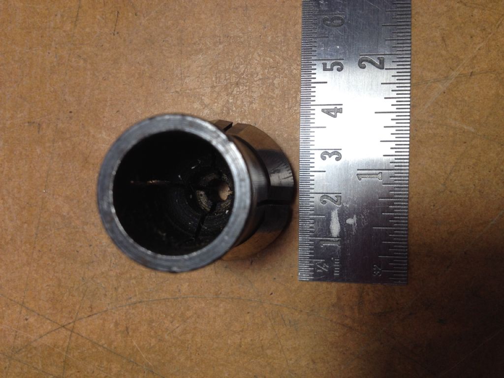

                              B Tulley
                                @btulley
                                Many thanks – the dimensions are:
                                A: 31.34mm (there are four flats on the largest diameter, at the 90 degree points; these measure 30.49mm)
                                B: 45.93mm
                                C: 22.97mm (I'm assuming the "register" is the shiny ring at the right of the photo above)
                                alpha: 15 degrees
                                Kind Regards,
                                Brian

                                Martin Connelly
                                  Oops, I got A and C the wrong way round. I've looked through the lists in two Crawford Collets catalogues and could not find a match for what you have. Apart from the overall length they are a close match to the Britan ones above and that is the nearest I could find.
