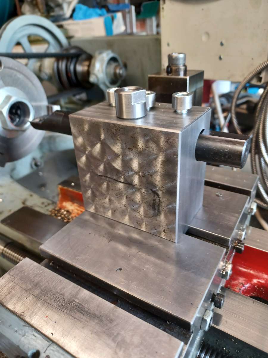

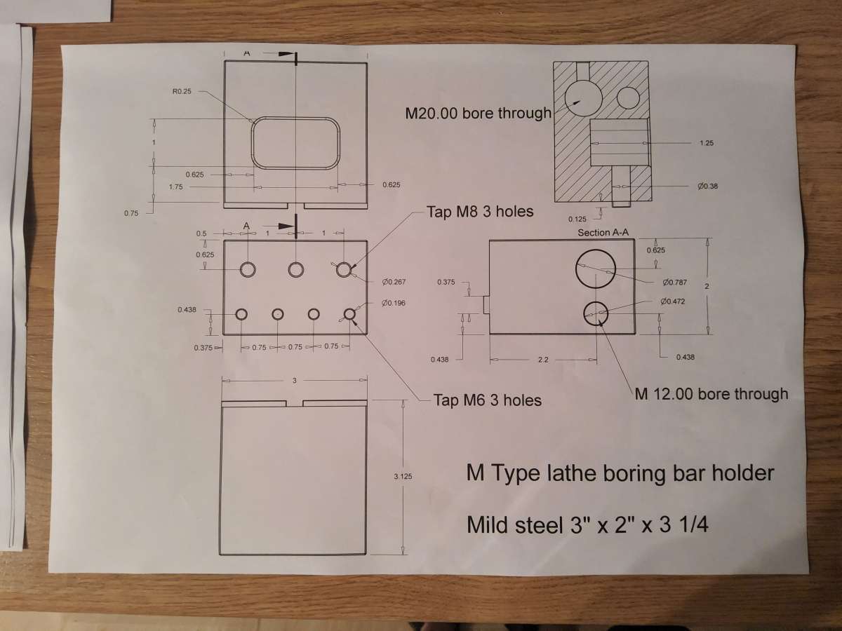

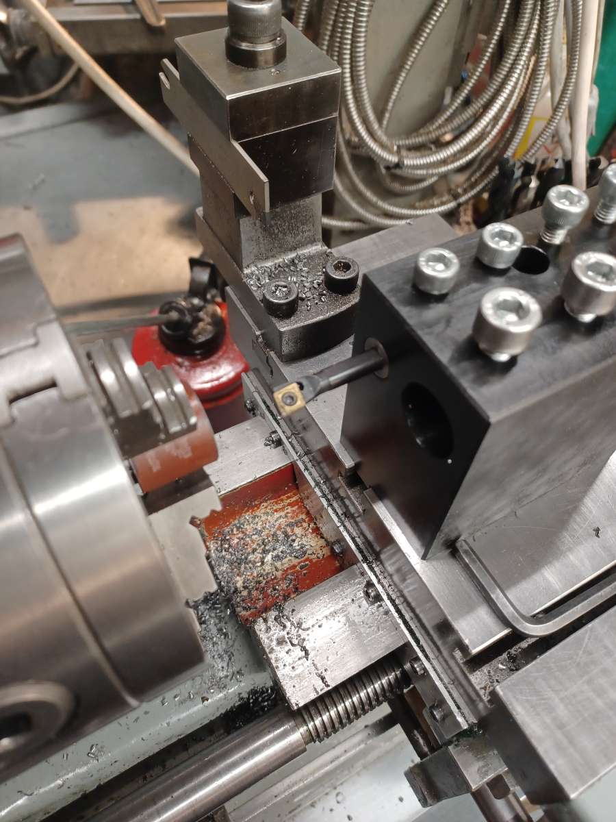

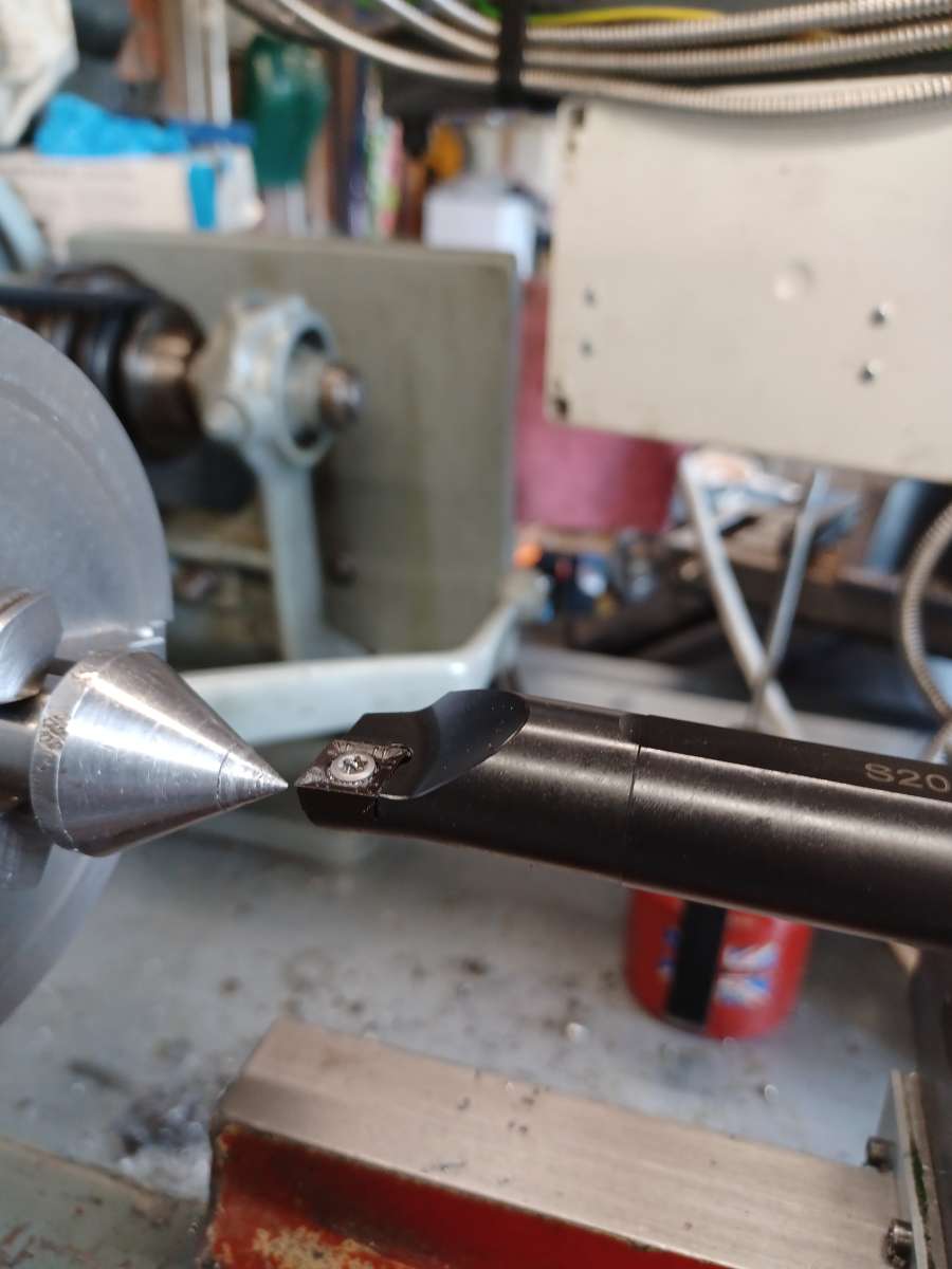

                I needed to cut a large thread size in some new main spindle replacement bronze bearings and as the thread inserts would only fit into a boring bar that was 20mm diameter I decided to make a new tool post to suit. I also found that the centreline of the boring bar was the centre cutting height of boring bars tip and so if I bored it with a boring bar or drills and ream in the chuck the tip height would be on perfect height and if I used a smaller boring bar in a concentric bush it would still be on centre height. I eventually just made a block which bolted down to the cross slide which was simple to swap and but in two holes of different diameters side by side with a line of clamping screw holes in each hole.
                20230811_160611
                I started with the single tool holding hole till I decided it could be made to take smaller boring bars as well.
                20241030_162002
                20230910_194548
                20230811_161359
                Just my thoughts of using larger size and more solid boring bars.
                David

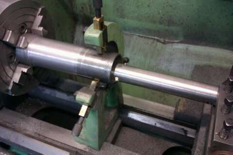

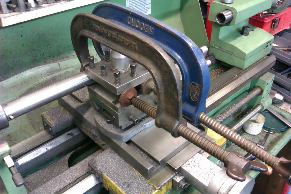

                  Not being a big fan of making tools I took a different option, the toolpost make a good Vee block to clamp the shank to. In this case a 25mm shank and the hole in the cylinder liner was just over 160mm deep.
