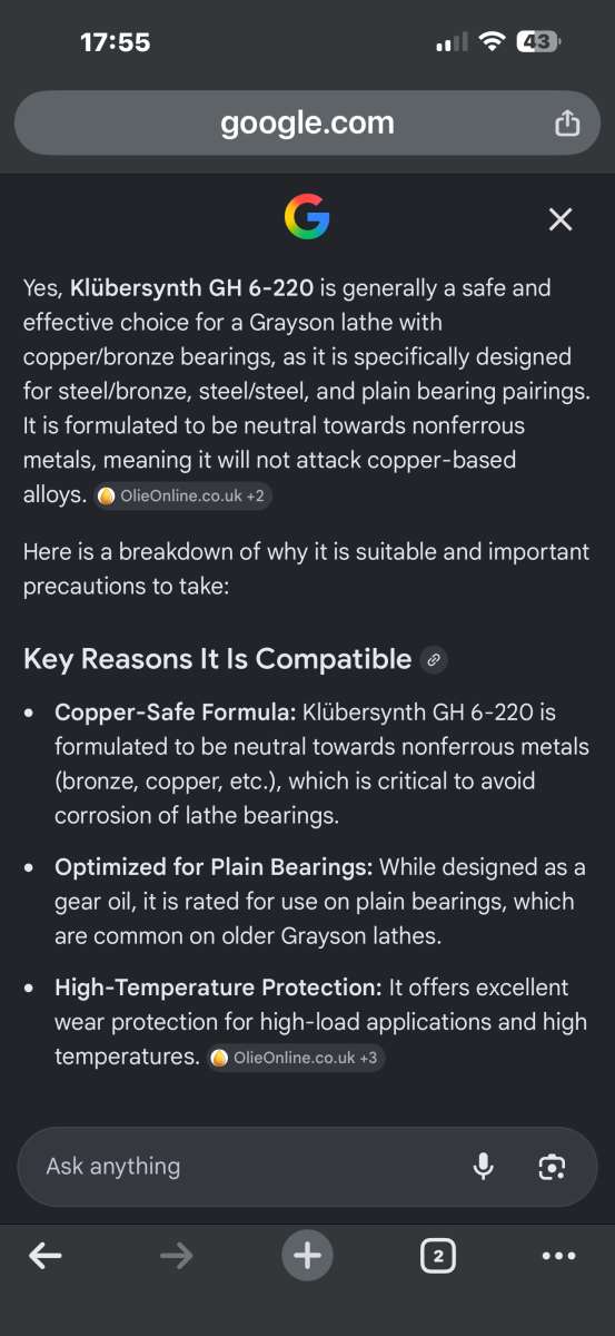

                  <p style=”text-align: left;”>Thank you Pete . Someone gave me some klubersynth gh 6-220 oil I’ve read up on it and it says it’s good for the bearings, as far as I know the bearings are bronze on my lathe . This is the details about the klubersynth oilIMG_0512</p>

                      The klubersynth gh 6-220 oil is NOT suitable for the headstock bearings of this lathe. It is far too viscous. It’s a ISO 220 oil. You need a thin oil, typically ISO 32. The classic oil was Nuto32 but any plain ISO 32 “hydraulic” oil will be OK. This is used in industrial machines, excavators etc. Can be hard to find “branded” oil in small quanties from dealers but lots of sellers on ebay etc.
                      It ia also used in hydraulic jacks so “jack oil” from a motor factor machine mart etc will do.
                      Noel mentions 68 grade oil. That is also too heavy for the headstock. It’s normally used on the gears and slideways.  The Kluber 200 would do for those too if you already have it.
                      Your lathe is very similat to Myfords so oils reccomended for thoase will be OK.

                                Thank you all for your comments . Yesterday I flushed out the old oil and after it was coming out clear I left it for a couple of hours and added the klubersynth gh 6-220 oil , I noticed more or less straight away how quietly it was running than it was before plus it doesn’t disappear from the oil wells as it was with a much thinner oil . I suppose time will tell if it was the right thing to do or not but I’ve had it running for around an hour this morning and it is still quiet and running smoothly plus the oil in the wells hasn’t disappeared like it was before and I’m not getting any spray off it as before with the thinner oil . So hopefully it is doing the job intended . Thanks again for all your advice and suggestions on this matter
                                #848610
                                alecs
                                  @alecs
                                  Yes it will flow slower, and possibly fill the gap in worn bearings.
                                  That ISO 220 Klubersynth gear oil is equivalent viscosity to SAE 90 gear oil or SAE 50 engine oil.
                                  The recommended ISO 32 hydraulic oil is equivalent viscosity to SAE 10 motor oil. Quite a difference from 50 weight.
                                  Keep an eye on it and make sure some oil is coming out of the bearings and the level in the oil caps drops some over a few hours. Especially in winter.

                                    Hi Alecs . There is oil coming out from the bearings and the level has dropped but not as it was with the other oil I was given with the lathe . As soon as I put the other oil in it was disappearing within a minute and was spraying out from the bushes but now it is a gradual process and although I can see the oil each side of the bearings it’s not spraying out as beforehand so it looks like it’s doing the job
                                    #848651
                                    Robert Atkinson 2
                                      @robertatkinson2
                                      It sounds like your headstock bearings are badly worn. ISO 32 oil should not run straight out. Using heavy oil cures the symptoms but not the cause…
                                      Robert.
                                      #848655
                                      Nev Whitehurst
                                        @nevwhitehurst53938
                                        Hi Robert , I had a mate look at it before I brought it and he said the bearings are good without play . The oil I got with it is like water it just goes down very quickly . The klubersynth oil is going down but really slowly , I can see the oil just on the edge of the bearings but it’s not spraying out like the one I got with it , when I went in the house after running it it was like I had been standing behind a bike going through mud and water but now it’s not like that , and I don’t have a clue what oil it is that came with it . Just going to keep my eyes on it this next week and see how it goes

                                                  I’ve been reading up on klubersynth GH 6-220 and all that I have read is that it is a good choice for the copper bearings and that it gives them a longer life , you all seem to have different opinions on what is good and bad but if you go back in time when there wasn’t much choice on what oils you could get what would you have used on your lathes then ? I’m not sure what is best or what isn’t , I remember when you had motor oil for diesel cars and oil for petrol cars and a few premium oils nowadays you have oils for anything going so which one do you go for if you’re not a specialist in oils
