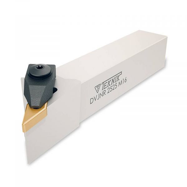

      OK I make adjustments to commercial "items" and made a few bespoke items for myself…….. BUT in the "included" items are a great selection of lathe tools, a few of which I have used to great success in making my own "things" in aluminium and brass, but what are the tools PROPERLY for?
      Does anybody know of an illustrated guide to the various lathe tools and what / how they should be used for?

            Not the best graphic I've got, but this range of knives is marked with what what they do. Using the 'correct' tool isn't exactly 'the law', for example I often get a decent finish with a roughing tool (designed to remove metal quickly), but if getting a decent finish is bothersome I'd try another shape.
            Likewise, boring bars, normally used for internal cuts can be used upside down with the lathe in reverse for facing. Parting off blades are used for grooves as well as separating. Threading tools have to be angled for the thread being cut, Whitworth is 55°, BA 47½°, and almost everything else 60°.
            If you can post photos as described here we can tell you what you've got. Sparey's The Amateur's Lathe is my favourite book despite being written before Carbide Inserts and DROs.

              Right and Left tools are the opposite to above.
              Jim

                          #494420
                            Posted by jimmy b on 05/09/2020 16:42:34:
                            Jim
                            It's true, but in my defence no wonder beginners are disorientated:
                            and
                            Top picture, a LH knife cuts to the right. Bottom picture, a LH knife cuts to the left.
                            However the convention is as pointed out by Jim and Brian, first picture in this post and like this insert holder, where DVJNR is the right hand version, and DVJNL the left.
                            Sorry for the confusion: the picture in my first post has labelled the RH and LH knives the wrong way round! But watch out buying those pre-shaped HSS knives, where Type 1 and Type 2 may mislead…

                              Probably not of immediate importance to the OP but the external threading tools shown have the cutting points in the centre of the shank, in practice they are better on the left hand side to allow threads to be cut closer to a shoulder.
