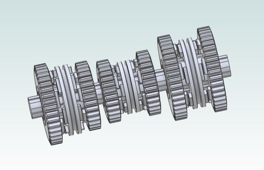

              Yep. Far too hot to work in the garage today, so I've spent a while working on the internals of a 5-speed transaxle gearbox – my next project. So far, I've just about finalised the general layout and drawn up the mainshaft gear clusters assembly in Alibre Atom. For scale, the far right gear pair ( 1st and reverse ) are both 63mm diameter and the ( dummy ) shaft is 150mm long
              Next step – the input shaft and associated gears and then the revese gear idler set-up.
              Right now, I'm going to let my brain cool down.

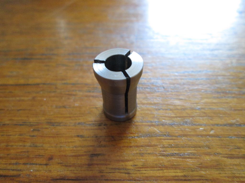

                  Bloke from Carriage and Wagon dept. asked about router collets cos one of his had broken up. Couldn't find anything quite the same on the web (.250" bore x 16.75 mm OAL), so made him this outa silver steel:-
                  Didn't harden it because the previous had broken up where the petals join the base ring, and I thought silver steel's probably tough enough as bought and it'd be silly to risk embrittlement.
                  Rookie error in 3 o'clock slot where I did my mental arithmetic wrong in getting the slitting saw on centre – spotted and corrected it before any real harm done. Seems to work, but will await user comment.
